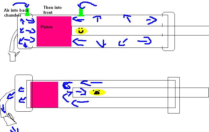

I started a piston pneumatic today- needs some help
4 inch chamber with 3/4 inner barrel- that a good ratio?
sum1 can try this out for me for sealing ideas, great value brand peanut butter jars fit in 4' barrel and leave about | | , do you think that with a few giant O rings around it it would make a good seal, i also have some high-grade silicon spray I could use on the O rings and inside of chamber together, for good lubrication, I think.
try to upload a pic tell me if design works
[img]http://h1.ripway.com/phire07/Pistonsytsme.JPG
if anyone can translate my tarible grammr plz do thx[/img]
my 2 valve piston
my 2 valve piston
Piston sytsme.JPG (35.51 KiB) Viewed 1925 times

Yep, as long as the pilot is filled before the chamber it will seal and hold properly til fired.
Some might say a one way valve or a equalisation hole is less fiddly but your plan will work.

this was kinda a prototype from stuff laying around, i didnt happen to have a 4-3/4' reducer so i got a 4 in cap and hand carved a perfect hole that i had to grease and get sum1one to help me screw the barrel into it. and after i put the glue around the inside i think it should hold real well

You're going to put O-Rings on a peanut butter jar? I doubt the jar is thick enough. A sanded down 3" end cap will work, but if the gap is that big I wouldn't use it.
4" chamber, 3/4" barrel, ratio = crap.
Unless your barrel is 50' long, you're wasting a lot of air.
Use at least a 1.5" barrel for a 4" chamber.
For a 3/4" barrel, a 2" chamber will do fine. Deodorant cans fit perfectly in 2" pipe, so it would be a easy build but get very similar power to the 4" cannon.

I tested out the o-rings on the jar because i thought the exact thing.
i got them off of sum oil filters about 5 minutes ago and put 4 down the length of the jar, itbent a bit on one side so I filled it with some magical great stuff and it puffed back up. Some blue grease in the chamber and its a perfect fit and moves with just a slight push. I like the 4" chamber and 3/4 barrel, makes close to 3-1 ratio which i use on alot of my things. and Ill probly invent sum special new barrel changing device for 2" 1.5 1 ect. and i promise ill sell it to you for your soul and some chips.

Ok I tried to help you man but if you feel like spending 20minutes to fill the chamber up with a bike pump, or use up a whole compressor tank to only reach 50psi, be my guest, but a 2" chamber will give you the same results, save you heaps of cash, be more portable and look heaps better.
Good luck with the interchangeable barrels too, it's been done before though. Not exactly that difficult, maybe for you, maybe not.
