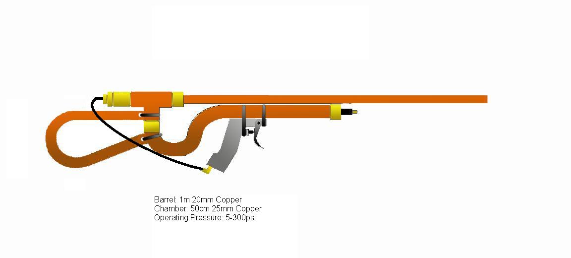

I myself have been inspired by Chaos' S400 and the SSS. I also plan to use copper but I'm going to be using compression fittings aswell as brass fittings on the valve.
This is the overall look of the gun I hope to achieve. As much as I love Chaos's gun, I hate copying at all so I've given his design my own touch for what I think will suit me best.
Anyway back to your question, a shock pump will absolutely kill your arms if your planning something at the same scale as his. He has a mightly large air chamber so you might have to use what you have (eg a bike pump, compressor) or upgrade to making a high pressure pump or buying a commercial high pressure 260psi floor pump. I'm not overly sure about soldering, hence why I've gone with comp fittings. If you have the tools, soldering is a top way to go so best of luck with your build.
Hope this is some help to you.
I plan to get 1/4 copper pipe and run that around so it's flush to gun from the piston valve to the blowgun, this picture does not show it.

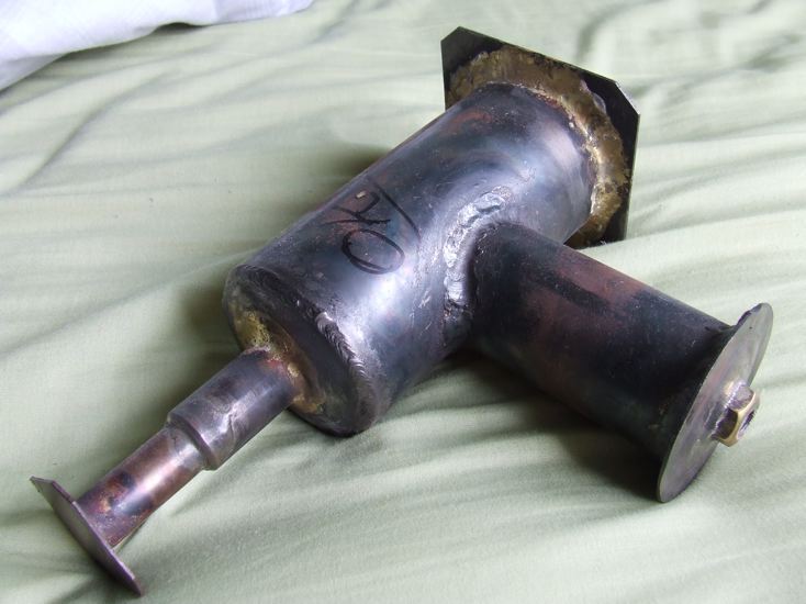

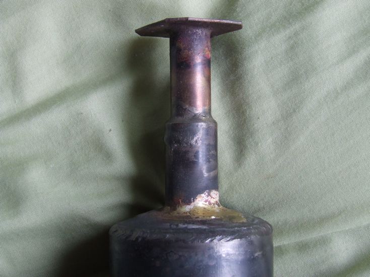

I made this test piece in a metalwork class. It is a few pipes welded/brazed together in various ways. The main body is just normal steel pipe, with a seam. The end bits on the wide pipe are just steel plate which has been butt welded, with a mixture of brass brazing and the others just melted steel/filler rod. One has a brass nut brazed onto the outside with Silfos, which is a faily low temp brazing product for brass and copper ( cant remember exactly which is used cus made it a while back) Up the top there is a copper pipe with a piece of flat copper butt brazed to the end of it, not a cap, just a flat piece of copper. It was dones with silfos, or silver solder, one of them lol.
Anyway, the thing was filled with water and a pump attaced to the brass nut. It was then pumped up to 1800psi, which is pretty high, the flat plates that were butt welded on all bowed out because of the pressure, but the thing held. Only had one tiny pinhole leak. Im not sure it it would be the same as with air, but I dont see why not. If done correctly, brazing/soldering creates a very strong joint. This was all done with a oxy acet torch.
