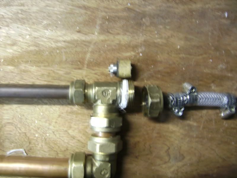

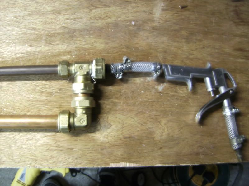

Hey guys, ive been reading up here with a few months and decided to build a copper piston gun, i used a 3/4 3/4 1/2 tee for the piston holder and in using a blow gun for the trigger, also a 3/4 pipe for the cylinder.
Im a little short on fittings so what ive done is put a shrader valve on to a 3/4 blank for the fill/trigger and piped this onto the blow gun which has another shrader valve at the other end. Both of the valves on these shraders have been removed.
For the piston ive used a wooden dowel which fits perfectly in the 3/4 pipe, it has some rubber from a bike tube screwed on with a washer.
Originally i did not have the straight placed behind the tee but i felt it was needed to try get a better suction on the piston when firing the blow gun.
My problem is, it fills with air fine but when i use the blow gun it just leaks out all of th air and does not move the piston (which moves quite freely when not under pressure)

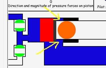

Your piston face needs to be larger than the barrel.
This link should clear things up a bit. Notice how the size of the piston in relation to the barrel is? That's what needs to happen in yours. Oh, and it probably wouldn't hurt to cut your pilot volume a bit.

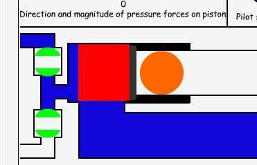

Oh rite, i see where im going wrong now, this is what i need...
And this is what ive got....
So i need to run the barrel further into the tee, only problem now is the lip on my fitting that stops the pipe entering the tee.
I suppose if i grind this down and get the pipe into the tee,i should be sorted?? Cheers lads

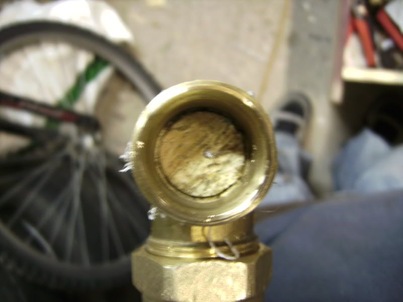

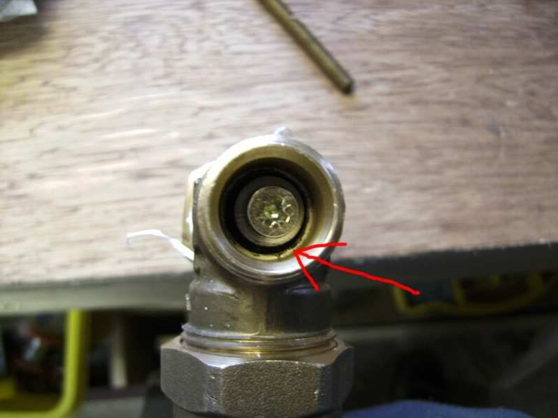

Ok i just went out and modified it but still no good?? i ran the 1/2 inch into the middle of the tee, cut down the piston size and still no good. it holds pressure fine but just leaks the whole lot out of the blow gun when fired, i can hear it open just at the very end of the blow guns exhausting.
The piston is not 100% sealed around the pilot area as its just wood on brass but i dident think this was necessary,

Get a 1" x 1" x 1" tee and put a reducer bushing in it (1" x 1/2" to keep the same barrel). File out the bushing so that the 1/2" barrel slides through it. Fix it to the center of the new tee (like you have it now).Then, make a new piston that is bigger than the one you have.
There is still just not enough space between the tee walls and that barrel.

More air is leaking past your piston than your pilot can flow.
Minimize leakage past the piston (a wrap of tape)
Minimize pilot volume.
Maximize pilot flow. (remove restrictions)
