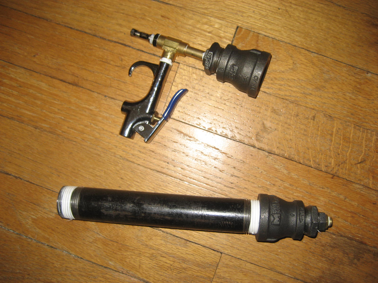

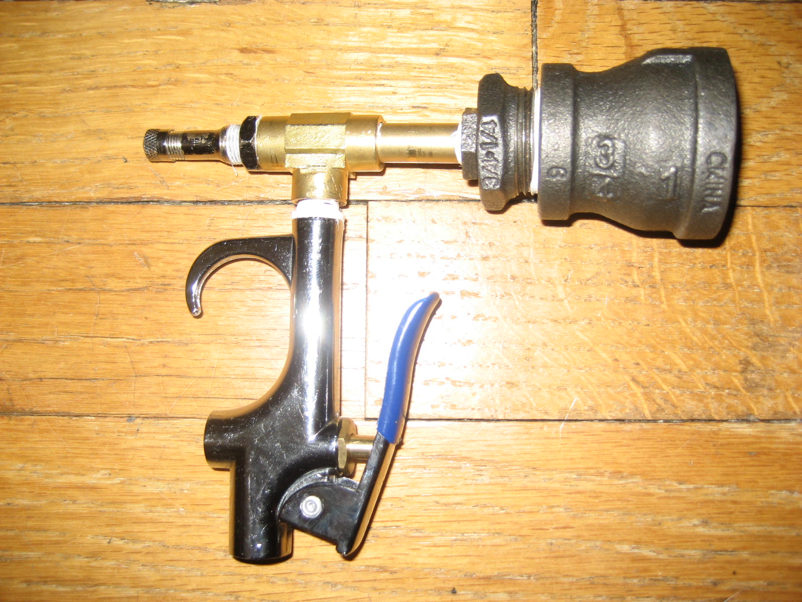

I'm not typically the type to ask for help, but well, I need some. I just made the main construction of my first piston cannon about a week ago now. Since then, I've been tinkering around with materials but have never found something that works.
Specs:
-Chamber is made of black metal
-Chamber is 1'
-Barrel is 1/8"
Any help would be appreciated, and as always, thanks for the help.

Well, I've tried rubber cork, wood, types of plastic caps. And yes, I do need help with what materials I need to use.

I've tried all of that, I just need some kind of material that would work.

Well, all I know is that it is supposed to be a barrel sealing piston. And yes, i'm sure it's leaking. When I even fill this with air, it just leaks out the barrel.
