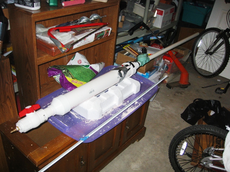

This is BTL Industries' first pneumatic cannon, the CA1 SMSS. It isn't built to do any specific thing, except begin my experience with pneumatic launchers. I will be using a similar classification system for each of my cannons and cannon subsystems (no matter how primitive or insignificant).
Name: CA1 SMSS (Cannon Assembly Mk.1, Single-shot, Muzzle-loading, Stock Sprinkler valve)
Type: Man Portable Pneumatic Cannon
Loading Method: Muzzle Loading w/ ramrod
Barrel Type: 1" by 3.5' sch40
Chamber Type: 3" by 2' sch40
Operating Pressure: 15-70psi (Electric) 15-100psi (Manual)
Fire-Control Sys: FA-E1 NCS
Ammunition: 1in rubber ball and/or small diameter paint roller
# of Valves: 1
Type of Valves: Stock Orbit Watermaster 1in Sprinkler, Solvent connectors
Sights: None
Projected Improvements: Improved electronics OR Blowgun modification to valve. Also, properly secure FA-E1 or later system, instead of using duct-tape. All unlikely to be done.
By no means is the CA1 a well designed cannon. The only really remarkable thing about it, is that almost none of the purple primer is visible, and its construction is fairly solid. Its barrel and tank dimensions were chosen on the fly, and none of it was put down on paper. It's control system couldn't be simpler. The FA-E1 NCS, due to being rushed to completion to be fitted to the prototype of the CA1, lacks a toggle safety, and only houses a push-button control and a single 9v battery. However, this is not much of a problem, due to the test constraints of the targets and backstop used during testing. Shortcomings aside, the CA1 SMSS can be considered a design success, because it did in fact manage to achieve the original goals of its design, which was to increase BTL Industries' knowledge and skill in the design and construction of pneumatic cannons.

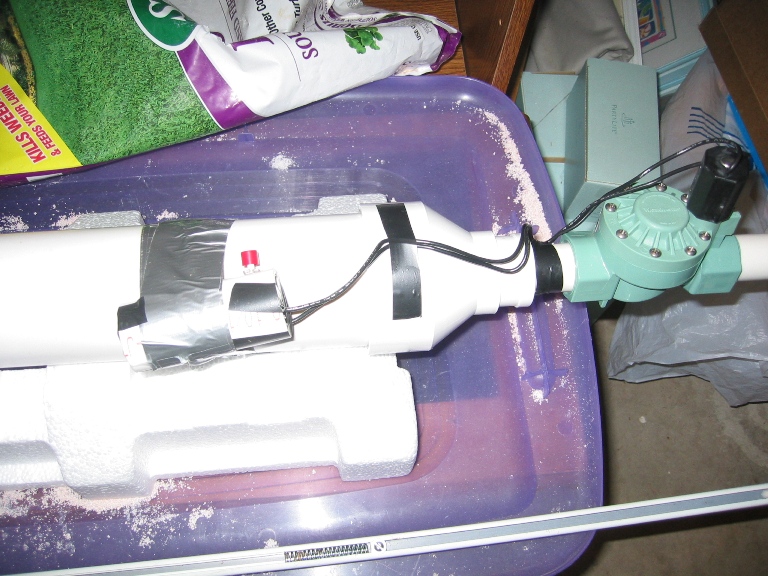

Here is the specification for the FA-E1 NCS used on the CA1 SMSS. It's purely for archival and documentary purposes. When you look at the actual system, this actually seems kind of pointless.
Name: FA-E1 NCS (Fire Actuator- Electronic Mk.1 Non-adjustable Control System)
Type: Electronic Valve Actuator
Type of Supported Valves: Stock Sprinkler Valve
# of Supported Valves: 1
User Interface: One(1) Momentary Pushbutton Switch
Energy Output: 9V D/C
Power Source: 1 9v-Type Battery
Operating Constraints: Up to 75psi (Valve Dependant), Not Waterproof
The FA-E1 NCS is the first Fire-Control system built by BTL Industries. Originally designed to operate using two 9v batteries and to have an SPST toggle safety, after a number of design compromises and the need to be finished in order to be used on the CA1, the FA-E1 NCS dropped the second battery and safety switch. In the rush to complete the CA1, the FA-E1 was duct-taped to the chamber instead of being properly attached. It is unlikely that the FA-E1 will be used again in it's current iteration.

WHOA DWV man scrap that cannon right now go get you some pressurerated fittings now. And why did you youse that whole ballvalve setup just to fill your cannon. Other than the DWV its an okay cannon.
Coodude26 wrote:
- Corporal 3
- Posts: 734
- Location: Texas
No, it's all NSF-pw. I just went out and checked.Maniac wrote:WHOA DWV man scrap that cannon right now go get you some pressurerated fittings now. And why did you youse that whole ballvalve setup just to fill your cannon. Other than the DWV its an okay cannon.
Anyway, the ball valve is so it can be carried independently from the compressor.
The bell reducer is DWV(drain waste vent), which means it is not meant for any pressure.

Yeah, it's a quick-connect.brplatz wrote:DWV is the bell reducers
Ball valve still doesnt make sense
EDIT: It isnt a schrader, its a quick connect right?

I get ALL of my equipment (minus the buttons and other electronics) from Home Depot. And everything I get is pressure-rated. I actually used to lurk on spudtech about a year back, I already know a thing or two about pneumatics.brplatz wrote:ok that makes sense now
still bell reducers are rarely pressure rated, unless you got them online, Home Depot and Lowes where i live only have pressure rated fittings up to 2 in
The spudwiki page about DWV actually confirms that, even if the bells were DWV, my cannon would still be safe. I never operate it above 65 because I only have a 3 gallon compressor and it takes forever to fill the cannon to anything higher. Also, above 70, the solenoid lacks sufficient power to operate. But, that doesn't matter, because they ARE pressure rated.daxspudder wrote:Well you certainly seem to have an adequate knowledge of electronics(use of the single pole-single throw SPST term I havent seen in years, among other things), but I think you should research pneumatic cannons a little more before you fire yours ever again. For the best info read the thread in the link in manic's signature, youll soon find that your cannon is an explosion waiting to happen, and not the good way...

I would have to back his claim his bell reducers are possibly PR... Mine in my combustion were purchased at a home depot, and are 280psi rated sch40 bell reducers, both the 4-3 and the 3-2. Rare, but they do exist. worth double checking yours, I had bought one for a 2-1.5 barrel and after making the barrel, later at the store discovered I had bought unrated DWV.... I still use it but my middle name is danger...
"<I>For dare to be peace, I have to keep at it everyday, da Man doesn't take days off so neither can I</I>" -<B>Bob Marley</B>, day before a performance, a day after being shot in the chest. "<I>If you are the big, big tree, we are the small axe, ready to cut you down!</I>" -Bob again :brave:
Guys bell reducer doesn't always mean not pressure rated. I have a pressure rated one, ask before you yell please. The ballvalve is becasue some quick connects don't have one way valves in both parts, so now he can make it portable. Man guys, don't be so critical about things you don;t fully understand.

Yes, thats EXACTLY what I'm using! 3" to 2" reducer. It goes to a 2" to 1" bushing then to the valve.daxspudder wrote:I would have to back his claim his bell reducers are possibly PR... Mine in my combustion were purchased at a home depot, and are 280psi rated sch40 bell reducers, both the 4-3 and the 3-2. Rare, but they do exist. worth double checking yours, I had bought one for a 2-1.5 barrel and after making the barrel, later at the store discovered I had bought unrated DWV.... I still use it but my middle name is danger...

Re. the DWV, replace those bell reducers with a coupling and reducer bushing setup...everything else is fine.
I noticed you looking down the barrel of that thing with the chamber full of air a couple of times...
Please don't do that again.....
I assume you know by now that a pneumatic mod on your sprinkler will provide better actuation performance....however that would make your Electronic Mk.1 Non-adjustable Control System obsolete.
Decent effort for your first. However, if you want to keep actually shooting it, do the reducer mod.

Actually, the cannon isn't charged any of the times i look down the barrel.starman wrote:Re. the DWV, replace those bell reducers with a coupling and reducer bushing setup...everything else is fine.
I noticed you looking down the barrel of that thing with the chamber full of air a couple of times...Please don't do that again.....

To mod the valve with out ruining it, remove the solenoid, fill the small center hole, and find pieces that will thread between the valve and a blowgun, not as fast as the traditional way, but you could bore out the little hole that leads from the pilot volume to the solenoid release...
