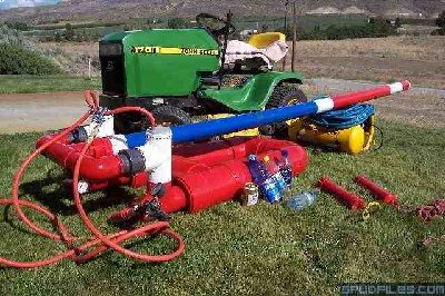

The WaterDawg, my new cannon, now has a beautiful, sharp looking coat of paint and is going to appear shortly for an interview working for the Okanogan County Search & Rescue in the county where I live.
The power, accuracy and distances I can achieve make this one of the funnest things I've done.
However, using it for life saving brings credit on all of us.
I am also working with The US Forest Service to pursue possible applications in forest re-seeding in extremely rough terrrain.
Provided By - Chuck</div>

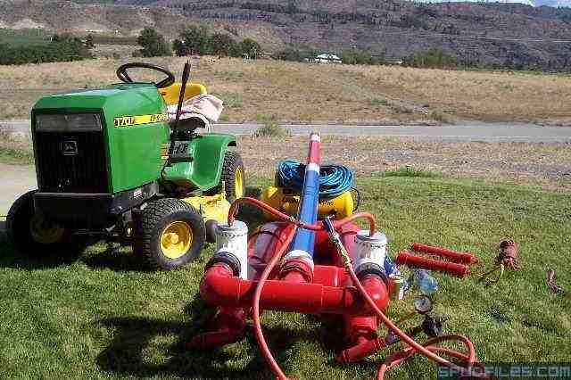

Some of my favorite projectiles in the foreground.<br /><br />The two red slugs are the line throwing projectiles. PVC pipe is filled with clean gravel. The barrel is 10' long. 7.5' of 6&amp;quot; chamber.
The two red slugs are the line throwing projectiles. PVC pipe is filled with clean gravel. The barrel is 10' long. 7.5' of 6&quot; chamber.

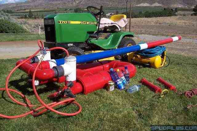

Here the range out of my house.<br /><br />There is a white pile of rock above the barrel. A bridge is in front of the rock pile.<br /><br />It is exactly 1/2 mile from the street in front of my cannon to the<br /><br />bridge. It's reachable with golf balls.<br /><br />The bottles make the river about 400 yards away at the green tree line.

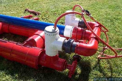

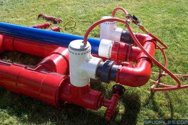

Up close shot of the manifold.<br /><br />My old manifold was 3&amp;quot;. This is 2.5&amp;quot; All of the projectiles would fit down thru the barrel coupling on the old manifold. This caused a fracture when the outgoing projectile hooked on the coupling and blew everything all to hell.<br /><br />With the 2.5&amp;quot; manifold, nothing gets past. I like it much better. I think the dead space is reduced. This cannon is awesome.
My old manifold was 3&quot;. This is 2.5&quot; All of the projectiles would fit down thru the barrel coupling on the old manifold. This caused a fracture when the outgoing projectile hooked on the coupling and blew everything all to hell.
With the 2.5&quot; manifold, nothing gets past. I like it much better. I think the dead space is reduced. This cannon is awesome.

The design of the cannon was to use the shape for trunions for angling up and down. (I have yet to build a holder as the gun is fairly easy to aim....even straight up!) Also, the tees and 90's add to the cost but also add cubic inches and keep the thing contained in a smaller package.
The barrel unscrews. A down side to the design is lack of a natural support for the barrel. I used a a short piece of PVC pipe cut to fit the 6" chamber and shaped to fit the 3" scd 80 barrel and with a strap wratchet it fit so tight nothing moves and it can easily be lifted by the barrel and the manifold.

A couple things. Could you port the openings of the supah valves and use bigger tubing to make it fire faster? Like instead of using what apears to be 1/4 tubing, you could drill and tap them to 1/2? Then set it up to release using a modded sprinkler valve?
Also, is there any way to eliminate that 180 turn from the outlet of the valves to the barrel? Like turning both supahs in 90 degrees and be able to get rid of those elbows feeding into the barrel? Basicly have the supah valves feed directly into the 3 way the barrel is connected to.
Also, could you use the 3 inch manifold, but just put a little pin to prevent things from going through?

1. this topic is 6 months old.
2. that person dosn't even brose this forum
3. you can port the spuah but it wouldn't help
4. if the manifold was bigger there is more dead space to reduce the performance
