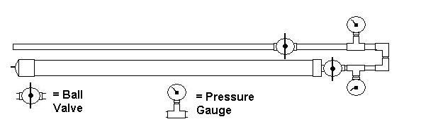

I haven't tried to make a multi-shot cannon before, and i have some questions.
First off, would this design work? I would close the valve to the barrel, opent the valve to the main air champer, and pressurize the "dead space" Then close the valve to the air chamber and fire by opening the valve to the barrel.
Second, do I need a pressure gauge on both chambers or just one? If just one, which one?
Here's a diagram

The design will work, but probably won't have very much power since it uses a ball valve as a main firing valve.
You only need one pressure gauge, and it could be in either location, since the pressure will equalize and be the same in both chambers.

You should change the ball valve by the barrel to a sprinkler or change the design a little to allow for a piston or qev.

In the drawing, both gauges will always read the same thing.
I think you meant to switch the position of the lower gauge and lower ball valve. One gauge reads the main chamber and one reads the working chamber.
Like potatoflinger said, no need for two valves, regardless of where you locate them. One valve on the main resevoir is all you need.

jimmy101 wrote:Like potatoflinger said, no need for two valves, regardless of where you locate them. One valve on the main resevoir is all you need.
You do mean pressure gauges?

The second gauge is a little redundant but it might be nice to know if you had a charged shooting chamber or not, independant of tank pressure.
Also you'll need to be sure to always remember to close the tank valve before shooting.
For a real multishot, go for a High Pressure tank and regulator. Everything else can stay the same if you keep shooting pressures reasonable.

After each shot, you're going to loose power. You see, as pressure equalizes in both chambers after a shot, the pressure is going to be slightly smaller each time. That is, unless, you hook it constantly to a compressor or air source.
As far as the gauge goes, I'd leave it on the main chamber. That way you will be able to read it with the valve open or closed.
ooops
Like potatoflinger said, no need for two gauges, regardless of where you locate them. One gauge on the main resevoir is all you need.
