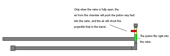

I read the 'piston valve explained visually' and i didn't understand
it so much, so i build plans for my first piston valve, so please
tell me if the piston in the plans will work good..
look at the piston.
look at the piston.
basic piston.. (I think).PNG (4.49 KiB) Viewed 3674 times

there are better ways... give my your email address and ills end you an email with an attached diagram

It might work, but frankly, there isn't enough detail in the drawing to tell. You might be better off with a co-axial design. It's the simplest iteration of a piston gun, and it is still powerful and compact.

Interesting take on the piston valve design, if I understood it correctly then the ball valve is physically holding the piston in place and when it's fully opened, the piston goes through the valve.
It should work and work better in terms of opening speed than normal pistons because the pilot volume pressure is effectively zero, so piston acceleration is much more rapid. This means that you also need some form of spring and bumper to ensure your piston doesn't shoot out of the end cap.
The major "complication" I can see with this design is that the piston needs to be 100% airtight, so o-rings are a must.

Also, it might sound a little obvious but do check that your ball valve will allow the piston through, a 3/4" ball valve doesn't necessarily have a 3/4" opening.
It reminds me of one of my own projects in that the piston is held shut by mechanical means, not by pressure difference, though the latter does open it.
Another variation would be a take on this "valveless" design, where the ball valve would be between the projectile and the chamber, and the projectile would in effect be the "valve" holding the air as all the ball valve would be doing is preventing it from moving down the barrel.
