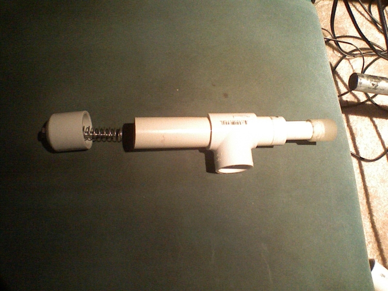

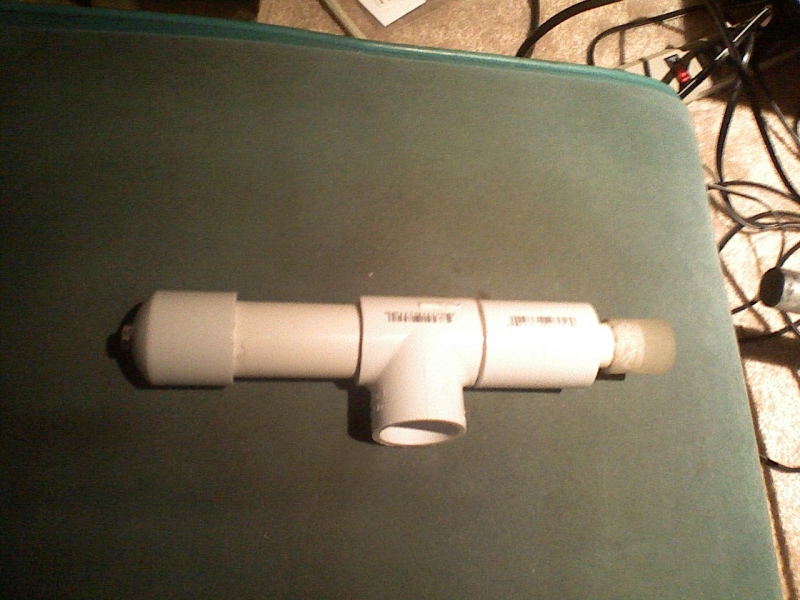

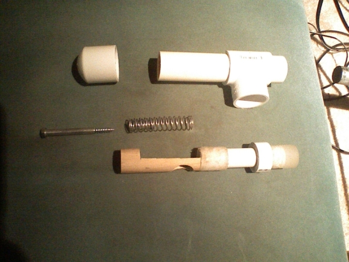

......Construction has begun on the prototype and things are looking promising. :o
The mechanism seems to work pretty flawlessly when operated by hand. Feeds marbles just as designed. However, I attached it to the gun for a couple test firings and I may have underestimated the force of the air pushing the bolt forward(I think I'm going to need some stronger springs) :shock: I was only testing it at around 20-30 psi and the whole thing feels like it is getting slammed forward so hard that I would be afraid to go any higher. That would make for a pretty lousy gun if you were only shooting it at 30 psi:(
Any suggestions on how to dampen the bolt more effectively? Plus, the bolt only has a travel of about 1 1/2" max. Does that sound like enough or should I give it more travel, because my fear of the bolt not moving far enough forward to pick up another marble is obviously not the issue...
I'll try to get a video up this weekend so everyone can see that it does work(just needs some tweaking)
the components- the bolt, housing and springs
Putting it together
Putting it together
fully assembled
fully assembled
