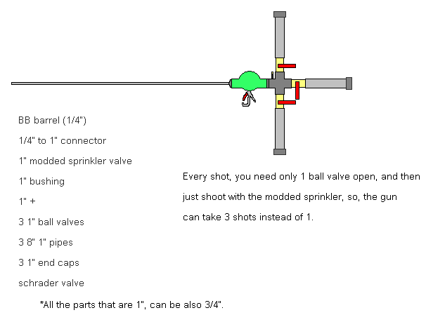

I got an idea for a good 3-shot bb sniper rifle:
Well?
The plans.
The plans.
3-shot sniper rifle.PNG (11.15 KiB) Viewed 4572 times

It will certainly work...probably isn't very practical. All that extra plumbing for just 2 extra portable BB shots?

starman wrote:It will certainly work...probably isn't very practical. All that extra plumbing for just 2 extra portable BB shots?
It'll be more useful for airsoft matches. 8)

Well if I'm not mistaken most guns in airsoft matches are semi-auto or automatic with atleast 12 round clips. So a 3 shot gun won't do much good. I also think the 1" sprinkler valve is a little overkill for a bb gun. JSR proved that a blowgun can be used as a main valve in an airsoft gun. Or you could just use a ball valve. If you want to use a homemade gun in an airsoft match make an inline vortex or vortex cap bbmg

Agreed with the above, a blowgun trigger, simple T magazine and one sizable chamber will give you a lot more shots with good power.
HUM HUM
http://www.spudfiles.com/forums/3-shots ... 16485.html
DONT make this thing, i did the error of making it and discovered then the sprinkler valve stay open while you presurise it with one of the 3 chambers :x
