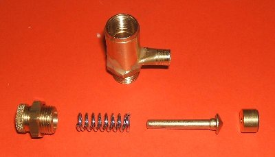

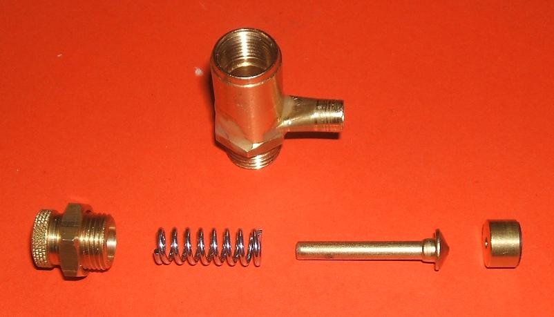

I've long been a proponent of self-made fittings, but recently spotted a couple of adjustable safety valves and decided to buy them for the heck of it to see what they could do. Long story short, I hooked one up to a blowgun attached to my compressor and after tweaking the spring tension a little:
I think it's safe to say you can expect another attempt at an auto project pretty soon :D

It exhausts from two slots, all I need to do is block off one of them and attach the other to a blow-forward breech, given the joys of epoxy casting that shouldn't be too much of a chore :)
I've never really undestood your persistence with all this constant flow thing... could you explain what are main advantages of it or how powerful gun you can buld with it??
I suppose it's carried over from starting out with cloud or vortex BBMGs, where all you need to do is inject air from a blowgun into the system et voila, full auto. While the rate of fire is obviously less, incorporating some sort of "pulse" valve into the loop will usually give you the benefit of faster opening time and more flow.
The valve has 1/4" porting so it should be perfect for a 6mm BB/pellet machinegun :)

Here's what it's looking like, one port blocked off and a flattened brass tube on the other port to feed into the breech, all that's left is to encase it in epoxy for strength and we should be good for testing in 24 hours :)

On the valve you used:
What kind of safety valve is it?
What is it normally used for?

I'm quite confident it will, it does move a lot of air - you can see the blowgun recoiling in the video - and we're talking 1/4" porting for a 6mm barrel.
The valve was purchased off eBay so is no longer listed, but it's nothing special, works just like any other pop-off only the top is threaded to allow you to adjust the spring tension. alternatively one could buy a standard pop-off with a fixed pressure and change springs.
