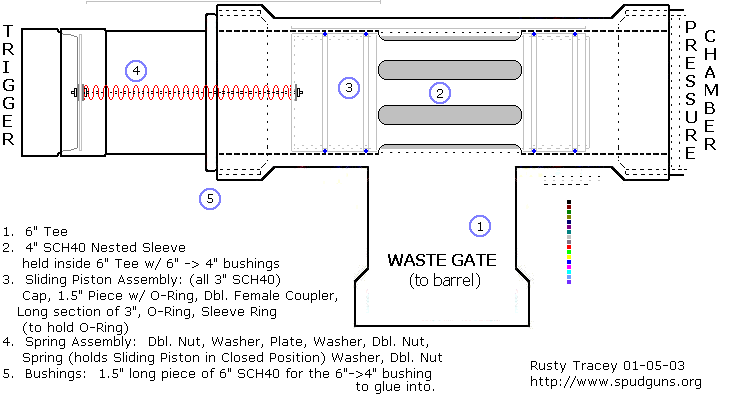

That form covers barrel sealer valves. Some piston valves have the inlet and outlet reversed. The Supah valve is one example of this. These chamber sealing valves are noted for controlled opening so they are less likely to break. The trade off is they are slower than a QEV style barrel sealer. The opening speed is completely at the mercy of the pilot valve speed and flow.
Supah style valve showing the outlet off the side and the seal against the chamber.

That forum thread has the chamber sealer as well. The only difference is it is shown as filling from the pilot side and it has a face seal vs. the o-ring seal againgst the chamber side. Its the concept.
If he just went to a store looking for a "piston" valve, he probably doesnt want to mess around with machinng o-ring grooves yet.

How do you think a chamber sealing piston valve would perform if it was released mechanically without any resistance behind it at all? No pressure equalization and the piston housing could be a strong, well vented cage. What do you think?

Jack did a barrel sealer that was released mechanically. He stated it showed improved performance over an equivalent valve but the opening time on a proper piston valve with a powerful pilot is not slow by any means.
As for chamber sealing, I'm unsure.
