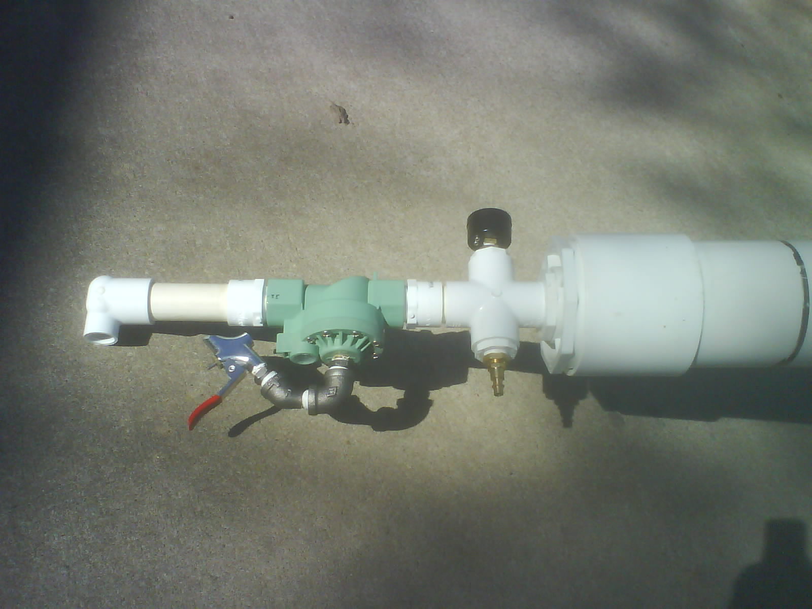

Specs:
chamber- 4" by 6'

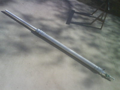

barrel- 2" by 5' (9 feet with extension)
piston- 3" cap with washer on top
pilot- modified 1" sprinkler valve
operating pressure- between 50 and 70 psi usually
length- 8' (12' with extended barrel)
The barrel disconnects at the two inch union at the front of the chamber.

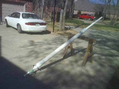

At 60 psi it shoots a mini nerf around 1/4 mile, a full tube of caulk 150 yards, and a bouncy ball 3/8 mile, through 2 sheets of 1/2 inch osb, or up into a blue sky until it disappears.
We estimate it shoots a bouncy ball between 500 and 700 fps.

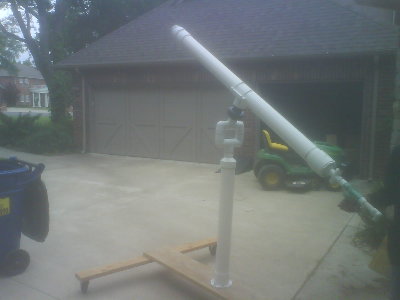

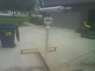

Edit: I finally got pics of the stand up. I know the size in kinda over kill but i don't want it to fall over. It has a full range of motion so i can shoot straight up if i want to. The stand comes apart so it's easier to store. both pics are without the extended barrel.
