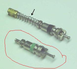

Yeh, except most aren't very serviceable.
Have a look around, you want something called "long valve stems" for schrader valves. They have an external spring which can be cut off for a 0 cracking pressure.

yer i wanted to but i have one this
http://www.geocities.com/cyqlist/springs1.jpg
the smaller one
the one thats in the red

iv got one like this

the small one .no one successes to get the spring out from it
i tried once and this dose not work with me
here a photo to see how exactly what he look inside

thanks i tried to cut one up and it didn't work ether
i only lose 70 or so psi and my pump already pumped to 400psi and i wont go passed 300 in my gun so its fine thanks for all the help guys
