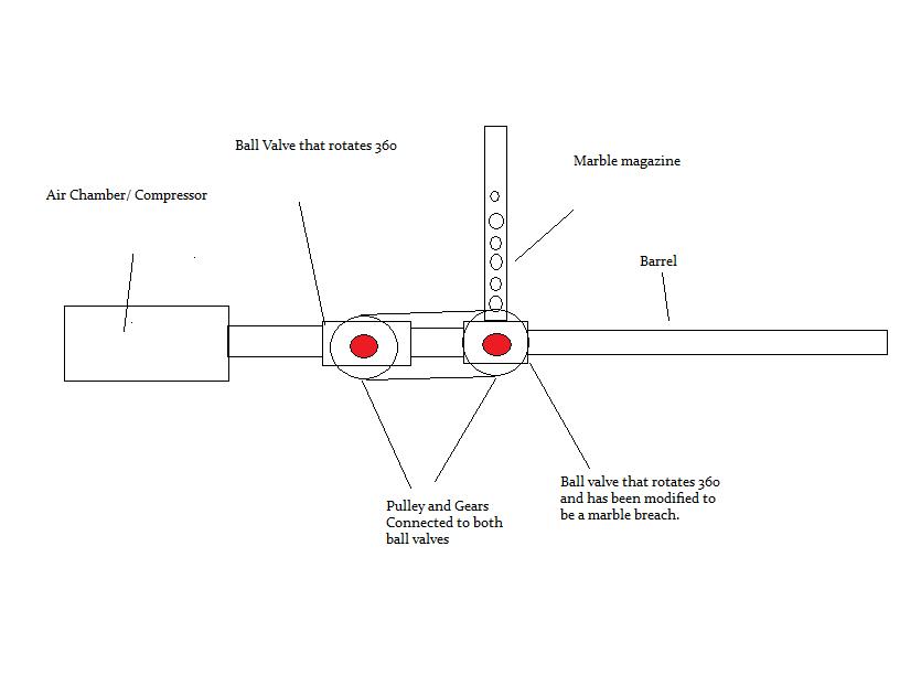

Or how bout you get 2 ball valves, modify them so they can spin a full 360 then make one load marbles like JSR said, and have the other one linked with gears so you have simple cycling full auto. The first one provides a burst of air synchronized with the second ones loading.

You would need more force to spin the valves than the small volume would generate to push the projectile....
But hey..if you feel like trying it...

I hate to rain on the parade of great ideas, but I was playing with it for a bubble gum ball machine gun. The biggest problem is the fact the ball valve does not seal the magazine before opening to the chamber. When the ball valve is not at one position or the other (load/fire) it is open to both. This lets the chamber pressure escape out the magazine and prevents loading.
I like the idea, but it needs work to deal with the geometry of the ball valve at angles other than 90 or 0 degrees of turn. :( Solving the flow path opened at 45 degrees is going to be difficult.

Are you jesting by referring to it as a "Leak"? I can thread clothsline through the valve from the magazine, loop through the barrel and back into the chamber with the valve at 45 degrees. It's open both ways.

the pressure chamber valve will close before the magazine block valve opens.
The projectile would block flow until inline with barrel.(maybe that's cause for misinterpretation(???))
So, I don't understand the confusion(?)
I've never built one, nor have much interest in doing so.
But when thought out, it's only flaw IMO is that the left over pressure, after proj. exits (trapped in BV) will inevitably dump into mag.
If I'm wrong I'll admit it this time Tech... :wink: 8)
