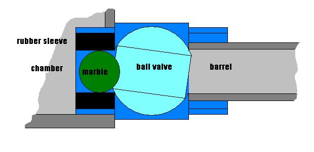

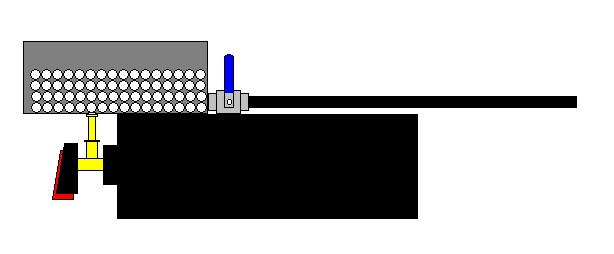

I had proposed something similar to Brian back on spudtech while discussing an efficient design for a marble machinegun, it's basically a variation of the "valveless" idea where the ball valve replaces the detent:
- mmgdetail.JPG (18.34 KiB) Viewed 4792 times
- MMG.JPG (13 KiB) Viewed 4792 times

@jackssmirkingrevenge
mmgdetail.JPG is similar to my idea, except the projectile would be inside the ball itself. This would remove one point of friction on launch.
