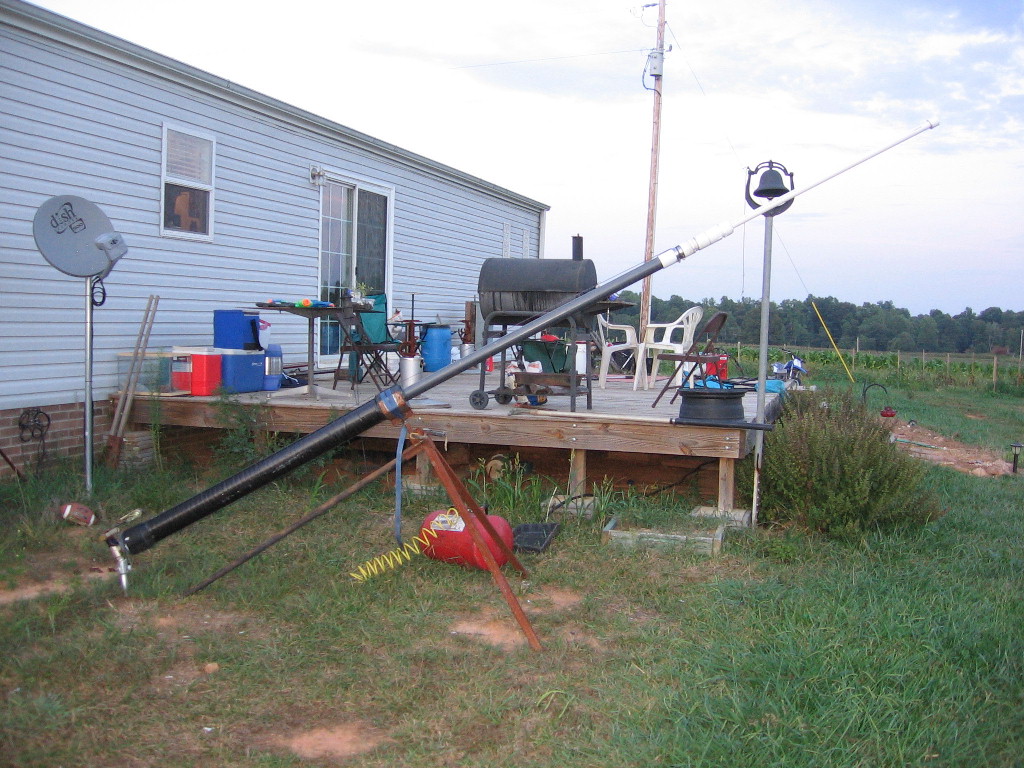

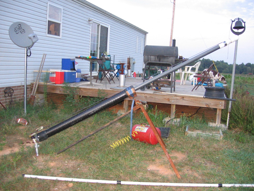

The Decimater...  Possibly SoS, but definitely the hardest hitter in my collection...

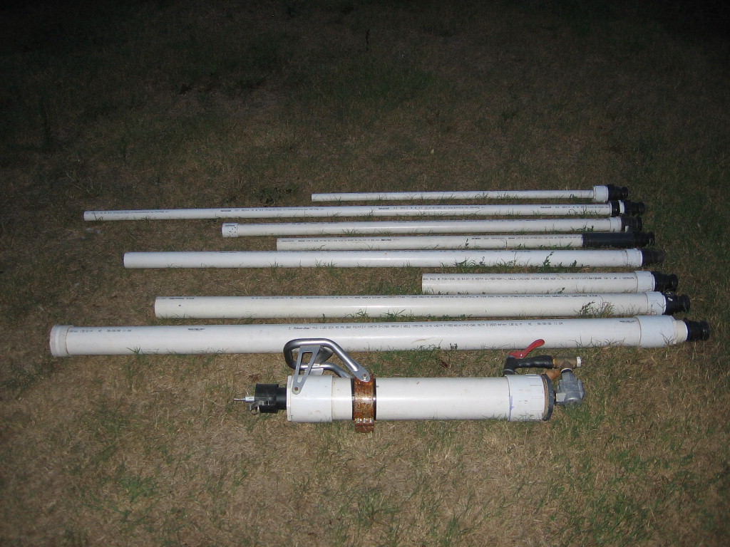

modgun(modular gun) with interchangeable barrels.<br />barrels from top to bottom: 1&amp;quot;, 1.25&amp;quot;, 1.5&amp;quot;, 1.7&amp;quot;GB, 2&amp;quot;, short 2.5&amp;quot; TB, long 2.5&amp;quot; TB, and 3&amp;quot; barrel.
barrels from top to bottom: 1&quot;, 1.25&quot;, 1.5&quot;, 1.7&quot;GB, 2&quot;, short 2.5&quot; TB, long 2.5&quot; TB, and 3&quot; barrel.

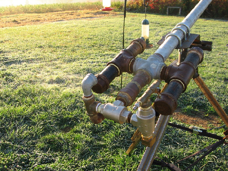

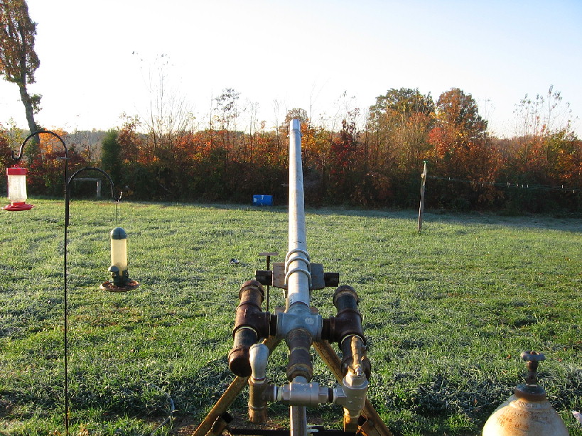

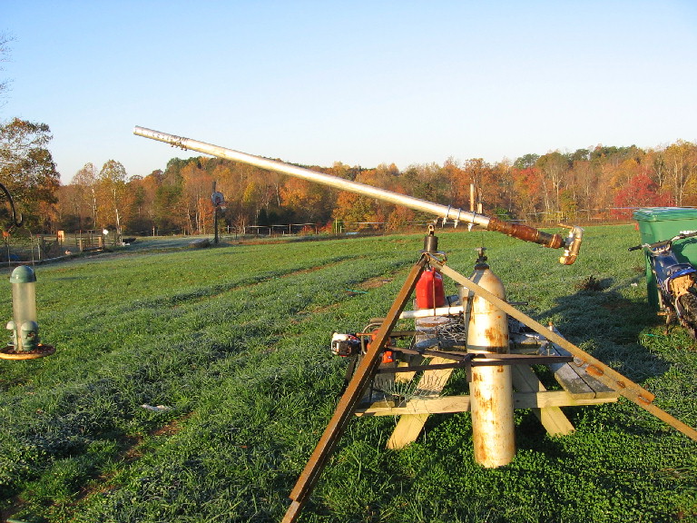

Here's some pics of Decimater with sleeved barrel, muzzle BRAKE, and new fire control layout...
The Ghetto Brake mount is gonna be replaced with set screws...
Can you tell I like Tripods under BIG GUNS???  This tripod puts the gun pivot at about chest level for ease of aiming and firing...
Quite Impressive I think....
Yeah, i know, overkill with a 1/4bvpiloting a 3/4QEV piloting a 3/4QEV piloting a 1.5&amp;quot; piston, but at least I can look straight down the barrel now... And it's FAST!!!
Yeah, i know, overkill with a 1/4bvpiloting a 3/4QEV piloting a 3/4QEV piloting a 1.5&quot; piston, but at least I can look straight down the barrel now... And it's FAST!!!
Do I get Ghetto Points????  It is actually quite effective in comboination with the overall weight of the gun...

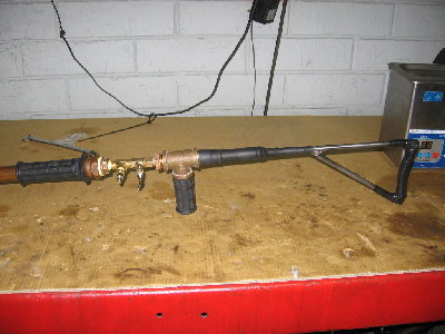

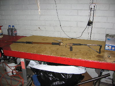

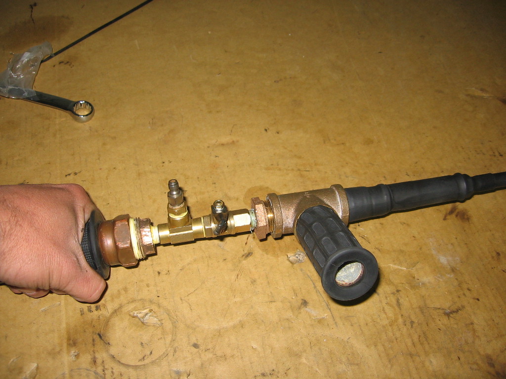

And while I'm updating this collection thread, here's a coupla pics of the new firing control/vent/stock setup I put on the copper cane posted in the OP...
Full port BV venting the coax's pilot volume through the 3/4" Tee/3"nipple handle, the rear leg of the the tee has the homemade stock... ergos are just about perfect for me, and no NOTICED loss of performance from switching from qev/blowgun to bv, prolly because the pilot volume shrunk with this layout, and pulling the "trigger" is prolly less than 1lb of pull required... Next nice day I'll get some vid's of firing it...
Showing the exhaust port(through the handle)...
showing fill/fire control closeup...
overall gun length is 5ft...
