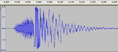

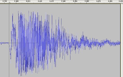

To find the performance issues, you will need to find the parameters of the materials you are working with. As far as the pony tank, the volume is fine. Simple math will show that 3 L of air at 6 bar or more will expand to completely void a golf ball barrel under pressure.
The focus on performance should move to the plumbing between the pony tank and barrel. A factor is many of these launchers is simply how air behaves at near sonic speeds. Any type of bend, edge, restriction, etc and you have a choke point that limits the flow to sonic speeds. Add a couple of these in a row and each one progressively lowers the pressure. Soon you may be delivering air through an elbow into the barrel at nearly sonic speed, but at no pressure. This compresses some in the barrel and backs up behind the golf ball.
The goal should be to deliver air under pressure into the barrel behind the golf ball where it under pressure expands in the barrel. In theory, golf ball launches near sonic speeds are possible.
The first things to look at are the controllable parameters. Are there any bends between the pony tank and barrel? How long is the path? In counting bends, count the interior of the valve.
Second thing to look for is any restrictions to flow. What is the ID of the barrel? What is the ID of all restrictions between the pony tank and barrel. Count everything from the neck of the pony tank, through any pipe, through any valve seats, to the barrel. Can anything be improved?
Third thing to evaluate is the speed of the valve. Vaves have a finite opening speed. If the valve is so slow the golf ball has left the barrel while the valve only made it 1/4 the way open, the above list of restrictions includes the restriction of a partially open valve.
To evaluate your flow, take the launcher out onto a field (to eliminate echos, remove the barrel and record the sound of the launcher. The time of the discharge can be measured by the duration of the high pressure hiss. This will give an overall duration to vent the pony tank out through the plumbing. Shorter is better. A short bang is much better than a long hiss.
Use the free software program Audacity to analyze the recording of the cannon. It can expand the waveform so you can accurately measure the pressure decay.

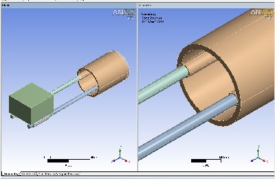

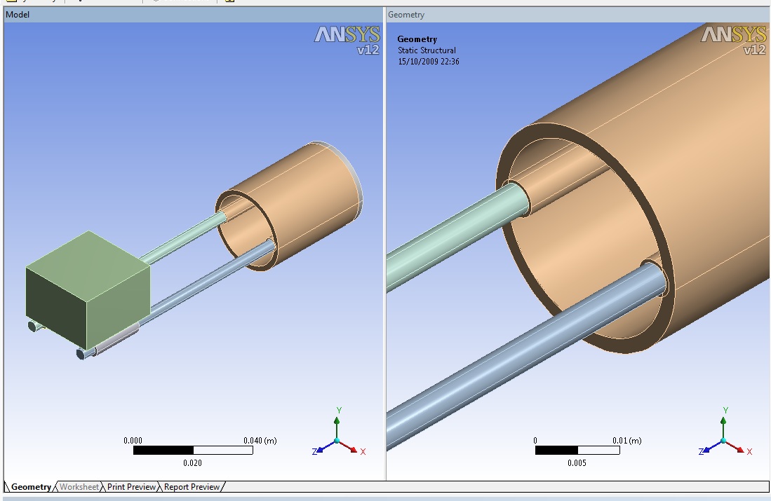

Firstly thanks guys for the quick and detailed response!
I will post pics of the setup tomorrow when i get back to uni...

Generally...One area I've really been struggling with in the QEV dept. is how to get a pilot air line going. I need to be able to fire this thing remotely; and for that i am going to be using servos to alter barrel pitch/yaw/power etc but i have no idea how to actuate the QEV - with the solenoid valve its easy i just pass a current through and it fires. How on earth can i do it with a QEV??
For an idea of the required power I figure I need approximately 110-120m/s muzzle velocity to get the required resultant velocity.
Once again thanks all in advance
EDIT: Also, I meant to ask about the losses having the line go into the side of the barrel rather than the end. Does anyone have any experience with the loss of power?

For a fairly simple to manufacturer golf ball launcher, getting the efficiency of the air pulse high permits the use of lower pressures. This results in lower mechanical requirements resulting in much lower manufacturing costs and higher safety. In my present line of air cannons, the Quick Dump Valve line, for safety I am using tanks (pony tank, chamber, accumulator whatever you call it, modifying it for the least restrictive flow from the tank to the barrel as possible and then building as fast as possible valve into it. This unfortunately deviates from "off the shelf" certified components, but for a large production, the certification process should be fairly painless. I am starting working with tanks DOT certified to transport propane and then operating them at less than 1/2 the working pressure.
The speed of the QDV is not difficult to calculate using GGDT. The piston is modeled like a projectile in a barrel as it receives the same acceleration forces as a projectile in the barrel when the valve begins to open. It typically opens the full stroke in the same time a golf ball will move in the barrel about 2 inches. After the first 2 inches of golf ball movement in the barrel, the QDV is fully open for the chamber, accumulator, pony tank, etc to discharge into the barrel with little flow restriction. The permits operating at lower pressure to achieve your required velocities and use less source energy. A hard yank on the rod is not required to trip this high speed valve.
http://www.youtube.com/watch?v=No3nI07mlQo
The control rod can be operated by a single action pneumatic cylinder for full semi auto operation under remote control.
A basic overview on the QDV operation and theory is in this video. I hope it helps. To spill the beans, Shureshot is considering a production run of a version of this.

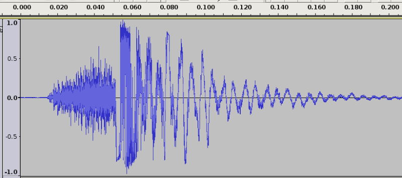

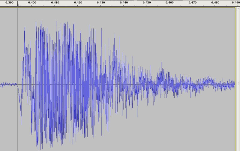

Just to show the flow of a QDV, this is the Audacity waveform showing 100ms of the sample recording. The sample is from 6.39 sec to 6.49 seconds of the recording. As you can see the entire discharge is pretty much completed in the 100 ms. This recording is of the 3 gallon tank with the 2 inch valve, quite considerably larger than the 3 liter pony tank in your launcher. Get a recording and compare performance.
EDIT, I added the MP3 of the tank valve test. Download the zip file and uncompress to play it. SF doesn't permit direct uploads of MP3 files.
Save the high speed photography to analyze the launches.
Remember that a hose to the barrel 1/2 the diameter of the barrel only has 1/4 the area. Due to the pressure rating on the hose, I'm assuming the hose is much smaller than 1/2 the barrel diameter. much smaller. Upgrade to a high flow large diameter low pressure solution.

Good luck with your cannon. @tech, sureshot sells a golf ball cannon but its a combustion. Also, I think this valve of yours is the most innovative I have myself seen. Oh, and on springs, you may try extension springs as I have used with the striker. They work well and hold up fine even to 5X shots, the problem with my design is the resistence tends to be a pain and if the piston isn't constantly lubricated it will stick, escpecially since the piston o-ring is compressed rather than floating.
Nah it's easy enough to do...just has to be tuned properly...i like the idea of non contact braking just because its funky tech but i think its massive overkill tbh
For the piston im thinking some aluminium or titanium alloy or possibly structural plastic and this kind of shape...i can wrap the piston arms in springs and the block is meant to represent the damper. Once the piston clears the gap it makes contact with the springs and damper which bring it to a stop thus no kick back
EDIT: the first sentence sounded glib...apologies, i just meant that i have designed a 85kg centrifugal clutch before...the spings on that experienced 10s of kNs of force everytime the pads caught...by comparison its not so tough
