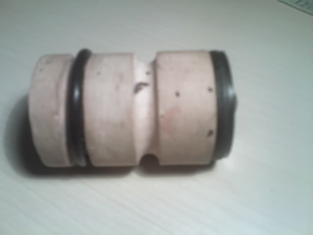

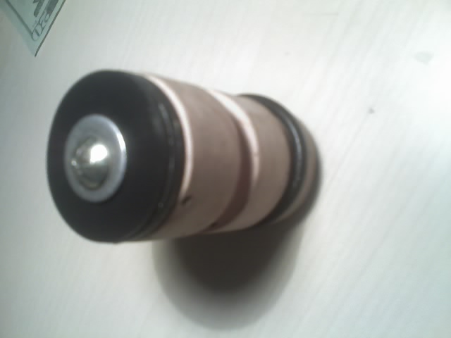

This is my first attempt at a cannon with a piston valve. It is a 1.5" barrel sealing piston valve with a Bondo piston. The piston was molded in 1.5" PVC, and then I set up a router to make the grooves for the o-rings. The piston valve is piloted by a 1" sprinkler valve, which in turn is piloted by a blowgun with a 0.25" ball valve as a safety. The piston is also easily serviceable through the female adapter. The chamber is 2" sch. 40, and the golf ball barrel is 1.5" SDR 21 sleeved in sch. 80 2" PVC. This thing shoots FAR. With only 50 psi the ball seems like it is immediately in the sky and beyond your vision. When I crank up the pressure, scary scary things happen. At 100 psi I've calculated (without drag) the range to be +/- 550 meters. I can barely see it coming out of the barrel, and when I am no longer able to see it, the ball has not yet reached it's maximum height.

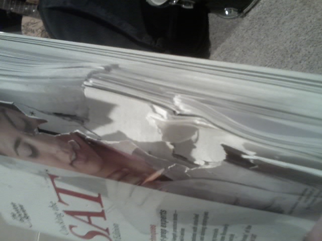

This is a damage pic of my SAT book.  At only 30 psi it tore through half the book, and this thing is really thick.

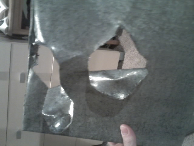

This is a damage pic of a piece of sheet metal.  This was done at only 15 psi.

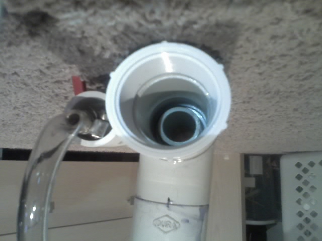

View of the serviceable piston.  Very convenient for lubing.

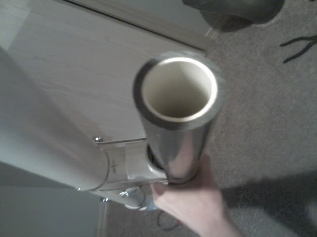

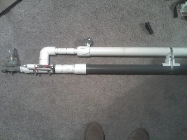

This is a view of the entire launcher.  I couldn't find 3" shc. 40 so I had to make a long 2" tank.
Golf ball barrel=DESTRUCTION

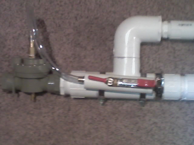

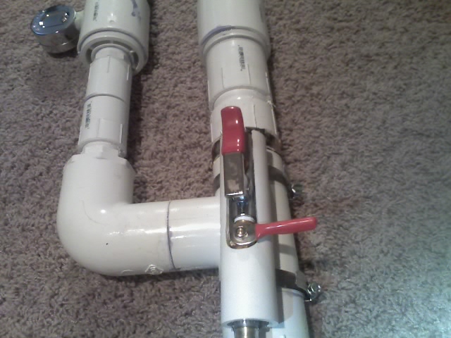

Closer view of the trigger assembly.
View of the back of the cannon.  You can see the trigger assembly here with the safety, and also the sprinkler valve.
View of the sealing face.  3 rubber washers, seals great.
Here is the piston with the grooves for the o-rings.  I only ended up using one o-ring because the valve would not actuate with both of the o-rings.

Is there any reason for the skinny section of pipe between the chamber and piston valve? I would think that would limit power.
Nice job on the piston.
Sun Oct 25, 2009 9:28 pm
Looking good, but your chamber is bigger than your barrel? Your chamber could be cut off at the barrel support and I doubt you'd notice the difference.

The skinny section is because I already had that air tank from a previous launcher, and didn't want to make a new one. Yeah it is a big chamber. When I made that chamber, I didn't know that much about potato guns so I over-compensated I think. I also have a potato barrel for this cannon, and it's nice to have larger volume of air behind that fat spud.

One thing I have to ask... did you have access to street elbows? I've become addicted to them, as they keep everything nice and compact 8)
I like the triggering setup!! The bondo piston is especially neat! (People like me don't have the patience for that!!)
Very cool build! I have a similar golfball cannon, and I love it!! I'm sure you love yours too :wink:
Oh, one more thing... for the barrel support, I would suggest putting some short screws through the tee piece and partially into the barrel sleeve to lock it in place. I use the same setup you do, and it slides a lot!!

Pilgrimman wrote:One thing I have to ask... did you have access to street elbows? I've become addicted to them, as they keep everything nice and compact 8)
Yeah the street elbows are convenient. My barrel support doesn't slide at all, but I have that worm-gear band really tight. I spent way too much time on the trigger area just because it looks sick :lol:
