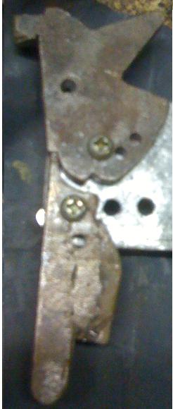

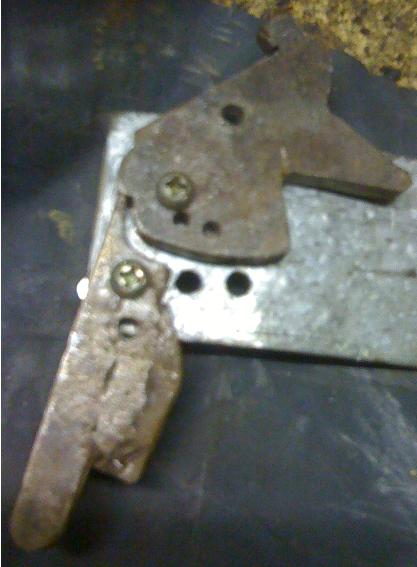

yer if it doesn't work out ill go 3way, i don't mind making the hammer valve or at lest mod a blow gun
have pics or the hammer
i have no spring for it yet but i think that ill use a rat trap as boyntonstu suggested to use on a ball valve

wow that looks good... is it from a real firearm/air gun ?

nar i made it today i copyed it from the insides of a cap gun the toy gun was plastic and not heavy or strong enough to use

Nice hammer you've got there.
Effectively the same as on my B2TB breakbarrel gun.
When you get the rat-trap-spring, the coil goes over the axle of the hammer, one end should hook into the hammer, the other should be locked by the main body.

@ -_- Very nice trigger man !! i've just started the same thing as you , bought a cap gun and copy the internals
(only got the hammer done so far :roll: )
It should work perfectly hoping you can find the right spring !!

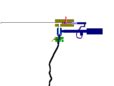

that's why I tried to make sure everyone understands that I was talking about a possible modification of BTB's design...
the PITBULL 9 uses a simple QEV + 3 way valve combo...
when the trigger is released the QEV is filled (hence normally open valve) but when you press the trigger the pilot volume of the QEV is vented to the atmosphere
the semiauto MKIII is exactly the same but it also has an air cylinder that loads ammo (while django's gun uses a simple T to do that)
have a look at the animation you said couldn't open -> http://www.wisc-online.com/objects/View ... ID=HYP4807
or look at the animation I created... I can't believe it took me only 20 minutes to make it
CLICK ON IT TO SEE MORE DETAILS
