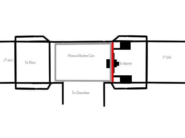

Hey members of spudfiles! I am very new to these air cannons and was wondering if you could help me on my design of my piston. It is for a physics project, (high school) and is needed to go at least 300ft. My partner and I decided on trying to build a piston valve that could give us the edge on the competition. However, upon reading through the forum, I have seem to have run into a problem with our design.
Due to money constraints and the need to fire a tennis ball, we could not order a 2.5" pipe online. So instead we decided to use 3" for the barrel and 4" for the chamber. We are using a 3" tee and will probably add some proxy or pieces of wood cemented on the barrel end to keep the piston from flying out. (Red marks.)
I have also read through the wiki but came out a bit confused. This seems like a 1 to 1 ratio valve but we were not sure because of our use of the stopper on the barrel end.
Will the piston just end up staying in place as described in the wiki or will it work?
If anything is confusing, please tell me and i will clarify. We are fully open to suggestions.
Thank you guys and gals!

The piston will remain closed as there is no force to open it. 1:1 ratio piston valve is a QDV or Quick Dump Valve. There is a page on it in the wiki. It does not use pressure in the pilot, but does require a mechanical force to trigger it open. Once it starts to open, the chamber pressure will finish opening it for you. The difficulty in building them is the chamber air has to be sealed from leaking to the barrel and to the pilot. This often requires o rings which is difficult to put on a peanut butter can.
Does your school have a machine shop with a lathe?
http://www.spudfiles.com/spud_wiki/inde ... Dump_Valve
One of the barrel sealer valves may work better for you with a peanut butter can. A reducer can be cut down to fit in the end of the 3 inch barrel to give you a 2 inch valve seat. A flat seal such as sheet rubber can be used for the barrel seal instead of o rings. A traditional trigger valve such as a ball valve or sprinkler valve can be used.
Don't forget to do the math. What pressure are you planning on using. Figure the area of the can exposed to the chamber pressure. Can the piston hold up to the pressure?

Thank you guys for the quick reply! :)
- My school does not have a lathe unfortunately.
- Thank you very much for your suggestion on using a spring and the image of redesigning our valve. We will most likely use that design.
- We are also using a 1" sprinkler valve modded with a blow gun.
- Yes they were DWV fittings and so we went to return them today, the home depot staff said that DWV should hold pressure up to approx 120 psi but from reading forums last night found out that they have been known to blow at very low pressures. We have been looking every where for pressurized fittings and haven't found any yet. Thank you for saving us from being blown up. ;)
I will update once we get our pressure rated fittings.
