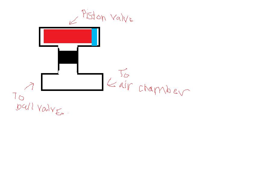

if i was to arrange the piston valve to this position would it be still as effective?

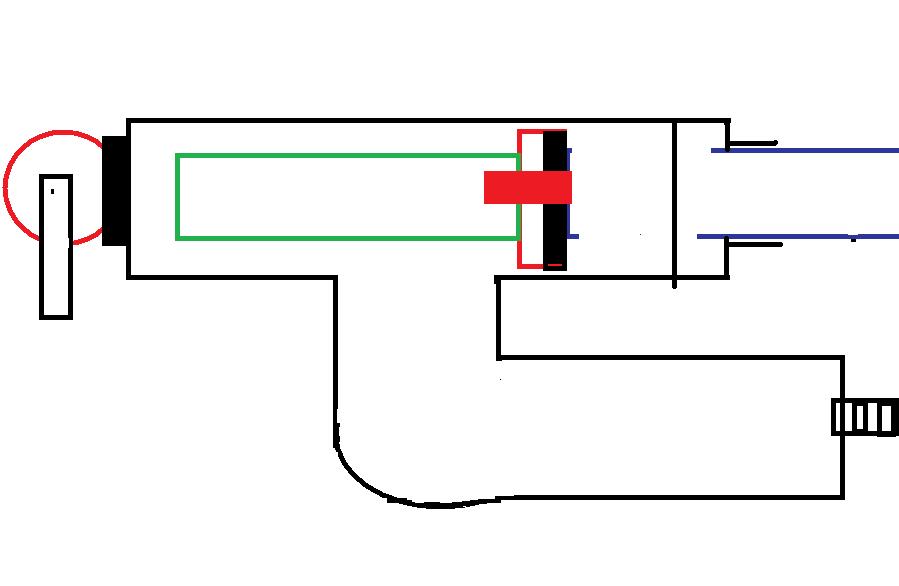

would this work?
would this work?

On the first Will this work photo, not very well. When the piston is open, the piston is in the way of the flow. Look at some other piston designs where the piston retracts back past the inlet to the valve so the flow is open all the way through. They work much better.
