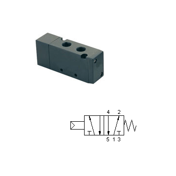

I consider buying this pilot operated, 5 way 2 position valve (Pic included). If i understand how this valve function, the pilot on the side of the valve, when released, will move the bolt inside the valve and redirect the pressure applied to the ports?
Like, for instance, if i would attach my air source to port 1, and my barrel seal piston to port 2, then, when the pilot is be release, the port 2's pressure would be redirected to port 3, piloting the piston?

Can't you just get another solenoid for the valve you have ?? normally they are separate parts
The pilot on that valve is not like pilot side on piston valves... it's positive pressure valve - so you need another 3 way to pressurise it (to switch it) and then vent it.
I think you could achieve what you want with some indirect acting solenoid valves. You'd just have to remove the solenoid and use a blowgun to switch the valve
Though I think you'd be better off with a manual valve
