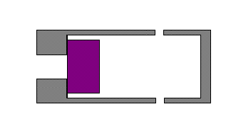

Hello ,hell!! i have some problems with a pop-off valve i tried to make. Usualy i ask people of my country's website ,patator.forum but we dont manage to find the solution.
First of all the pop- off is working , with a ball valve a litle opened but without the qev. You can see that in my video:
With the Qev , it shots but when i close the gun. I dont know i have tried with many ball-valve in differents places but its never worked.
Thanks if someone could help me, :) nice day to all of you!
(i dont know how to put the video here instead of the link, sory)
Mon Oct 18, 2010 7:00 am
Great job on the farting machine :) Y
Your exhaust hole is too far away from the piston seat:
Try drilling another one further down and it should do the trick.

Ok, thanks, in fact this think (my pop-off) was an air cylinder before, its for that reason it is very big. :?
I am gone to try with a hole at the bottom , thanks dude :)

On a pop off valve the port is far away from the seat. Here is the theory.. Instead of thinking small full auto pilot areas for the theory, think of the original application, large air tank.
I modified the drawing to show the main important dimensions. When closed the small diameter near the inlet is the only area the the tank pressure pushes on. When the tank pressure rises too high, this valve seat cracks open and a larger diameter is exposed. The larger diameter does not seal, but acts as a sail in the discharge path lifting the valve near the ports near the other end of the cylinder. Two styles of ports are popular, ports out the side and for steam, port out the end to direct the flow away from the boiler and people, so the open end is oriented skyward. This flow holds the valve open. When the pressure drops and the flow is no longer high enough to float the valve in the open position, it sinks back toward the seat. When it gets close to the seat it begins to interfere with the flow, reducing it further, the sail fails to hold the valve open and it pops back closed. This is why they pop open and pop closed.
If you wish to modify a compressor pop off valve, the "sail" area can be altered to change the pressure the valve can re-close. Taking apart a compressor pop off and soldering a extra wire rim on the sail can cause it to remain open longer without changing it's flow when open as the flow when open is set by the valve seat orifice size.
I learned this when studying steam engines and building some for the boiler for models. There is a science to setting the ratio of a pop off valve.
Tue Oct 19, 2010 4:27 am
Tech, what you posted is conceptually identical to mine, the main point is that the exhaust port is always exposed even with minimal piston movement, otherwise it's farting machine all the way.
The difference is that mine is not intended as a pilot but as a primary valve and has a sealed piston, so the air goes directly to the port without losing pressure by expanding in the area behind the piston before exhausting, and it also means there is no air pressure behind the pressure attempting to equalise the forces opening the piston ensuring a more effective "pop".

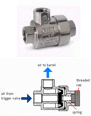

Tue Oct 19, 2010 7:21 am
lozz08 wrote:Why do you dismiss the rattlesnake valve poland?
Because he has no concept of simplicty and loves to contradict me ;)
It's just not that easy to build.
There was talk of converting a QEV, it could work if made like this:
