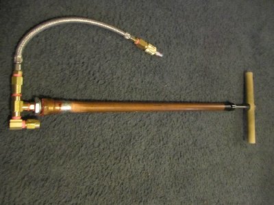

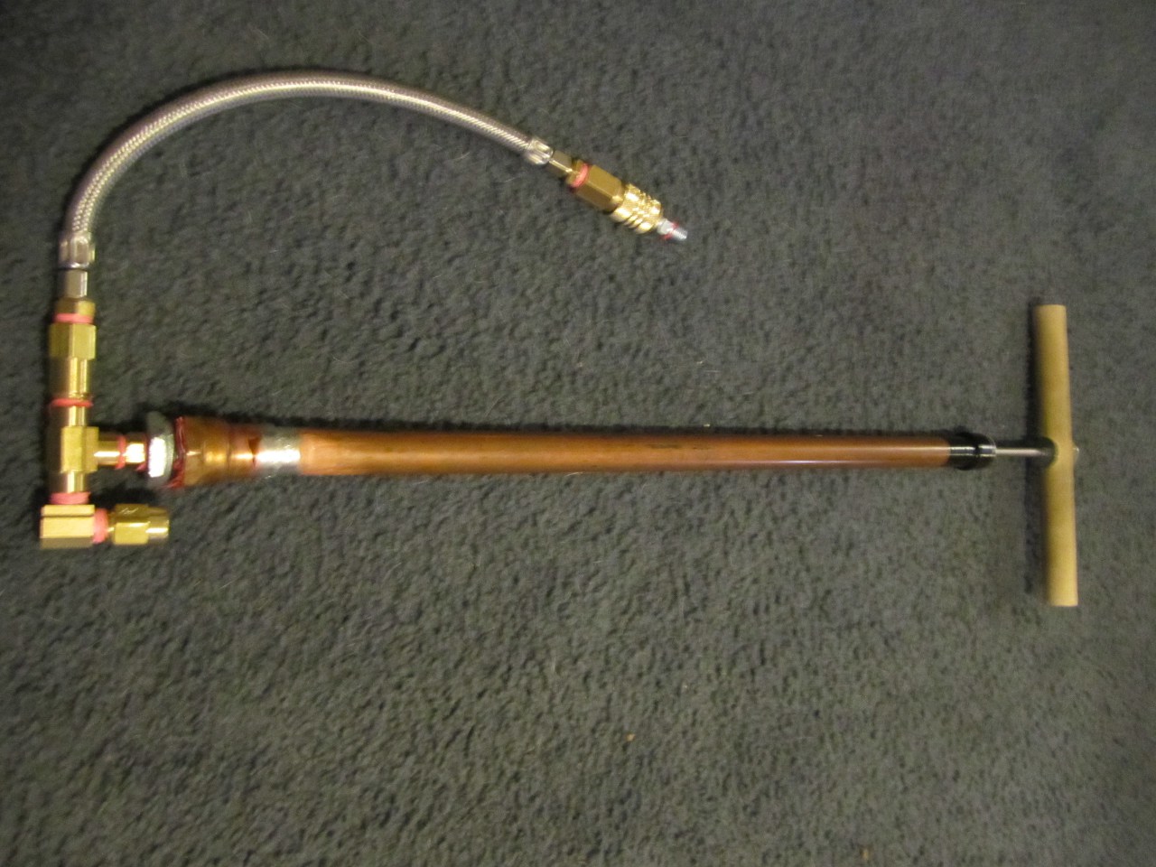

High pressure pump.
High pressure pump.

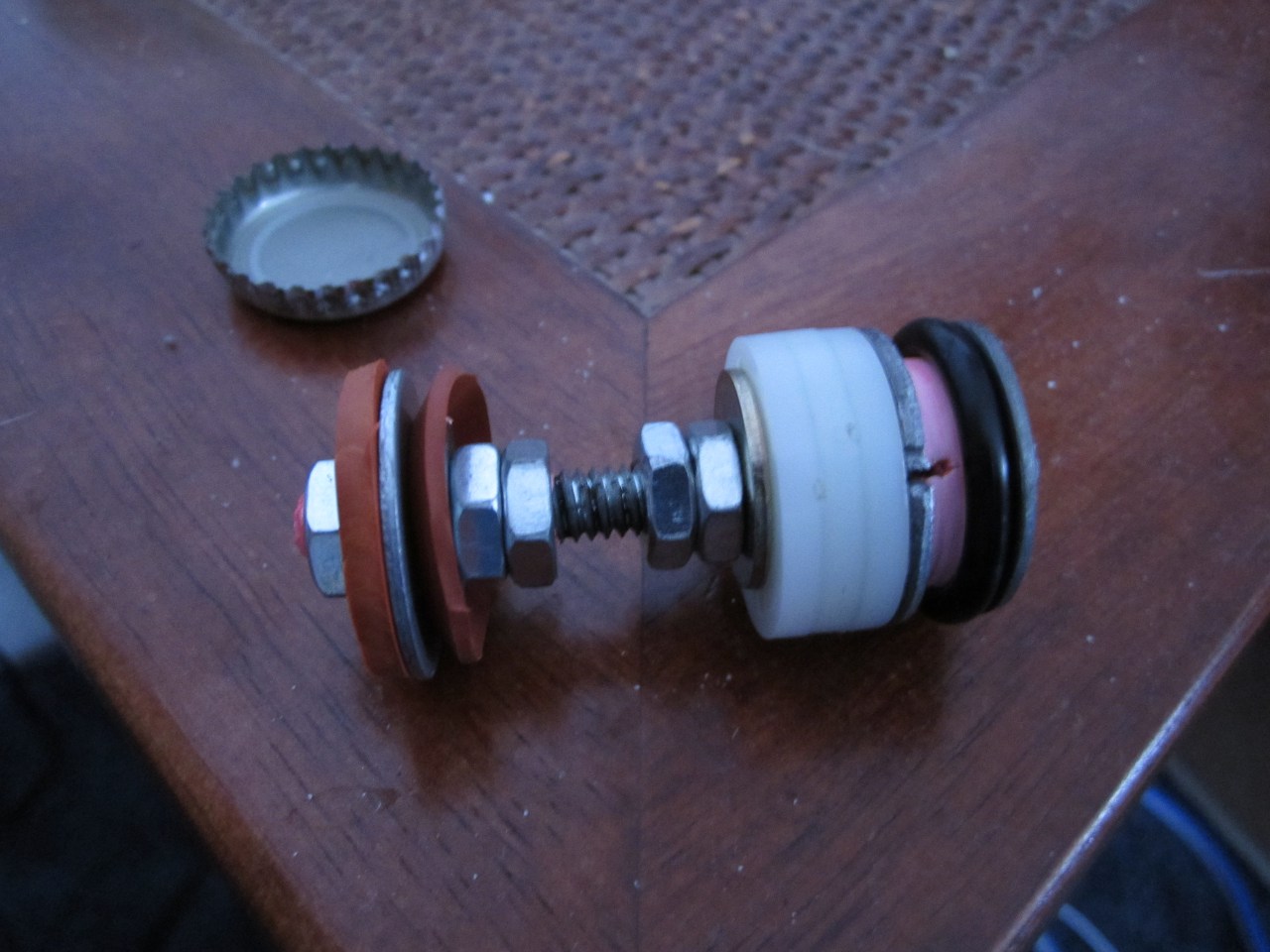

Piston.
Piston.

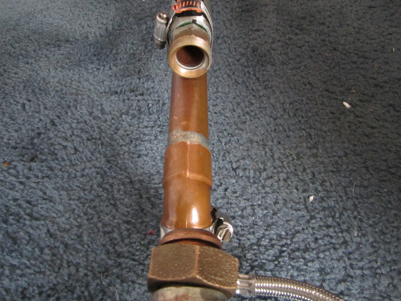

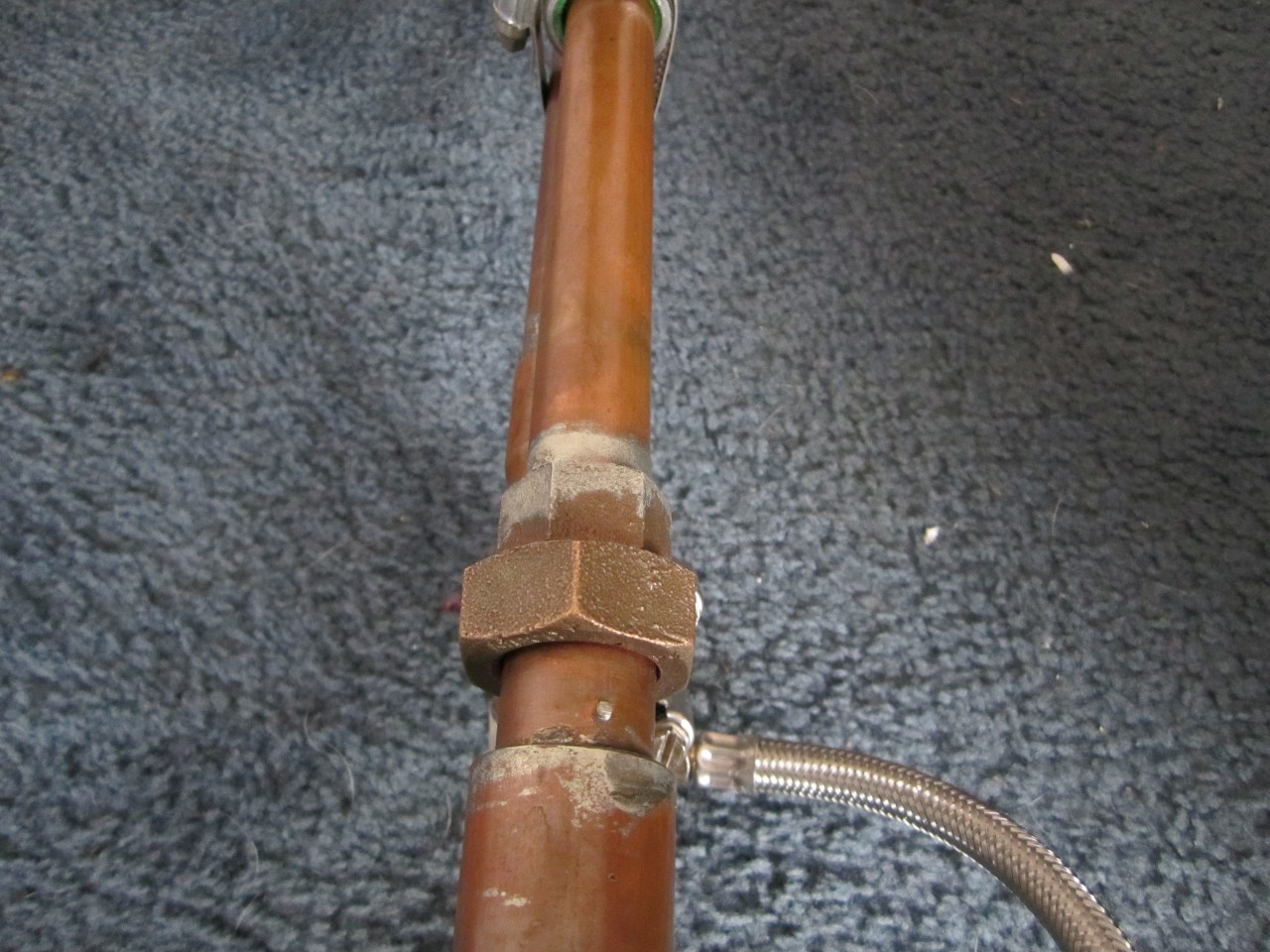

Barrel supports.
Barrel supports.

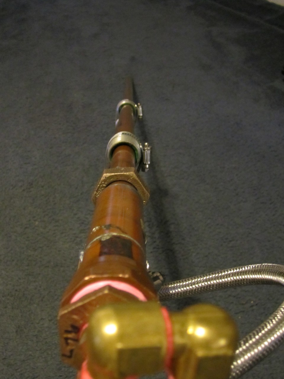

Looking down the barrel.

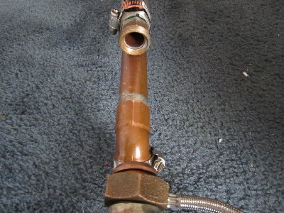

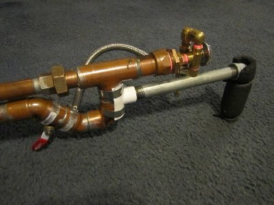

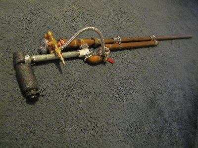

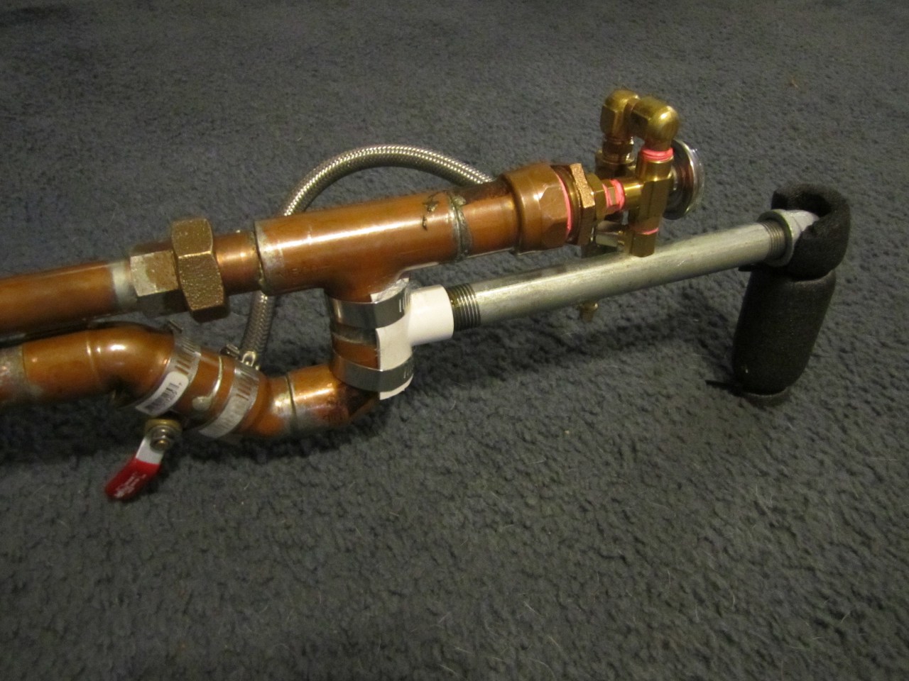

I've swapped and modified and tinkered, and have finally got this gun the way I'd like it.
Even with the shorter chamber, it's quite a chore getting this thing to 300 PSI, much less the originally planned 400 PSI. However, despite the reduced pressure, it still packs a big punch (in a small package!). Here's the updated damage video, in which I make it rain. :D
Overall, I'm very happy with the final product. Tell me what you think!

I originally planned to take this launcher to 450 PSI with a homemade pump. The pump works fine, but even when initially filling to ~120 PSI with a cheap bike pump, and then "topping it off" with the homemade HP pump, it takes way too long to get the launcher even to 200 PSI. It's not very enjoyable, and by the time I shoot I can barely hold the barrel steady. Future modifications would include either cutting down the chamber or investing in a HPA tank and regulator.

The valve is a 3/4" porting barrel sealing piston valve. The piston was, overall, the most tedious to assemble part of the launcher, required about a full day to get right. The first piston I built was slightly too short, which caused the piston to jam against the barrel port. After re-polishing the barrel seat, I remedied this by moving the nylon "plug" back slightly, so it would stay in the piston track.
The piston is a one-way floating o-ring type, which allows air to flow from the pilot to the chamber (when filling the pilot pressure is higher than the chamber pressure, forcing the o-ring towards the front of the piston and uncovering the equalization (blind) hole. When piloting, the pressure in the chamber is higher, forcing the o-ring towards the back of the piston, and sealing off the pilot from the chamber completely. All of this was made with standard parts (different sized washers), and the o-ring grooves simply required a couple of wraps of teflon tape to get the piston sealing in the track pipe.
Today, I got some high durometer (70A) rubber for the sealing face, and I haven't had a single leak since.

The position of the pilot valve and the addition of a short (~10" long) shoulder stock make this thing very comfortable to shoot, even with a 7' overall length. It lends itself better to a sitting position over prone or standing, which is fine by me anyway since I usually shoot from sitting with regular firearms or airguns.
I also added a BSA red dot sight I've had laying around for years. I just had to get a new battery and it works fine. The launcher itself isn't very accurate with my current ammunition, so the best I could do was bore-sight the scope, which allows me to hit aluminum cans all day at 10 meters.

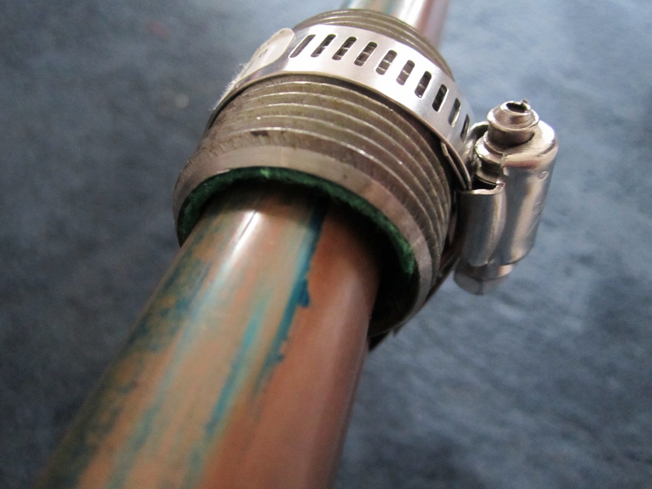

The barrel is breech loading, and slides back and forth through some 1" steel pipe nipples lined with felt.

I really like the sort of bull-pup configuration, but that BV trigger looks a little uncomfortable. Why dont you put it right up against the pilot area and have a trigger with a rod actuate it?
Posts: 3640
Been thanked: 62 times
Wed Mar 09, 2011 7:35 pm
That would be good for reducing pilot volume, but as far as comfort goes it's actually pretty nice where it is. When firing I can put some pressure on the very tip of the handle until it "gives" and sort of flips the valve open. I know it sounds weird but it works. :)
I actually wasn't shooting for a bullpup configuration but, hey, I'll take what I can get. Thanks! :wink:

Why such an overly complicated piston? Mine looks like this.
sorry for big pic.
And I think you should put a blowgun on.
Other than that, its pretty nice.

Gun Freak, the white part is simply to keep the 1" steel washers from digging into the copper walls. It simply keeps the piston centered better. Other than that I can't tell what else is complicated?
I really don't see how much easier a blowgun would make things, but I guess I could dig one up and give it a whirl, although I already had one on there and was less than impressed.
Thanks for the suggestions.

The rubber behind the piston face, the teflon tape on the groove, extra washers. I'm not nagging, just think it could be simpler without all the extracurricular activities, like mine :wink:
Posts: 3640
Wed Mar 09, 2011 8:49 pm
In order: :D
The rubber behind the piston face is simply to reduce leaks through the nuts and washers and out the barrel. I've always had problems with these leaks on my bolt pistons. There is also teflon tape wrapped under the nuts and washers holding the sealing face on.
The teflon tape in the groove is simply because the groove is too deep. Since I had to use what could be got at Ace Hardware, the closest I could come up with is a 1/4"x1" fender washer sandwiching four 1/4" regular washers (3/4" OD). This created a 1/8" deep groove, but the copper pipe is larger than 1" in ID, so some teflon tape made up the difference. I've done this many times on homemade o-ring grooves, because they're, well, homemade. :) To create the air passage for the floating type o-ring, I simply hacked a slit into the forward two 3/4" OD washers and simply cut the 1" OD washer from edge to center. This took about 5 minutes with a hacksaw. Keep the slits lined up with an old razor blade when tightening and Robert's your mother's brother, you've got a blind hole without a drill bit. :roll:
The extra washers are simply because the nylon washers used to form the bulk of the piston are not for 1/4" bolts, so the nuts wouldn't clamp them by themselves.
The extra nuts serve to lock the different portions of the piston in place so I don't wind up having to adjust them anytime soon.
There are also things you can't see. :lol: For instance, since the nylon washers aren't meant for 1/4" bolts, the 1/4" allthread was wrapped with electrical tape until it matched the inside diameter of them and them trimmed so that it sat flush under the washers. This was done on all of the hardware except for the forward portion of the piston (where I used teflon tape to do the same thing and also aid in sealing). The result is a piston as close to a true cylinder as possible with ordinary zinc, plastic, and rubber hardware, and a reliable seal with the barrel port.
I know that's a lot to read, but it should answer your question. :P
EDIT: bolts aren't nuts, kids.

It's ok, Mark. I like your piston. :D
