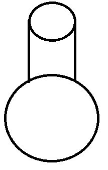

I assume your talking about the front of the chamber and the barrel above when referring to the other side. An easy way is to simply measure the distance between the chamber and barrel at the rear where the adapters are then sit down with a protractor and draw one circle the size of your chamber, and one above that the size of your barrel, making the distance between the two circle edges the same as the measurement you just took off the gun. Then draw a line from both outer edges of your top circle, to where it meets the bottom circle, forming a shape like so
[/img][img]
Then get anything that is easy to cut like a block of wood, or hard foam etc around 3cm or so thick, and stick the paper to it so you have a template. Then cut it out like so
[/img][img]
Then stick it between your barrel and chamber at the front, then buy a couple of screw hose clamps (they are metal straps with a screw that tightens them) from the hardware store that fit around your setup then viola. You have a brace[/img]

Thanks, I appreciate the response. Do they make hose clamps that large, there is probably close to 10 inches between the bottom of my compression chamber and the top of my barrel.

They do sell them, just a matter of finding that size. Otherwise you can use anything from velcro straps to cable ties.

You can also put multiple together to make one big hose clamp
