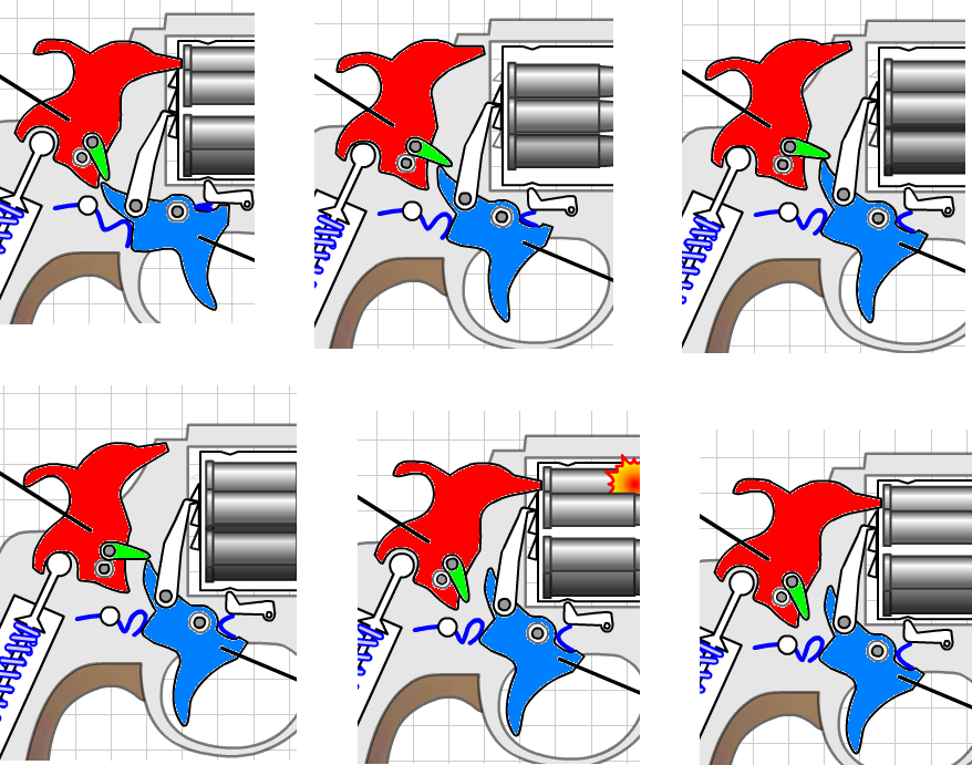

Sat Aug 20, 2011 10:54 am
Maybe the FX design is a little too complex, but surely you can find inspiration here?

they are for single shots or electronic :(
may be I should just make one that I can recock the hammer and reload ammo in one single action

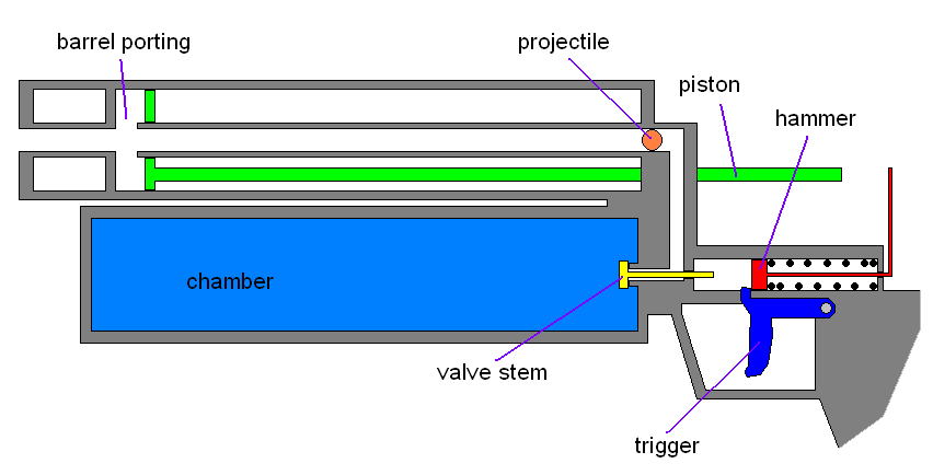

Here's a basic diagram of how the FX Monsoon works, I've not shown the magazine for the sake of clarity.
The sequence is like this:
1) blue trigger is pulled, releasing the red hammer
2) hammer its the yellow valve stem releasing a burs of air
3) the air fires the projectile
4) when the projectile passes barrel porting, air pushes the green piston back
5) the piston recocks the hammer, which gives semi or full auto depending on whether the trigger is still held or not

that is a great diagram there jack! :D

looks like a lot of work :? but i will try :)
Sat Aug 20, 2011 3:46 pm
Not as hard as you think. Imagine adding a silencer, but the back wall can move. Connect that to your hammer and you're done.
The important think is to have good enough porting flow and a large low priction piston for the air to push on.

I'm having a hard time believing that the barrel piston will travel far back enough, given the small time the air has to act on it.
Sat Aug 20, 2011 4:59 pm
Gun Freak wrote:I'm having a hard time believing that the barrel piston will travel far back enough, given the small time the air has to act on it.
Works for the FX Monsoon and Revolution, though granted for a 3000-1500 psi range. It certainly won't work for a low powered launchers. Moving the porting towards the breech will certainly improve chances of success.
Also consider that the Monsoon has one tough hammer spring, takes a lot of effort to cock it, a lower pressure launcher has much lower cocking requirements.

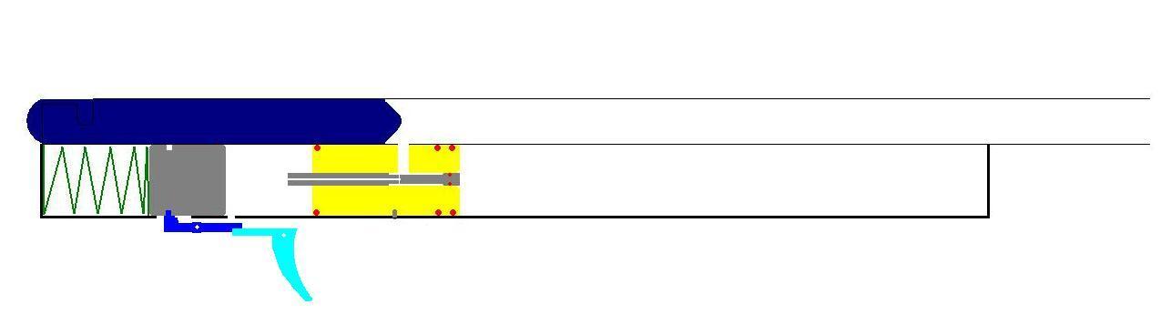

idk if it would work but i would like to try make it if i can get the right parts.
It's basically a crosman 2240.
hammer valve.JPG (22.77 KiB) Viewed 5867 times
