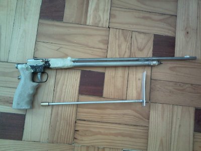

Hi everybody

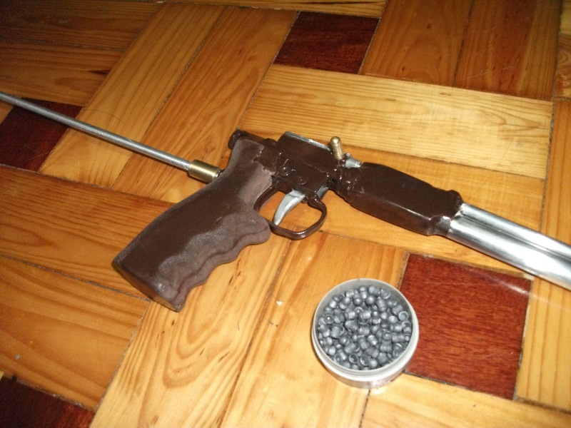

As most of you knows, I found a way to build a simple hammer valve using a blowgun. So I used the valve I showed here: http://www.spudfiles.com/forums/hammer- ... 23202.html to make a simple pcp gun, just to see the power, and at 400 psi it´s very decent with a pellet, pretty good compare to commercial pellet guns :P . The chamber isn´t big, so I can charge it with my shock pump. I also combined the recock with reload, but I didn´t put a magazine on it, maybe later I will add a revolver style magazine.
I will use a bigger chamber and a better stock on this gun and use more pressure(about 800 psi?)
Didn´t use a lathe or mill, looks like I didn´t really need to use them either :roll: . Yeah I know I need to paint it, but as I´m not sure if I´m going change it more or not, so doesn´t worth to paint it now.

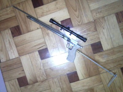

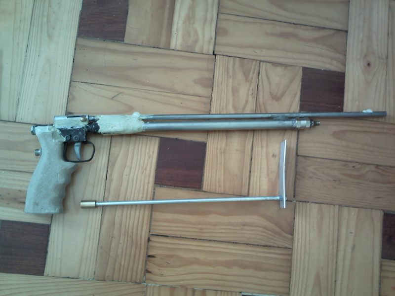

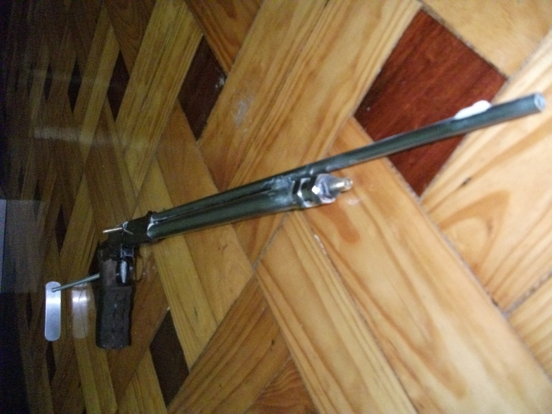

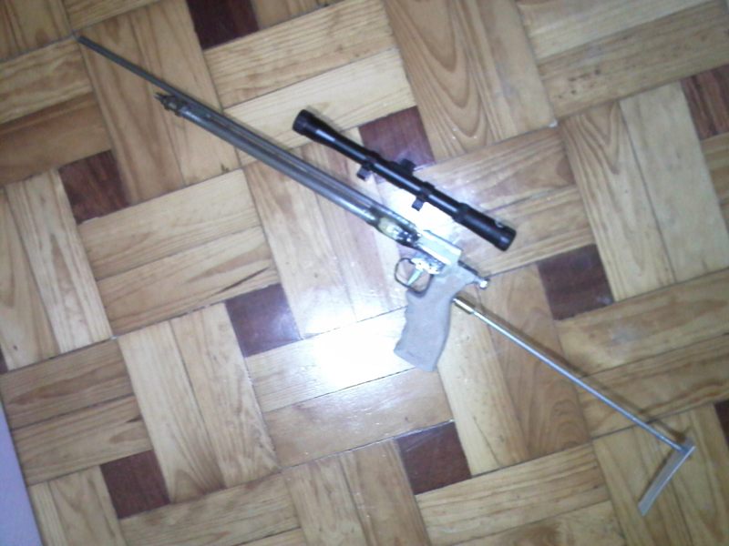

finished for now, I´m happy with it :) detachable buttstock<br />(scope not added yet)

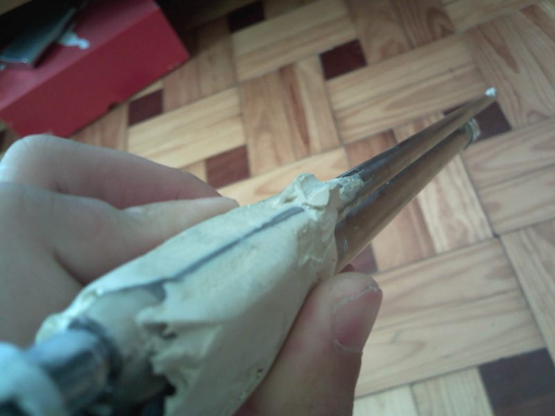

fiberglass to cover everything, still need some sanding

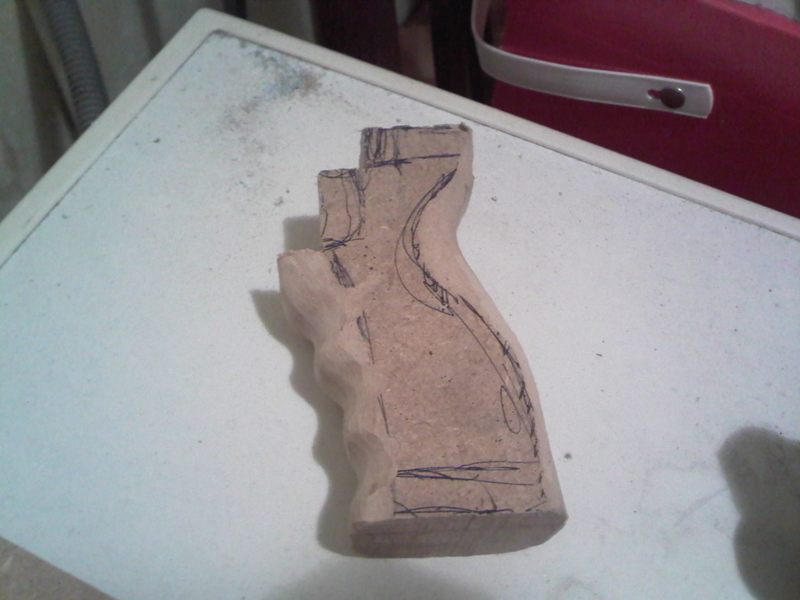

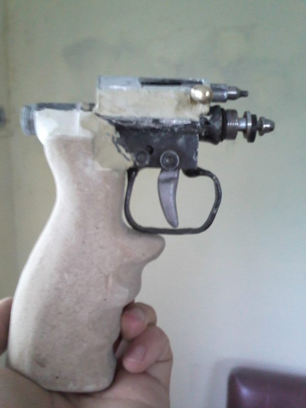

made a simple but ergonomic pistol gap for it

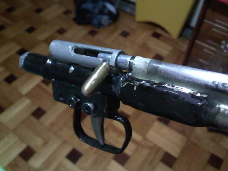

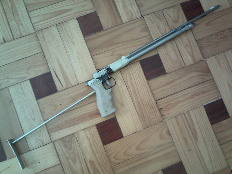

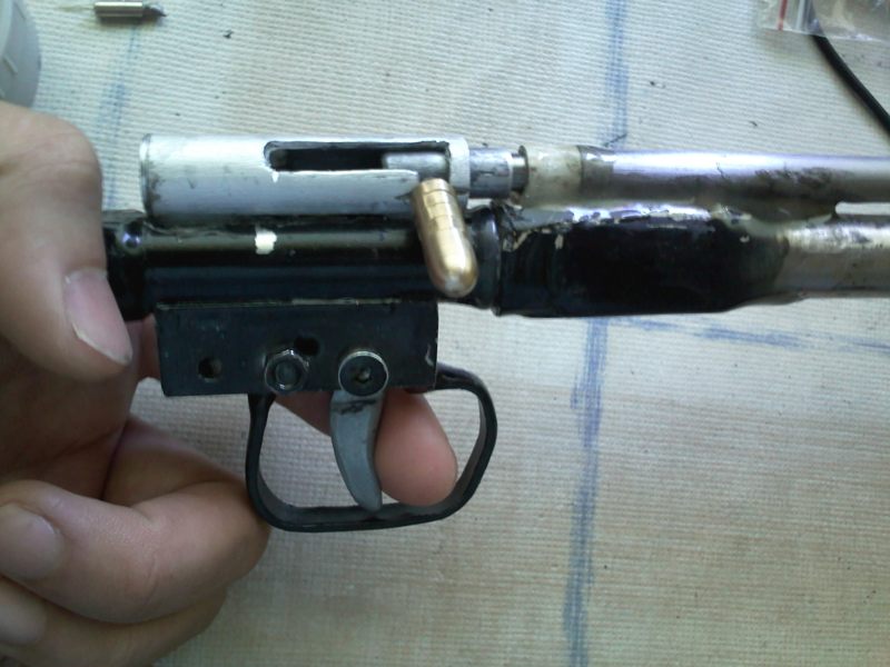

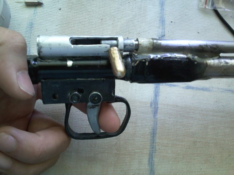

breech closed, ready to fire

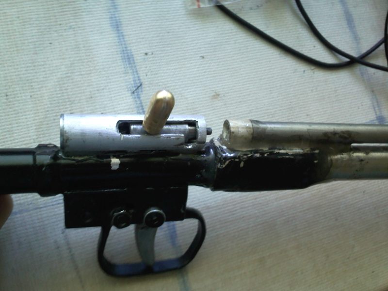

breech open, recocked hammer

wyz2285 wrote:Didn´t use a lathe or mill, looks like I didn´t really need to use them either :roll:
Machine tools help, but with some creativity and a lot of epoxy, much can be achieved - and this proves it nicely, good job! How many useful shots do you get per 400 psi fill?
Beyond 500 the valve will probably start to leak...
I have taken this valve to 800, no leaks, but I wouldn´t use 800psi every time.
with 400psi, about 5 nice shoots, pressure drop of 20 to 25 psi between each shoots

WOW! Thats great! Way to make it cock and open the breech at the same time. This is very nicely done!
wyz2285
Austria
Posts: 2388
Location: Porto, Portugal
Tue Sep 06, 2011 4:18 pm
A lot of people have told me to combine the reload action and recocking the hammer actually :D but because this it's a little hard to pull the bolt, so later I will find a way to use a lever action to replace that, something like some FX airgun's bolt action :)

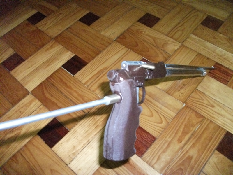

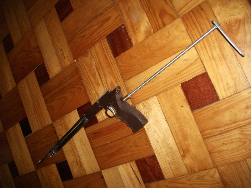

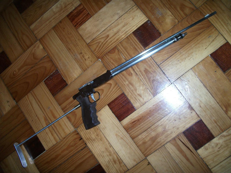

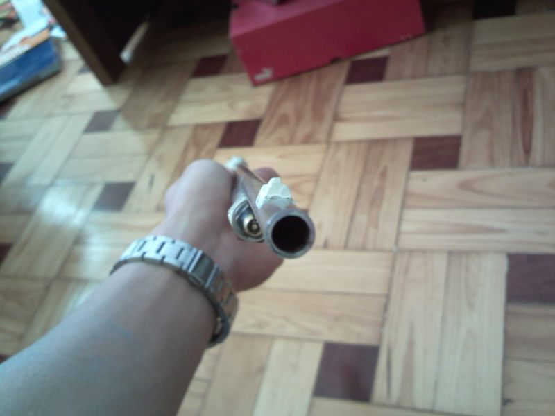

Finished sanding and painting, the shining brass and aluminium looks really great :P the sight works well, not going to mont a scope after all.
Some quality photos

Thu Sep 08, 2011 3:51 am
looks great but does your thumb hit the stock? looks like it would
wyz2285
Austria
Posts: 2388
Thu Sep 08, 2011 4:05 am
? I didn´t get it :?:
Crna Legija
Posts: 2333
Location: australia
Thu Sep 08, 2011 4:13 am
wyz2285 wrote:? I didn´t get it :?:
its probably just the pics but it kinda looks like the brass part of the stock is right where your thumb would go passed
wyz2285
Austria
Posts: 2388
Thu Sep 08, 2011 4:59 am
Hum it does looks like it would lol but in reality it doesn't, it's very ergonomic :)
