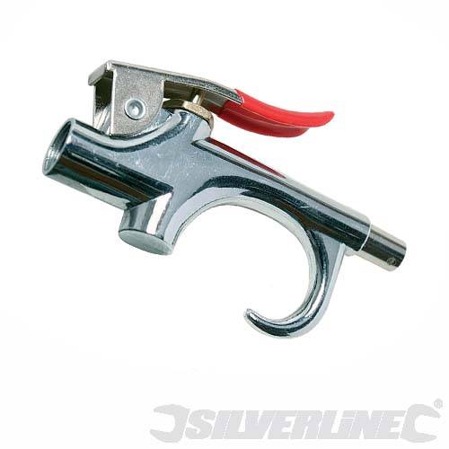

For my next multishot QEV project i have decided im not going to use a blowgun as a pilot valve like the one below:
i have used these in my other 2 guns and they work well but i have many problems sealing the thread as it is soft metal and im not sure how well they rate at higher pressures. Any suggestions for other types of pilot valves?

jmez1996 wrote: i have used these in my other 2 guns and they work well but i have many problems sealing the thread as it is soft metal and im not sure how well they rate at higher pressures. Any suggestions for other types of pilot valves?
If they leak where the metal plate presses the valve down to release pressure, just grab a crescent wrench and tighten it down until it stops. Other wise grab teflon tape.

Modifying it doesn't make it stronger, if anything, weaker. You modify it for flow. I believe the good quality ones don't leak until 500 psi.

I just want to add that all blow guns are not equal. The ones $2.99 ones from Harbor Freight are pretty much worthless. Not only is the flow low, but they tend to fail to work at all after a while. The $4.98 Kobalt one that I picked up at Lowes isn't great but is much better.

I had blowguns leak at the brass insert threads, teflon tape fixed it

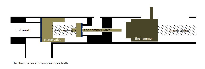

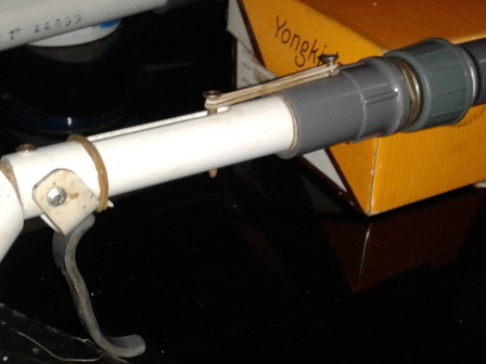

Yes of course, hammer valve, I love hammer valve, I made a simple and cheap one like this for my gun...
and forget about that rubber bands, I'm sure you have decent spring to replace them.

on the contrary, you can use hammer valve to pilot for multiply shoot, you just need to add spring behind the piston valve and you can fill the air (if you want it) from the chamber side. The hammer valve will close when the pilot area pressurized..
I add picture for mine, I use one spring that used by the piston and the hammer valve, I don't know if this is OK, its work on mine though.
