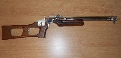

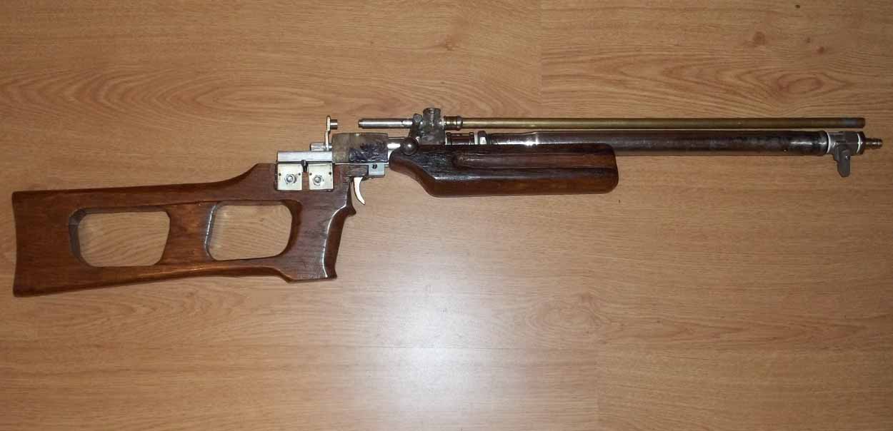

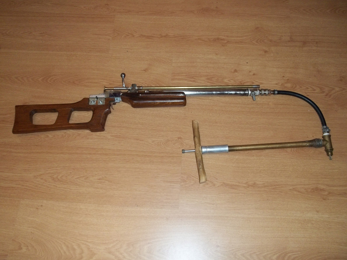

Hello again, this is the new version of my previous gun:
http://www.spudfiles.com/forums/vintore ... 22610.html
This time it is multi-shot and it is breech-loading. The wood, the barrel and the air tank are the same, as you can see. The tank is slightly changed ( the ugly welding at the end is gone :D ). The stock is still detachable.

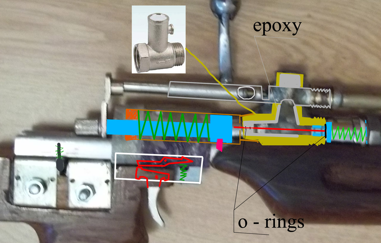

The hammer valve is very simple, but it works. I tried to make the BTB counterbalanced design, but I failed miserably. If I find some suitable parts I will try again :D . During the building of the gun I discovered the magical world of the polyester raisin and fiberglass and I used them to fixate the rail and the safety valve together and to cast holders for the hammer tube. I hope in next projects i'll find some more applications for it. Compared to the first version this one is less powerful, but the trigger pull is much better. Now i need a manometer and a fridge compressor. If I manage to achieve decent power i might buy a cheap 6.35 barrel, it will spare me lots of lead casting and will improve accuracy ( now my barrel is slightly bent ). I found spare turkish barrels for 20 euros.
Sorry for the retarded diagram on the last picture, but that was the only way to show you the inner parts , because I borrowed a camera from a friend and i had no time to disassemble the gun.
I'll be happy to hear your thoughts and ideas for improvement.
And again - sorry for my broken english.

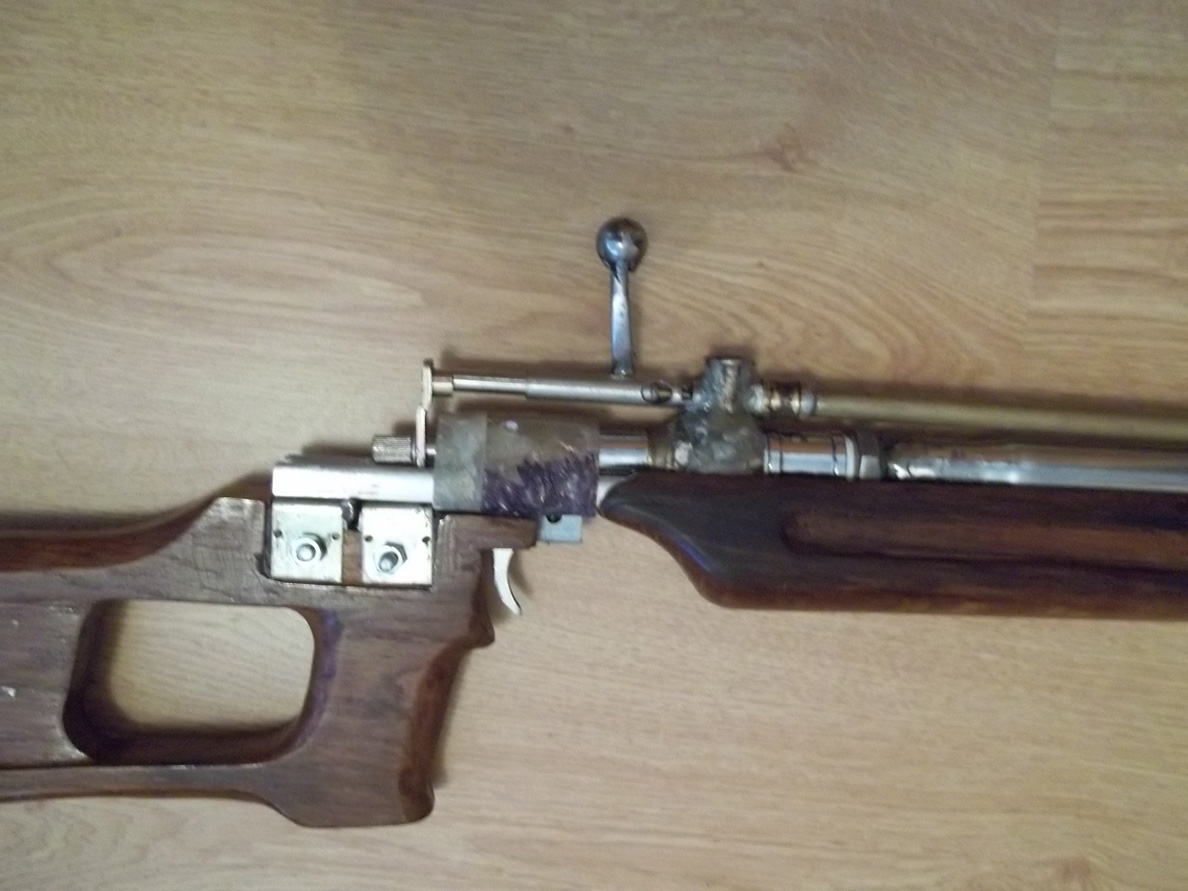

this is only the corpse of the safety valve

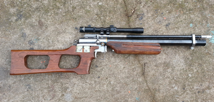

update
update

I dont have any idea to what preassure my pump is capable of, but after 100-120 strokes the check valve starts to leak. Today my hammer spring broke so I have to find another one that fits , or make one.

Whats the odd looking plumbing part labeled on the bottom picture?
Mon Jan 23, 2012 9:25 am
looks like a water heater safety valve: http://www.tjskl.org.cn/products/czaff9 ... 90c46.html

Ahh, I thought it looked familiar. Any reason why this is useful here? It looks like it was used as a Tee, I'm wondering if I'm missing something.
bahur47
Posts: 22
Joined: Sun Oct 10, 2010 8:42 am
Mon Jan 23, 2012 2:07 pm
I didn't bought it specially for this purpose, just spot it lying in the plumbing box , it was broken and i thought " hmm this might work" . I used it because I needed a part with 1 female and 1 male end , also I thought this upper part would be suitable to fixate the loading mechanism on it. Now I realize I can use valve extension like this http://www.westradiators.co.uk/radiator ... -C-LPU.jpg , to put a hole in it and connect it with the loading part , then cast a resin block around it for sturdiness and it would look better.
