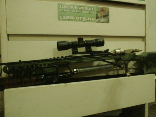

6.03 &amp;quot;madbull&amp;quot; airsoft barrel , 3/8 qev , ninja 3000psi paintball tank , 300psi regulator , barnett 4x32 crossbow scope, (Stock used to be a crossbow)
6.03 &quot;madbull&quot; airsoft barrel , 3/8 qev , ninja 3000psi paintball tank , 300psi regulator , barnett 4x32 crossbow scope, (Stock used to be a crossbow)

haha now thats what im talkin bout ! Jonesy nice job man, you got anymore details/pics? that things beautiful.
yeah this wasnt really a topic for bitchin that its hard to get stuff, its what you can build from what you can get.
jonesy is that chamber filled? little hard to get some details from the pic, but thats what im looking at building, rifle style clip fed bolt action, sodabulb rounds.
