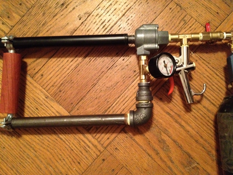

First off, a big Thank You to the members of this site. Although, seeing some of the cannons you guys build makes me feel like I'll never get to a certain level. After seeing Lardas' First Hybrid I considered trying to get a job at a Machine Shop :idea:
Anyhow I started with a Cold Steel "Big Bore" blowgun. They are fun as-is, but I thought it could use more power.
The progression went like this:
1. Stock Blowgun
2. Hooked up to a paintball gun (not enough gas per shot to do anything effective with).

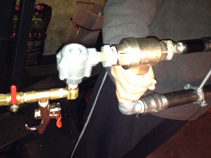

3. Taking the Metered Propane tube off my combustion gun and making chamber attached to a spring loaded ball valve. Shooting at well over 1,500 PSI (yes, reprimand me!).
4. Figuring out (thanks to the "Goons at Spudfiles"-D. Hall's words, not mine) that a QEV at 200 PSI would be more powerful and much more efficient than a ball valve.
Barrel: .625, 5 foot Blowgun
Chamber: approx 13 inches of .5 steel pipe
QEV: 1/4" in & Chamber, 3/8" into barrel
Trigger: Heavy duty blow gun
PSI gauge: 0-600
Gas hook up taken off a paintball gun. I have used HPA, CO2 and Nitrogen, with CO2 being the cheapest (I own a 20 lb bottle at $21 a fill)
and Nitrogen being ideal, but hard to get.

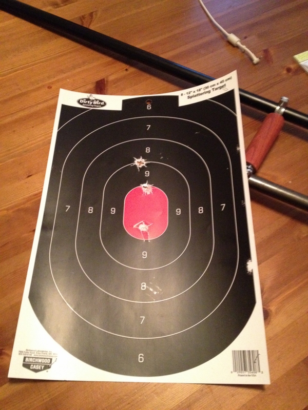

My goal is a 50/50 mix of power and accuracy. The shots I took from 25 yards (measured out and legit) were without any sights on the cannon. These are 2 3 gram darts and some marble/glass shot from 25 yards. Fired at 250 psi.

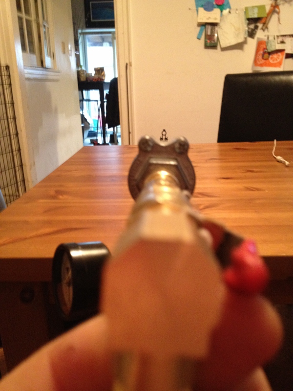

Since then I have added an empty laser sight mount, upside down as a ghost sight. I think it should work well because the QEV provides a concave top to center the sight.
I do have videos and am working on uploading them to YouTube.
DISCLAIMER: On the videos I refer to this as my "First Pneumonic Cannon". So, I know, but feel free to get your licks in. If anyone has a Pneumonic for remembering Pneumatic I'm all ears!
Questions:
How do I make this thing more powerful and more accurate?
Would a piston valve be an improvement or not really due to the barrel size?
While I love combustion cannons (I'll post my pics later), I love in the city and there is really no place to shoot such a beast (mine is a beast). I do have a silencer....
Hybrids are awesome, but there is something unappealing about the amount of time in between shots.
My next idea would be a pneuMATIC, autoMATIC that shoots slingshot ammo/buck shot- Who has already done this?
Again, I am a humble amateur amongst Demi-Gods! Thanks for reading.

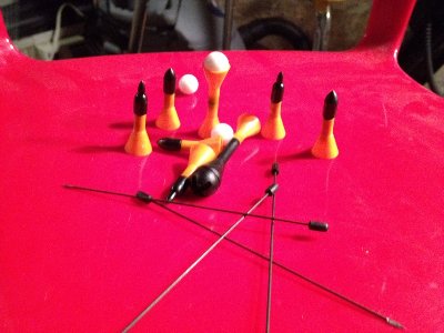

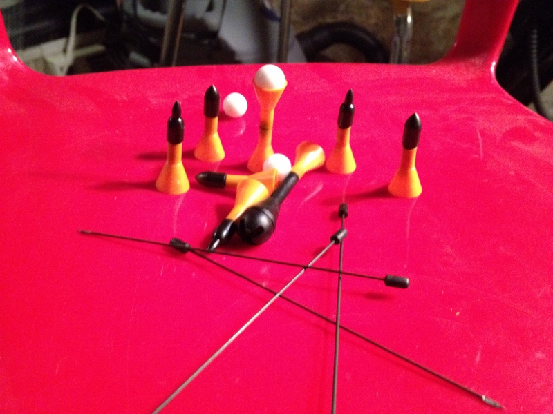

Picture of ammo added. The cannon also shoots regular arrows.
Sights
Sights
3 shots from 25 yards

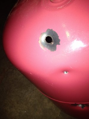

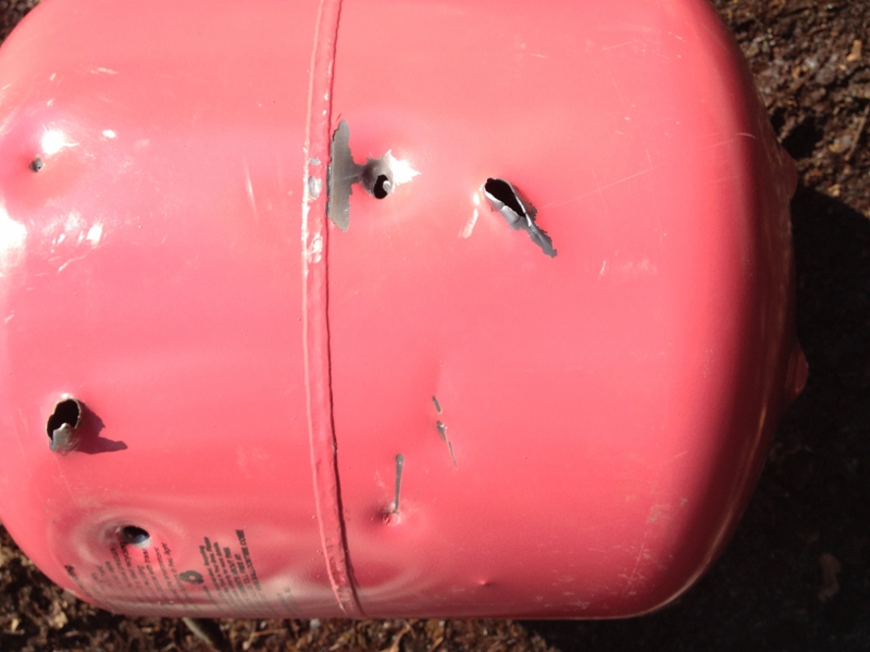

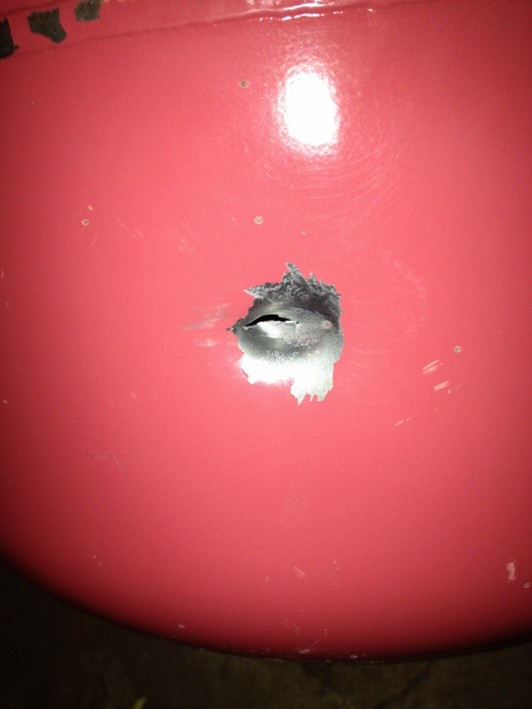

.22lr bullet fired at empty "party time" disposable helium tank

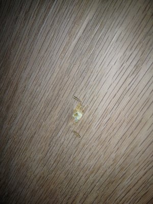

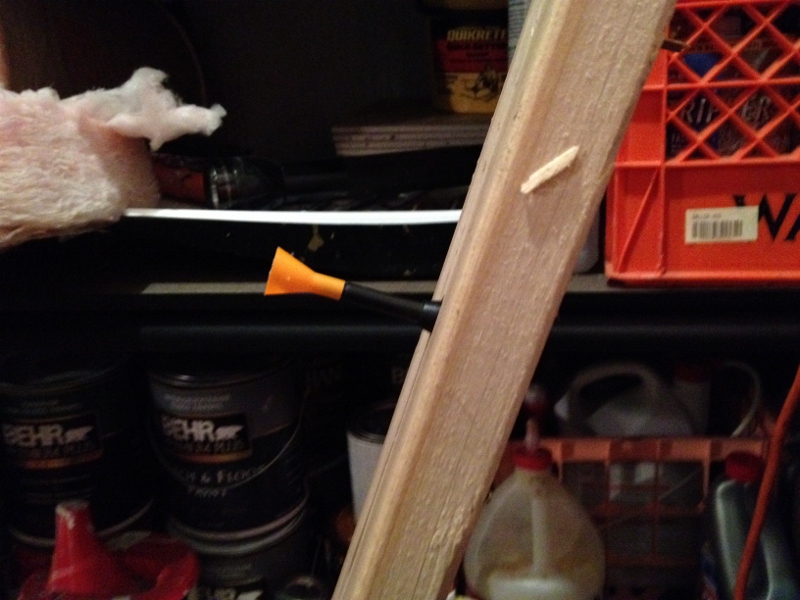

Shot above same dart, but through the wood.

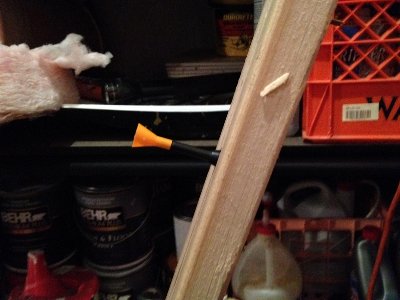

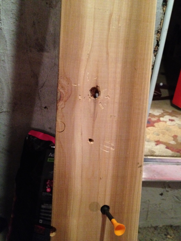

3 gram plastic dart from cold steel into 3/4" wood.

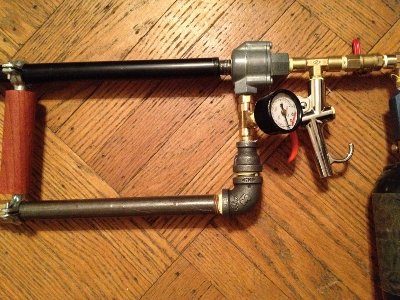

QEV, handle, etc
QEV, handle, etc

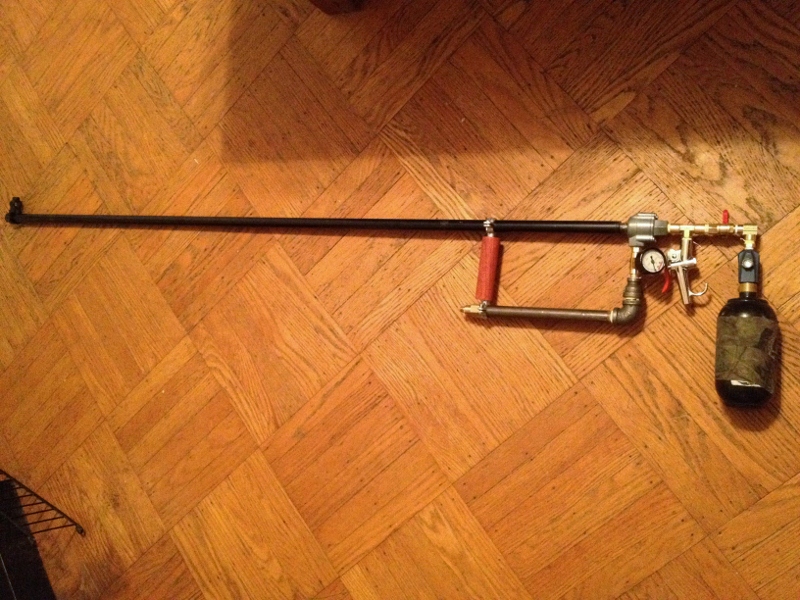

First Pneumatic, "final" (we'll see) version.

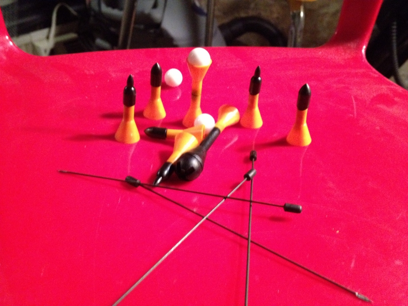

100 grain field tips, flechettes, glass shot, sabot and 3 gram plastic darts.
Fri Feb 08, 2013 12:28 pm
Nice work for a first cannon, some very impressive penetration, kudos!
SweatNTeflon wrote:How do I make this thing more powerful and more accurate?
A QEV is essentially a piston valve, so if you have a go at making a home-made one it's unlikely you'll get better performance.
The easiest way to up the power is up the pressure, and try and reduce the pilot volume (area to which the blowgun is connected).
You can convert this current device to semi auto or full auto by changing a few parts around, have a look through this thread: http://www.spudfiles.com/forums/semi-au ... 23626.html

Nice cannon. I like how you used the casting protrusions at the top of the QEV as the rear sights. If you like jack's work, you can also implement an adjustable one pretty simply as well. :wink:
As far as the pilot volume goes, GGDT assumes one-way flow past or through the piston... that is, the valve will pilot with ANYTHING. QEV's 'cup piston' works as a one-way valve, so you should be able to pilot it with anything, although there will be a delay in piloting and a slightly slower opening time, as there will be more air behind the piston slowing it and a smaller orifice for that air to exit. A larger pilot with less pilot volume ensures as little delay between the pilot and piston opening as possible, as well as keeping pressure behind the piston from rising as it moves backwards.

I'd be a little concerned about 1/8" fittings breaking with normal wear and tear (not pneumatic functioning, just getting knocked around).
As long as they're not made of paper I wouldn't be too concerned.
Upping the PSI, yes. I've shot it at 600, but I am just uncertain about running that much pressure through a QEV rated at 125. I have seen 150 rated QEV's, but nothing higher (unless you are talking oil drilling platform hardware). Any leads on a sturdier QEV?
QEVs with metal bodies can usually take several times their rated pressuRe without flying apart. The usual weak point is the piston or diaphragm. I would take the valve apart, and see what can be done, either beefing the existing parts up or replacing them with something more hard wearing.
SweatNTeflon wrote:Also, is there any issue in hooking up a 125 psi regulated CO2 tank, leaving the ball valve/fill open to achieve semi-auto mode? Perhaps a bit wasteful- but otherwise?
replace the blowgun and ball valve with a Three way valve, see the link in my previous response - not wasteful at all, as the feed from the main tank is automatically cut when the valve is in the 'fire' position.
Netherlands
Posts: 3497
Mon Feb 11, 2013 2:39 pm
Mod the QEV instead.
Poke a tiny hole through the diaphram between the valveseat and the outer rim. stay away from the center..this is what seals the valve..
This mod will make the pilot repressurise after the blowgun is shut, really fast I might add.
If the valve doesn't have a core-spring to aod the diaphram put in a small spring that will push the valve shut..
The blowgun can now be hooked up directly to the pilot port and the valve will pop open and reshut at every triggerpull.
You won't need to fill from the back...so
Put that large tank under the barrel as your reservoir/chamber.
You won't need a secondary chamber anymore.

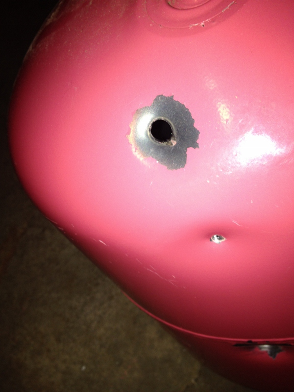

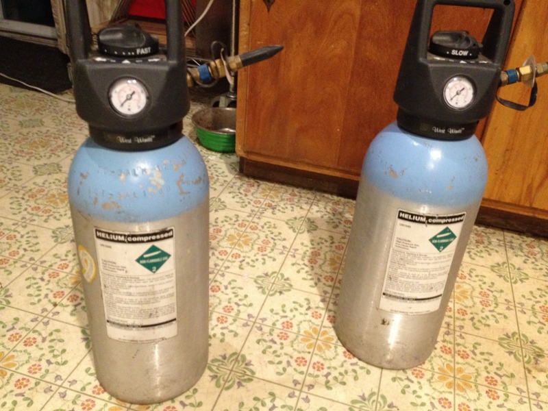

Here are the damage pics of a 100 grain field tip fired through a disposable helium tank. At 600 PSI they go through both walls. As I am unsure of wall thickness, I will shoot at measured steel sheets next time
100 grain projectile at 600 psi. Exit.
Tue Feb 12, 2013 1:36 pm
Very nice damage :) Brian's advice is sound but if you want to stick with standard parts a three way valve is your ideal solution for semi auto.

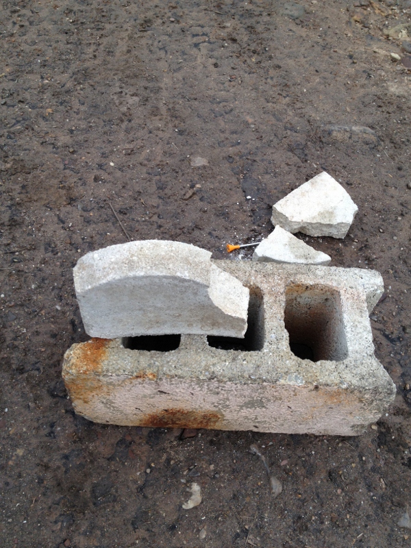

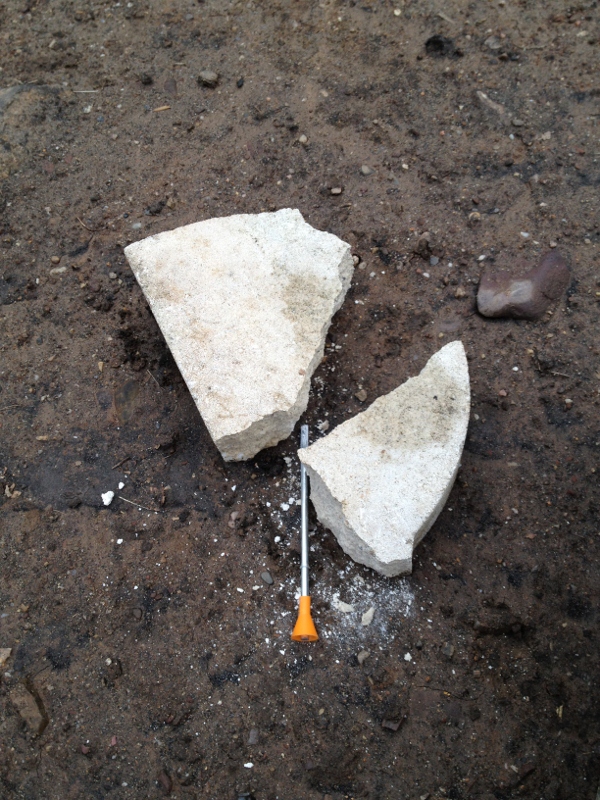

Damage pics of an 18 G steel rod projectile hitting a cement block. It didn't go through it (like a 12 gauge would), but it did break it.... Not as reliable as testing through standardized metal sheets, but I was still happy with it.
Why don't more people use the Big Bore Blowguns as barrels? http://www.coldsteel.com/Big-Bore-Blowguns.aspx
It seems like a good idea considering it comes with ready-made ammo & sabots.
Has anybody made a .50 cal pneumatic from a muzzle loading off-the-shelf barrel? I was thinking of that. You'd get a rifled barrel and .50 cal projectiles are cheap and abundant here is the States.
BTB or JSR- could you provide a link to a thread about modifying a QEV for semi-auto (poking a hole in the diaphragm), please?
A bit off topic- I'll be moving to Japan in August. Airguns that "fire metal" projectiles are illegal, but I was wondering if anyone on SF has lived or is living there??
18 gram dart vs cement block

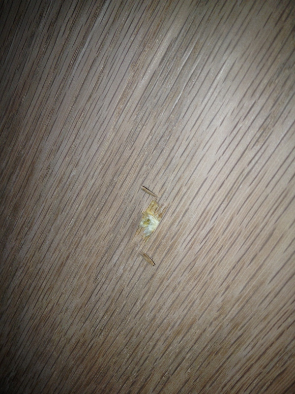

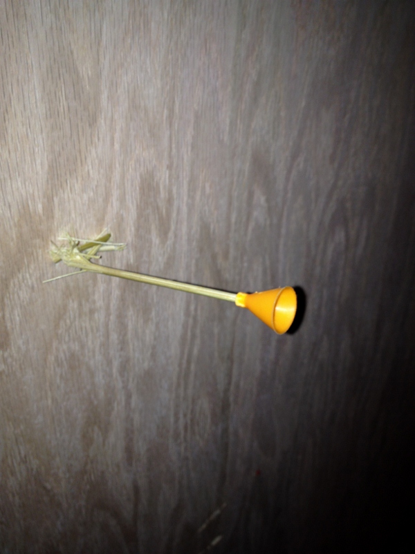

Pretty amazing that a disposable bamboo kitchen skewer goes into 3/4' plywood.....

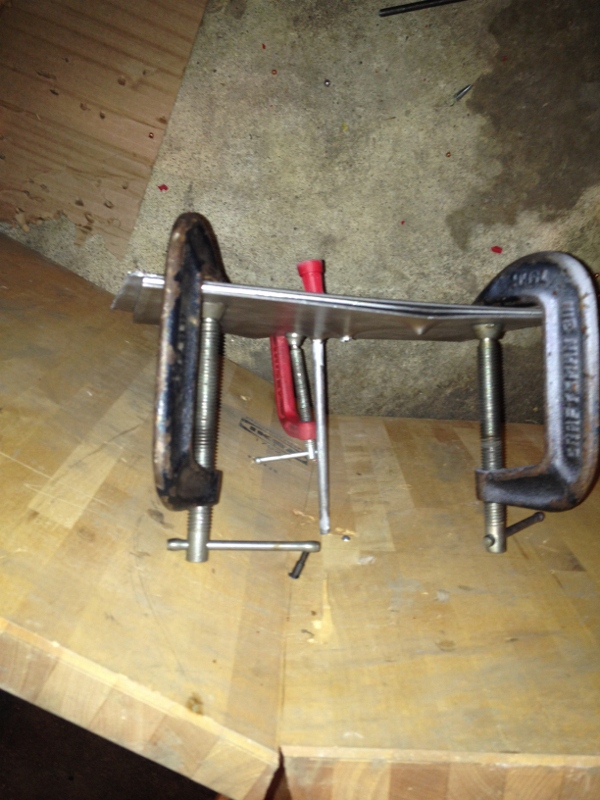

42g dart through 3 sheets of 12 gauge steel (1.52mm each, total of 4.56mm)

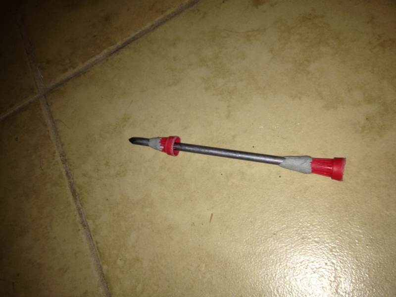

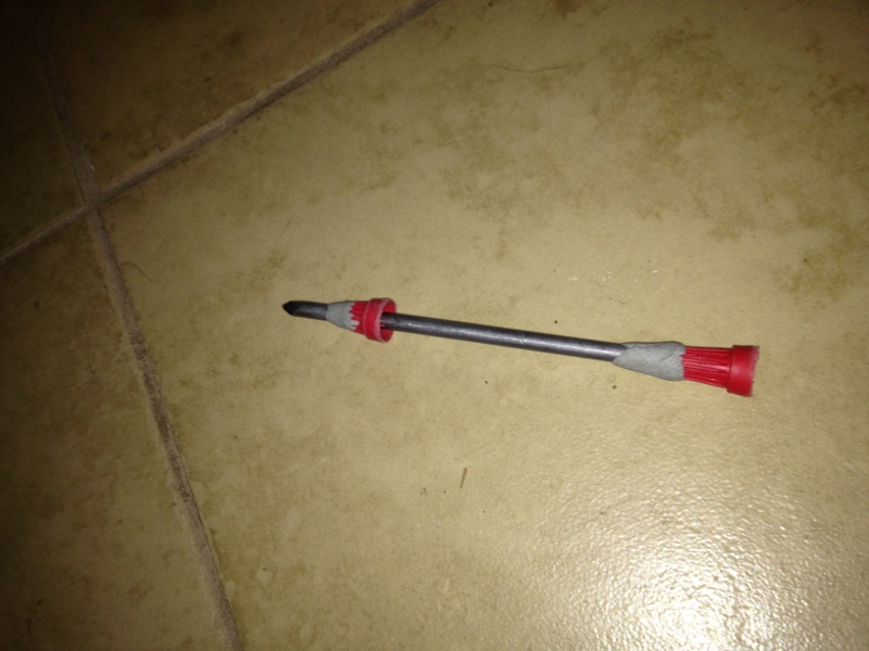

42g steel projectile with wire nuts as sabot. And that IS binary epoxy. I named him "Jack The Ripper".

Dual QEV valve set-up.

Good stuff, impressive penetration and nice to see those sparks flying :)
