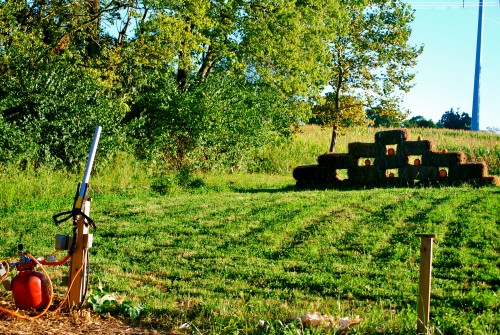

Recently took the kids to a corn maze and low and behold they had a corn cannon and being boys they now want one.
It was pretty cool firing 1/3 of cob at targets 75 to 100 yards away.
So to make the long story short, looking for plans to build a corn cannon using a propane tank, safety switch and piviting swivel base, any help would be greatly appreciated.

My 2 cents. I've been on some football fields and I have been on some corn fields. I've loaded hay trucks. Unless those are 1 ton bales and those are 500 lb pumpkins, the distance in the OP photo is closer to 35 yards.
That cannon mounted on the post is a commercial product sold to farms who have corn mazes and are limited in power. Youtube has several videos of them in use. Google the cannon videos.
Sample video of that model in use from a quick Google search.
Not sure why, but can't get the video to load poperly in Spudfiles today.
In another video I just watched, they spec the range at about 200 feet or only 67 yards.
