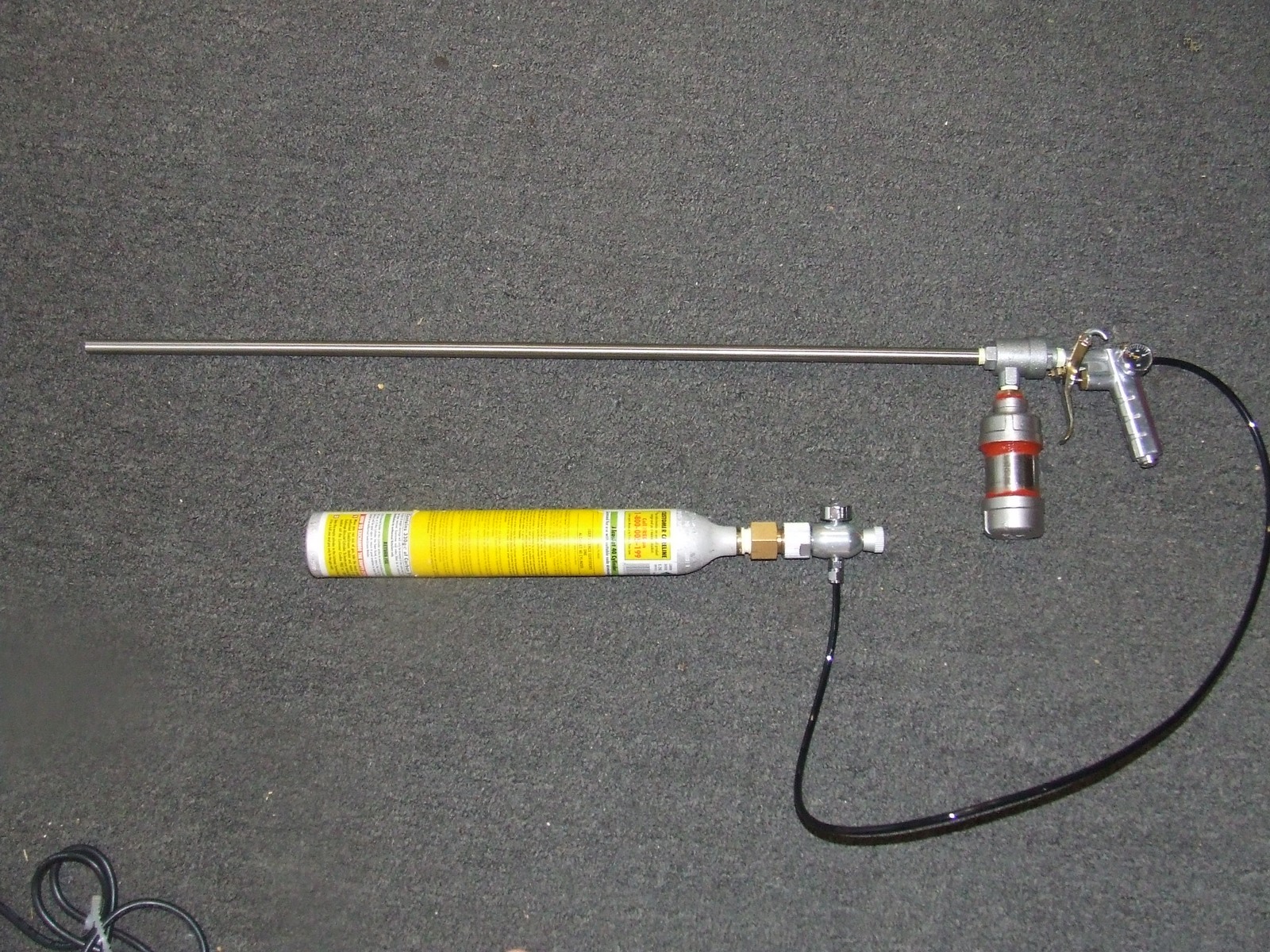

Finished this today its about 4 months in the making.. Combination of laziness and a few issues that came up.
I started off wanting to build this as cheap as possible, and even though it did ultimately cost me more than I wanted iv'e got a bunch of spare parts plus it actually works better than expected so I'm happy. Nearly everything for this was bought from fleabay and should be easily available to anyone, the only parts I got locally were the barrel itself (which was quite cheap (IMO) from a local metal supplier) and the co2 cylinders. The only thing that I couldn't do by myself was getting the 1/2" thread put onto the barrel which I asked family member to do for me, he tried to explain that the 1/2' thread I wanted was near impossible to get as a simple die so he turned it on the lathe, I have no idea if this is right I could swear I have seen a 1/2" die myself, but who knows, anyway it just worked out easiest for me. Its something most metal shop can do and I assume it would be reasonably cheap.

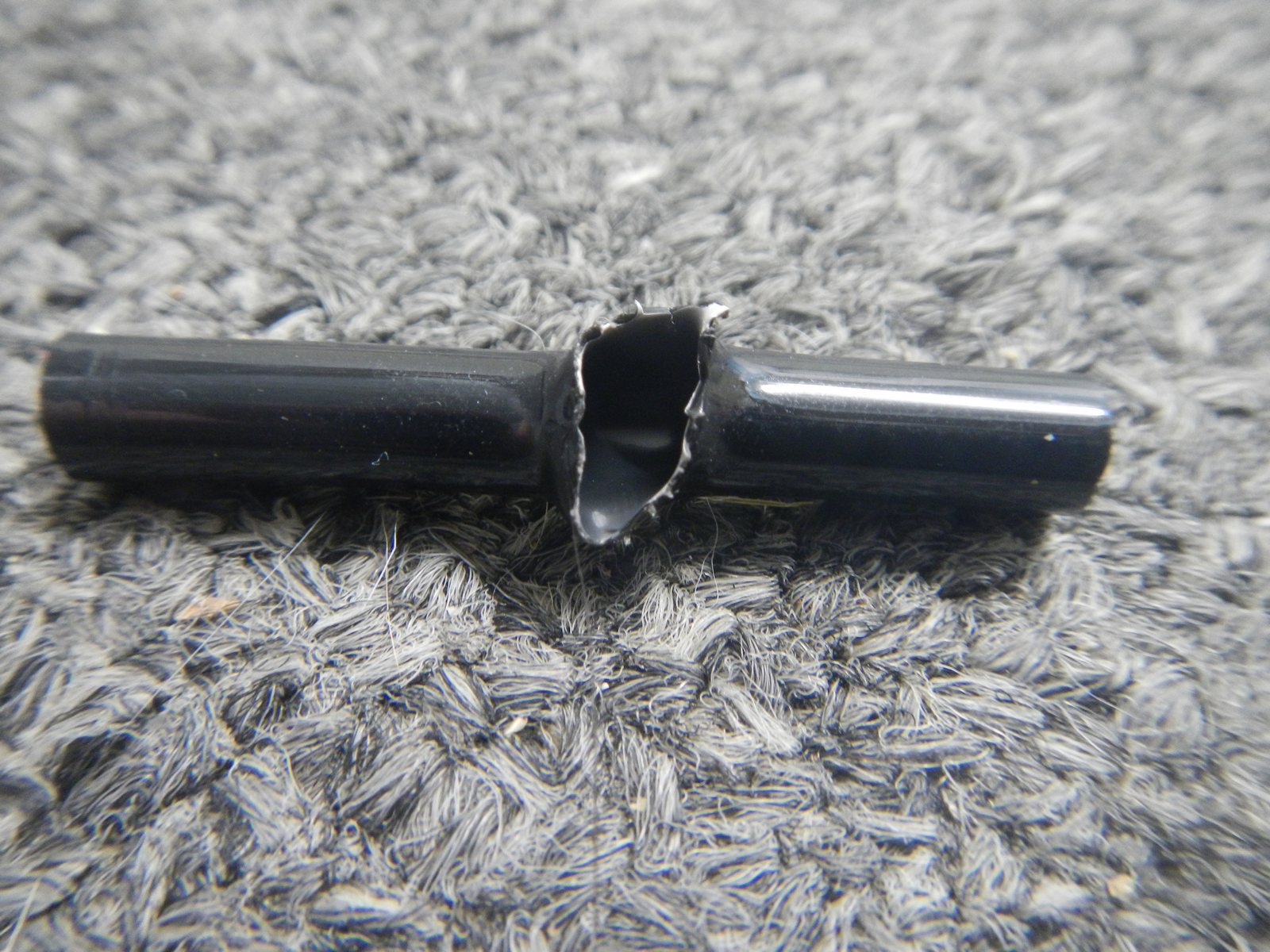

$5 - 3m Co2 Proof Tubing Polyurethane Air Pipe (is NOT 'Co2 Proof' picture proves I found that out the hard way!!)

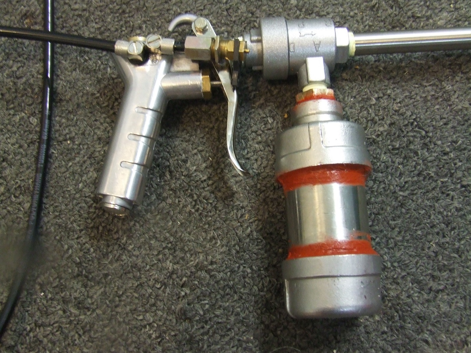

Basically I have it set up like this:
Co2 Bottle->Adapter->UP Regulator...

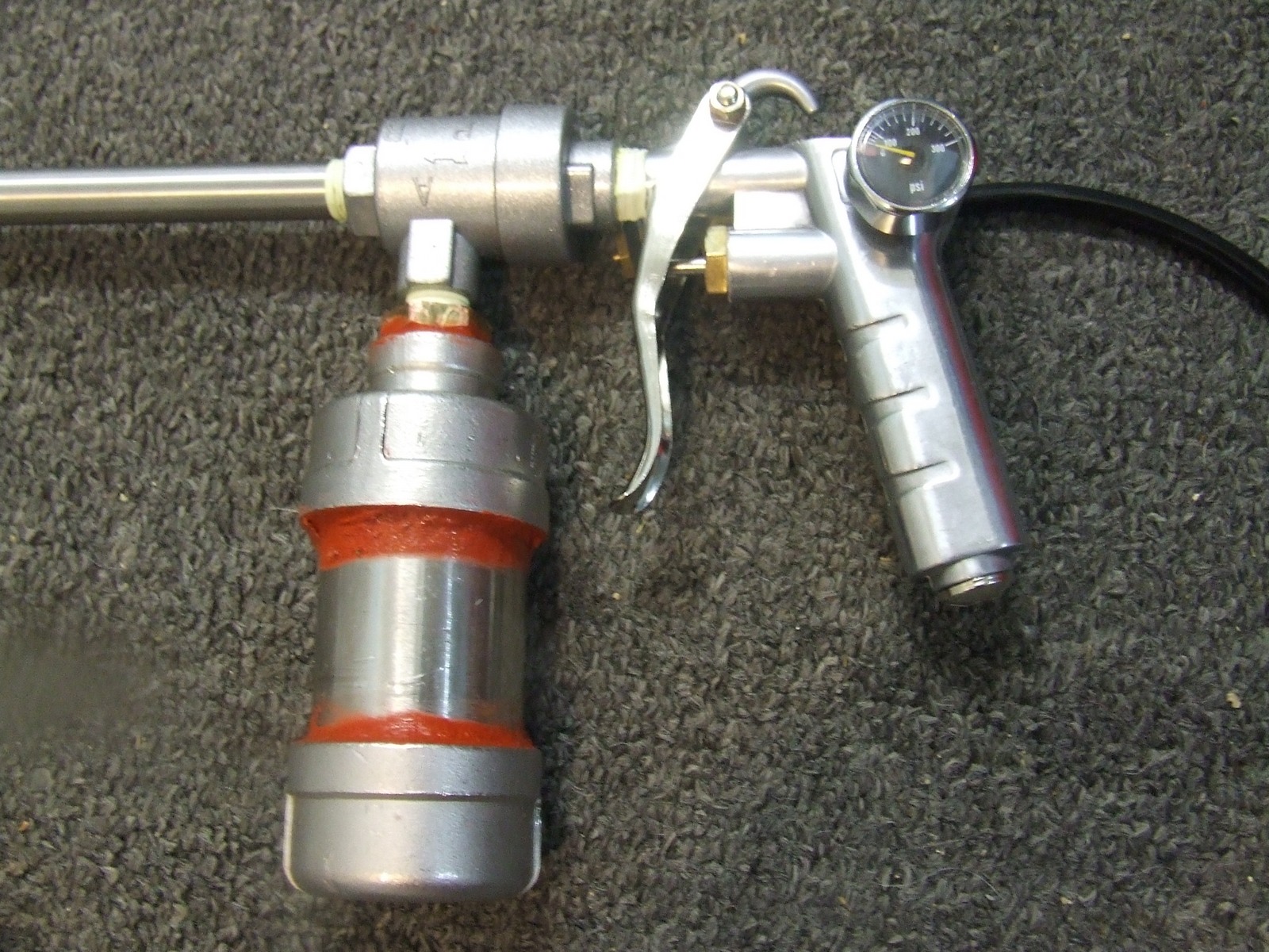

The hose connects the co2 line from the regulator to the 'back' side of the duster 'gun' the PSI gauge is also on this same inlet side. The QEV is attached in line with the 'gun' with my tank on the bottom (tank made from the 1-1/4" Stainless threaded Pipe Fittings I bought) and then of course my barrel which right now is muzzle load not that its really a bad thing for me.
The last part is the little mod I did with the air compressor switch to make the finger trigger release for the QEV. ... Basically this is the little air pressure switch that turns electric compressor motors off and on. Its just a beautifully simple little switch that works perfectly as a release/trigger to dump the air out of the QEV.
So realistically I have two triggers, the original one you see on the duster gun which primes the QEV tank and gets it up to pressure, I then release that one and its ready to fire with the small push switch attached the short length of co2 tubing positioned perfectly for my trigger finger, very little pressure or movement is needed to actually dump all the air from the back of the QEV and fire off the pressure and very little gas wasted.

I did use safety glasses for the testing phase, although in hindsight probably should have also used some heavy gloves and hearing protection..lolz, Last night I scared the life out of me and the mrs (oh also the cats) when the co2 'proof' hose burst at ~500psi.
The cheap hose I bought from ebay obviously needs to be replaced with something like proper paintball macroline, don't really want it to burst again that once was enough for my ears.
It takes 8mm rounds which is basically the same as size 0 sinkers so I was thinking of just getting a sinker cast and making my own rounds on the cheap. It also needs the little scope to be mounted somewhere. The one thing for me was I wanted the heaviest part (tank-adapter-regulator) to be carried remotely on a belt clip or similar to make it as light as possible that's why I made it as a 2 piece.
My QEV seems to work fine at 200psi so far (which I think is already over its 'rated' capacity but im not sure how long it would last with any more pressure) I have the 600PSI gauge if I ever do make up something that can handle more.. I also was pondering about a loading mech, perhaps I could have a feed load T piece setup with some type of O ring as a retainer, Im really not sure yet (suggestions would be great if anyone has thoughts) might just keep that side of it as is though haven't really decided.
