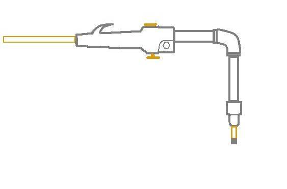

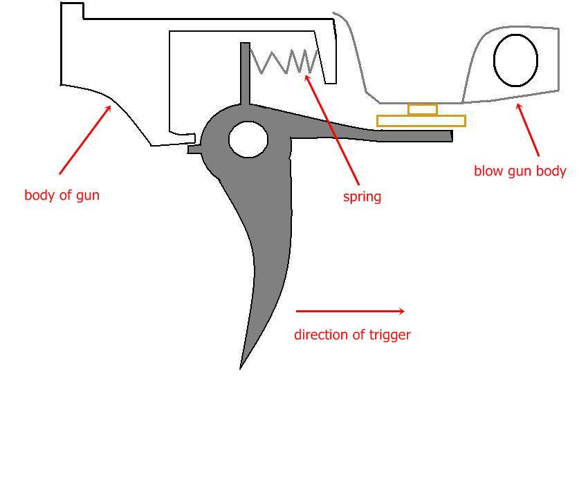

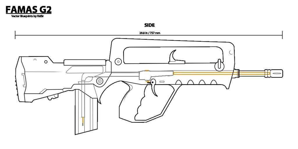

if this is your blowgun you can make a trigger system like this
and then put the blowgun into another body of a gun, i used a FamasG2 in the pic but it can be a pistol or any rifle you want
i can't accomplish my dream of making a M82A2 design pneumatic gun because i cant make the M82A2 body :( but i think a body of FamasG2 can be made out of wood to put your blowgun inside making your pneumatic look realistic

Talk that is an interesting idea, however I was thinking for some of my other pneumatics I was maybe going to make wooden grips/stocks for them, as I don't have any airsoft gun bodies I'm able to use right now, but I have lots of planks taking up space.

In my experience the blowgun can take around 500 psi safely without leaking, though it does become progressively harder to open, so Talk's idea for a trigger is one that would make sense.
