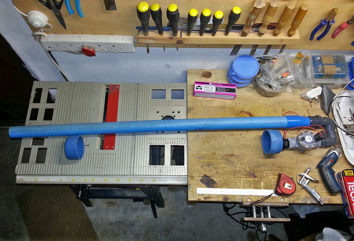

Sat Jul 26, 2014 1:02 pm
I'm busy building a similar setup. What sort of range are you getting with the 2" barrel?
