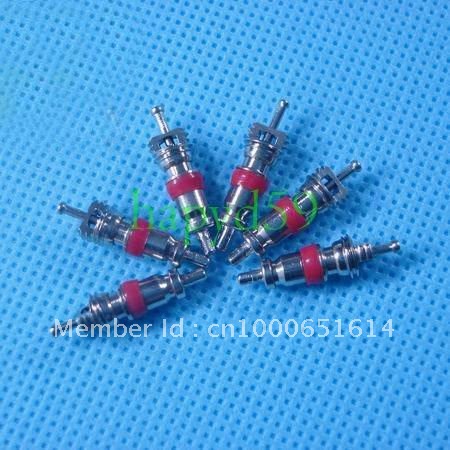

Removing the core from the schrader before soldering would have seemed fairly obvious. Now that the core is fubar'ed, go to the auto parts or bicycle parts store and purchase a replacement core and the tool to change it.
Many different tools to remove the valve core, and whatever store you go to will likely have at least a couple options. This is about as simple as it gets...

That was my initial thought, Gippeto, but I was under the impression that the valve body itself has an o-ring in it. I guess I was wrong?

No o-ring in the body of a schrader valve...all seals are part of the core.mako wrote: I guess I was wrong?
So...yes.

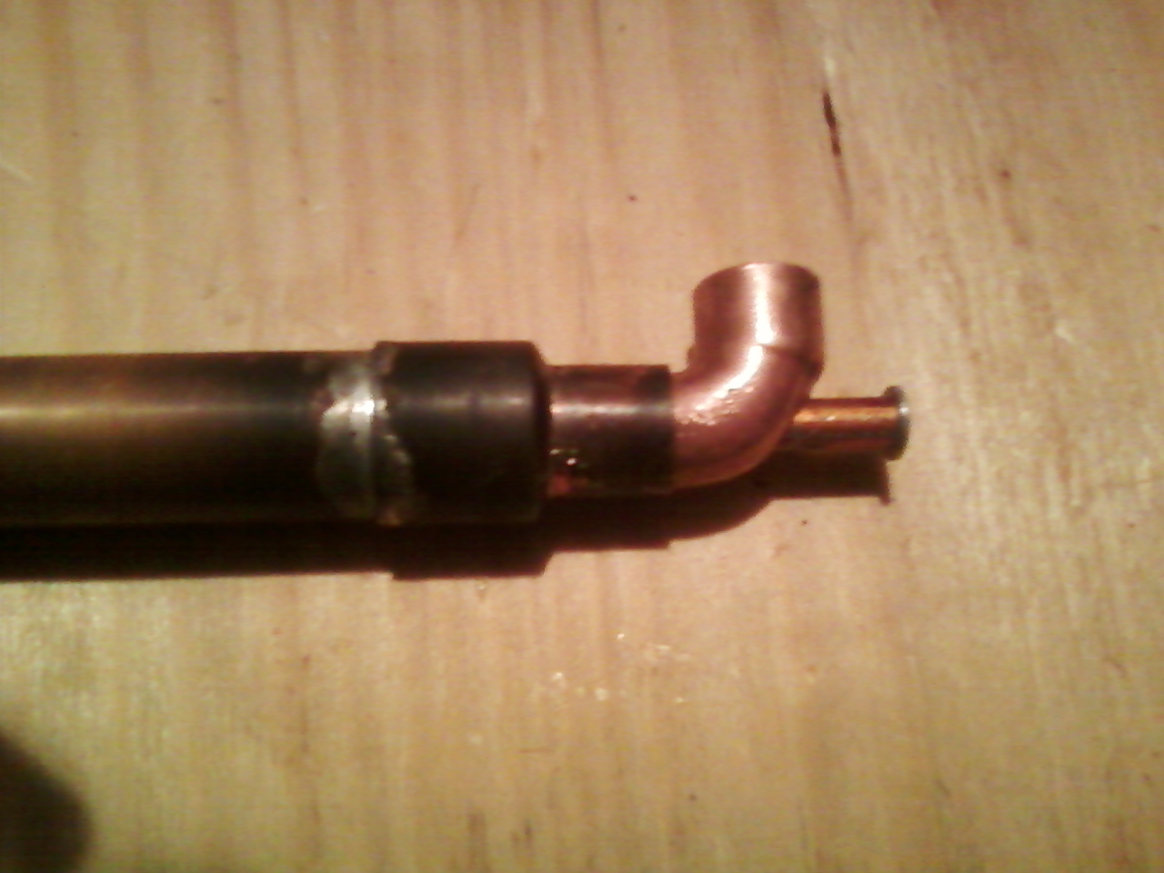

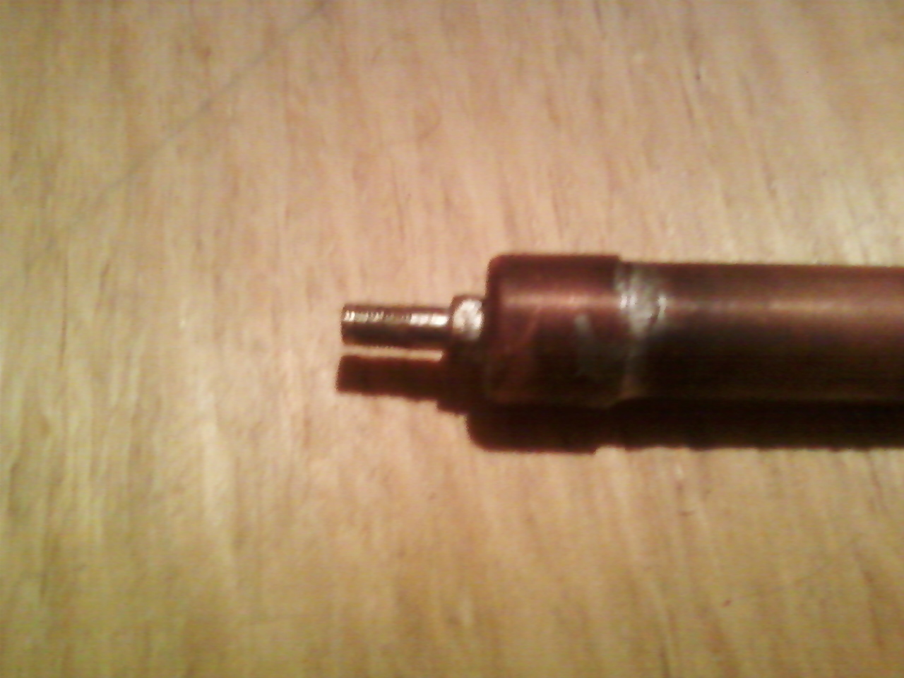

An interesting problem I've been having with this valve, by the way. The opening on the reducing joint was bigger than I wanted it to be, so I soldered a washer into it. Worked great, until time came to solder the reducer to the pipe... when I did that, the solder on the washer melted. I DID get this fixed, but it got me wondering... there are solders with different melting points, right?
So, could I have used a high melting point solder to hold the washer and a lower melting point solder to join the pipes? The idea being that the lower temperature wouldn't melt the washer free.
(It's always that 'slim chance' that gets you, tho, isn't it

There are indeed solders which melt at higher and lower temps. The issue with using the higher temp solders (brazing solders, silver solders) is that the temps required will anneal the copper...lowering the working pressure.
Best to avoid this scenario if at all possible...careful planning is key.

I hadn't thought of that. I didn't know copper HAS a temper.
Yeah, I'm starting to see that. The planning angle can really save some swearing and money, eh?
