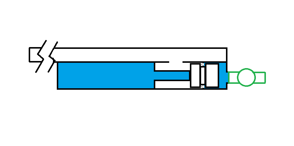

If I were you, I'd got with JSR's proposal, the dead space in the current system is huge.
If you want to keep the breech load while increase the muzzle report and recoil, you can consider making a chamber seal piston valve, might be overkill for that caliber tho.
Made a quick paint to demo what I was talking about.

Hey, appreciate all the responses. Bigger expansion chamber seems to be key here. Problems with piston valves is they seem to be more temperamental when it comes to abuse. The gun takes alot of vibration especially when driving.
PVC expansion chamber is out of the question. Not allowed on most fields due to safety hazard of over pressurizing. I may try to reconfigure the expansion chamber closer, as well as lessen the amount of pipe in between as suggested. I believe if I keep the hydraulic line but put the sprinkler valve after rather then before should will allow for a bit better air pressure as well as allow me to integrate a rail for sliding recoil.
I will try to post a sketch of a possible design for further overview.
