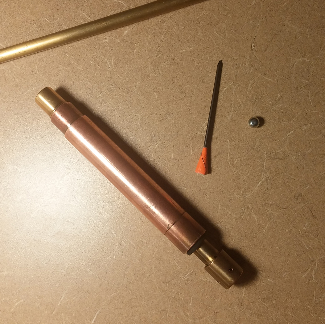

Thanks again to the SF community and a special shout to JSR for all the great info. This is my first non-ball valve pneumatic. It's a barrel-sealing piston and let me just say that, after 10 million tries to get that damn piston to work, it was the most satisfying sound to finally hear it slam back.

Like . Perfect for country walks
- Posts: 26179
- Has thanked: 543 times
- Been thanked: 321 times
Extremely well done, love the can shot!

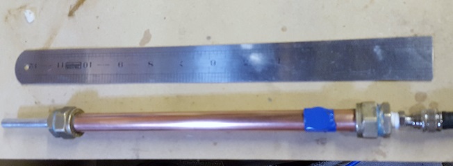

Well folks it finally works and just to show that it is some what like the Snipe Stick I'll add a picture. The blue tape is holding on a magnet I thought I would use it to keep the firing cap safe but it is brass , oops! This thing is so powerful at 150 PSI it wrecks old dvd's and went through a milk bottle and two thick cardboard boxes wow it packs a wallop, it's a bit scary really how powerful it is . I used a blue thread sealer on the joints that works great a 50 ml tube is about £2.50 from tool station, it is way better than PTFE tape and drys quite fast.
Thanks for all the help now it's off to build a bigger onehttp://www.spudfiles.com/posting.php?mode=reply&f=1&t=26349#
Regards
Gary
