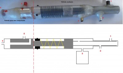

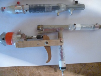

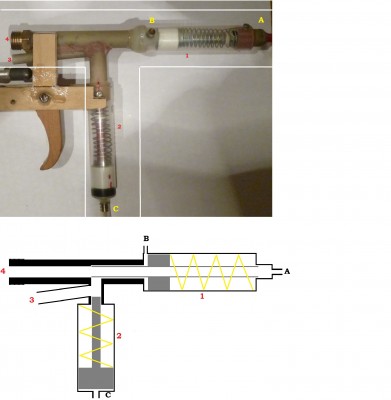

Hello everyone !
I have built this basic model of a system for a future weapon. It works at this present time, with compressed air at 4 bar, but it would be possible to feed a definitive version with CO2.
It is not really a weapon, just the test system, but functional. The final version will be the same design with other materials, which will be able to withstand the pressure of about 20 bar.
The good: It's a lot of fun to shoot to play. The bad: the ammunition cost is extreme, so I have only used it in the experiments, recovering the ammunition, in a controlled environment, and not giving much pressure not to deform quickly by the impaction the ammunition. They are spherical .22 caliber of lead.
The food is with the small compressor of my 25 liter workshop, which is what I have available.

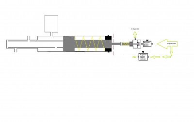

Upload a short video to youtube that I leave here. I will make the corresponding diagrams shortly and I will upload them here.
The experiment fires with two modes in automatic, mode 1, twelve rounds per second, and mode 2, 5 rounds per second. Also fires in semi automatic.
The idea is to do something similar to a replica of air soft, but with heavier ammunition
. I've thought about using 3/16 "or 1/4" steel spheres, we'll see.
This model is built with syringes of various types, fiberglass, and ordinary materials that I have in the workshop.
Soon I will upload more photos and diagrams. Best regards
