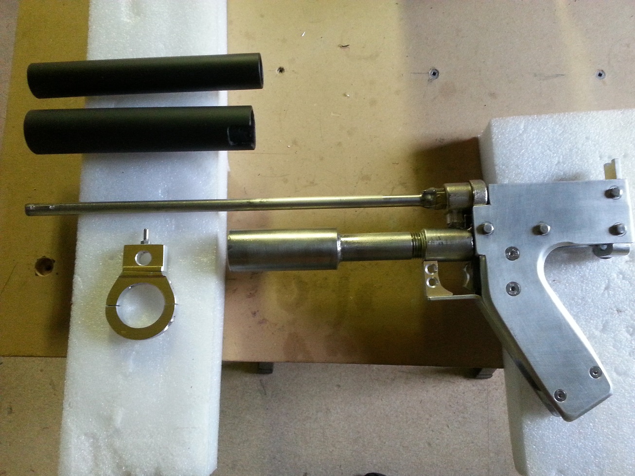

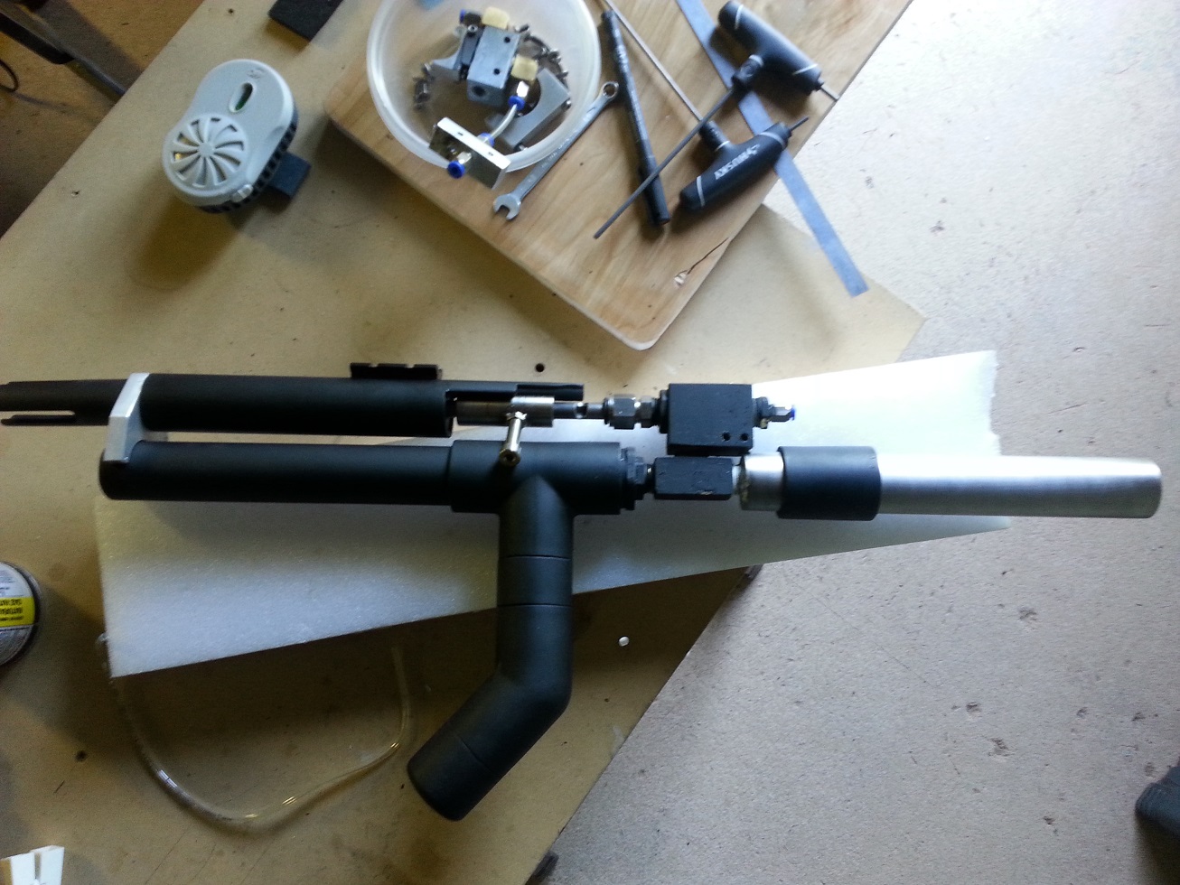

Fri Mar 29, 2019 4:01 am
Over under like this works fine
Or chamber to the rear (front is just PVC)
