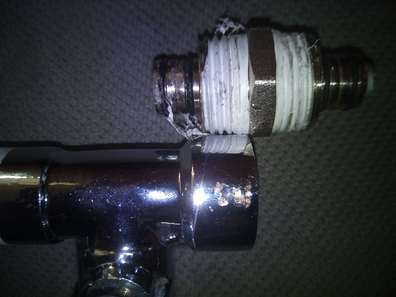

Hi guys , i need yours help again yee. I wanted to build qev valve beacuse they are expensive in my country :( But it leaks and dont work

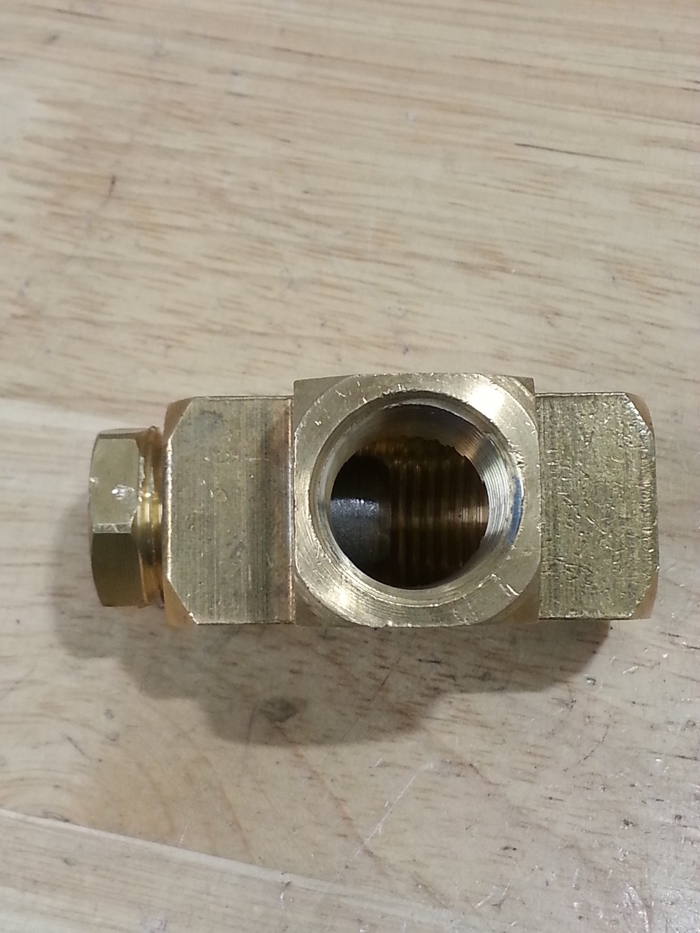

Thu May 02, 2019 3:43 pm

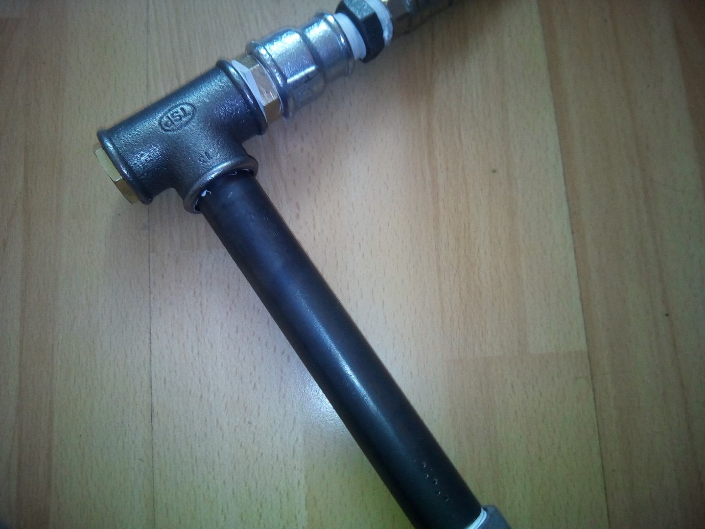

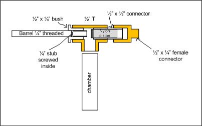

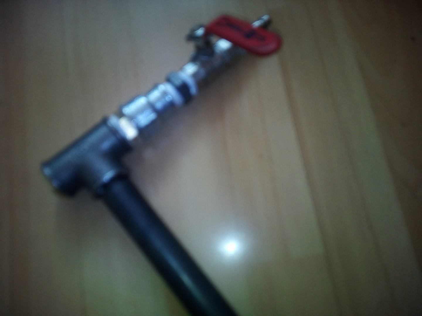

I made a QEV with a 1/2" T and it works really well
QEV 02.jpg (12.17 KiB) Viewed 6828 times

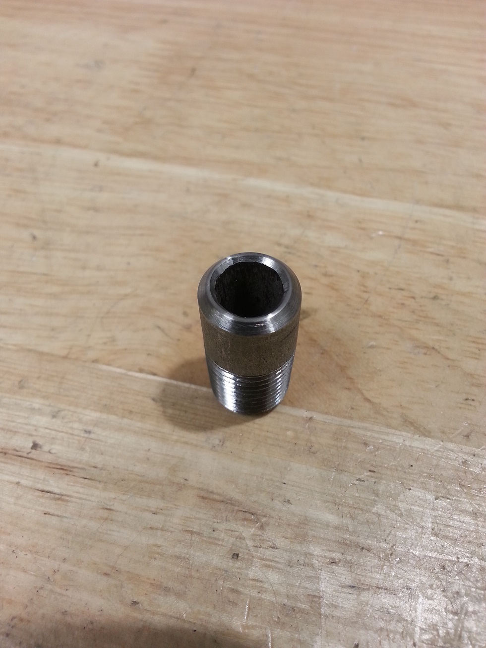

This is the sealing face, I turned it in a drill press and used a file to shape it.

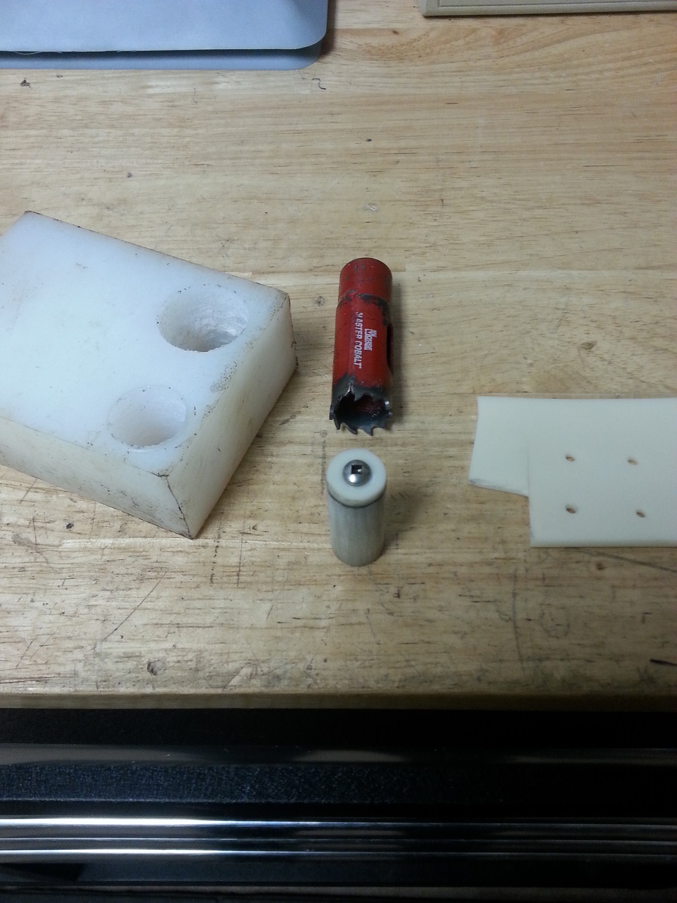

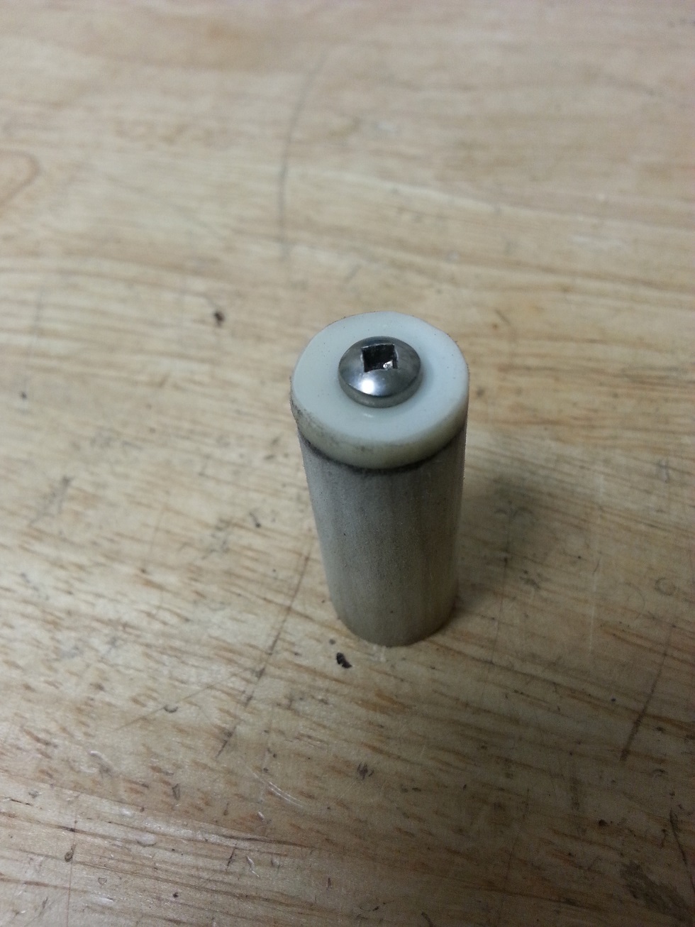

Piston is made from a nylon block with a hard rubber face.

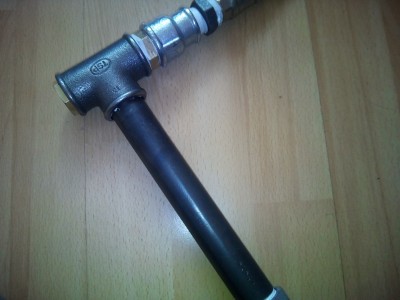

Fri May 03, 2019 5:14 am

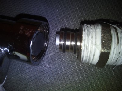

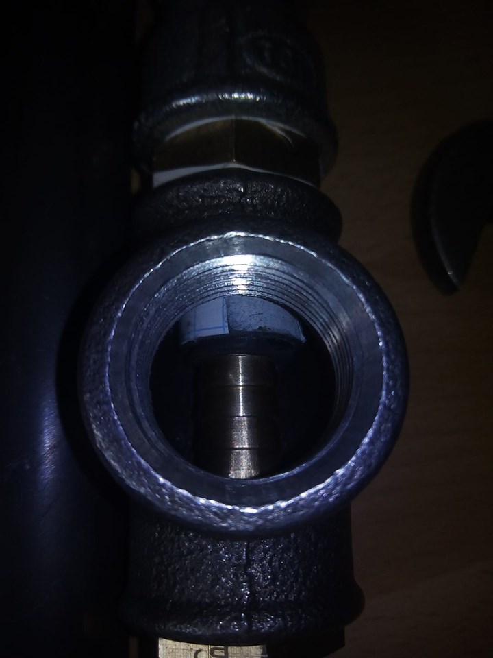

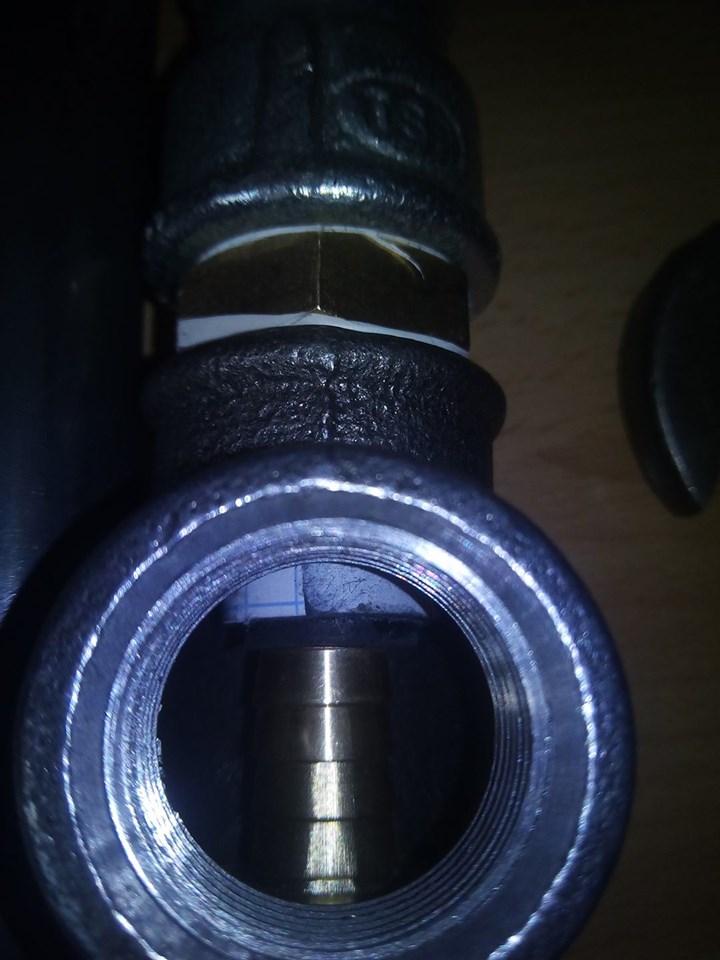

I polished the surface and nothing its leaks , but maybe the problem is that the sealing face is too short? idk

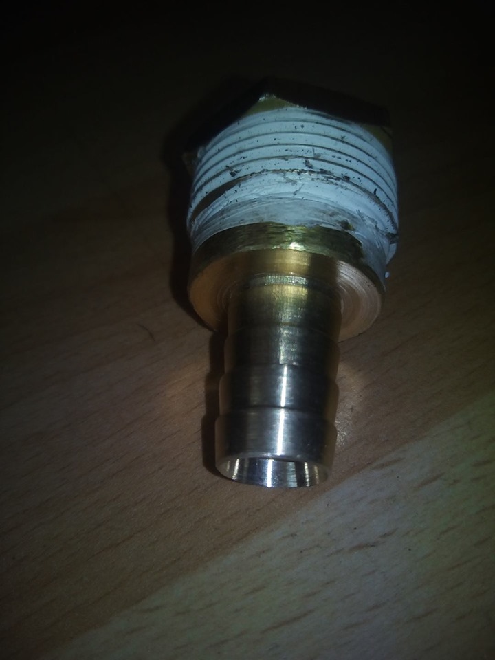

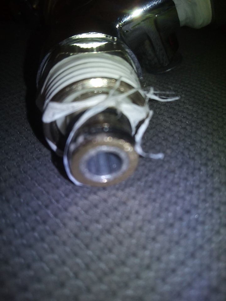

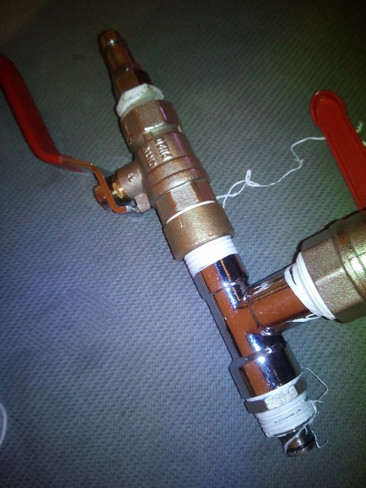

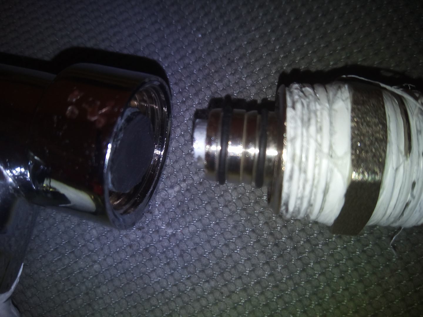

Sat May 11, 2019 10:28 am

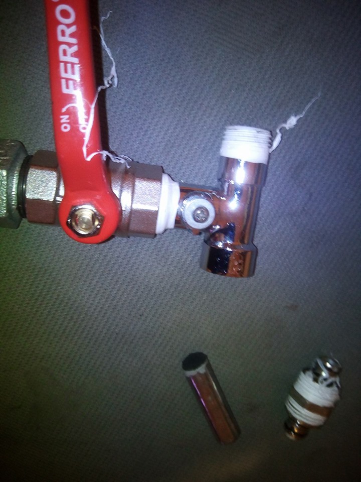

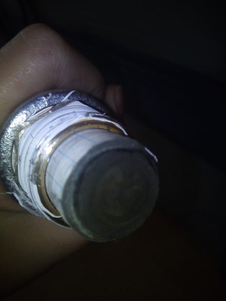

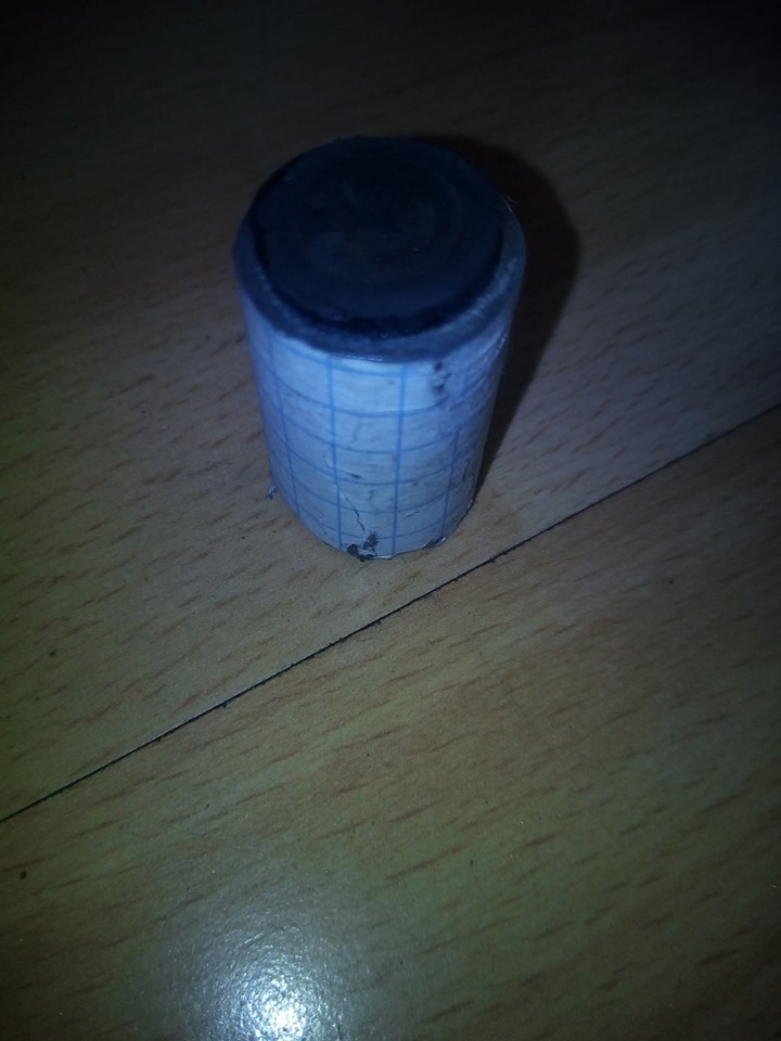

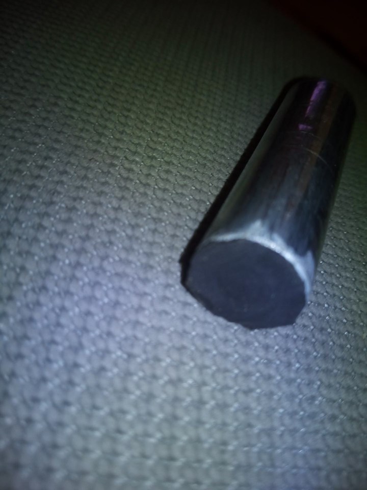

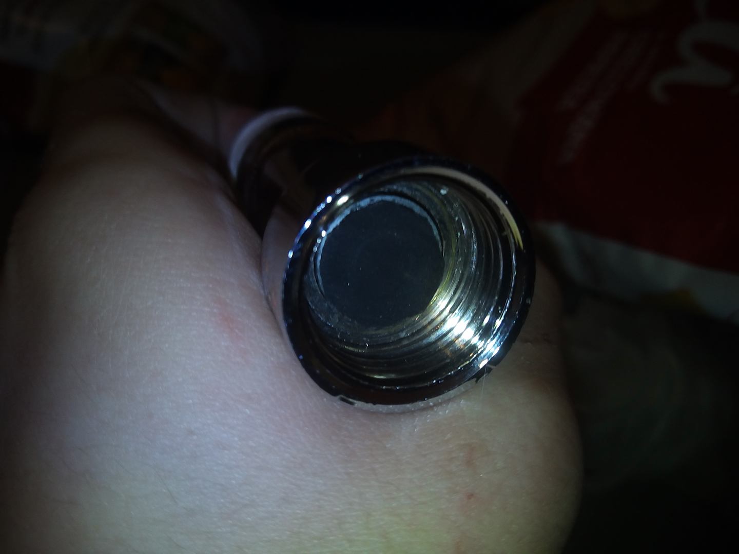

I made something similar to this QEV , My piston is made from hot glue and rubber washer glued , and its slide easily in the nypel . But when i am trying it , air flies out from pilot . Air is little escaping from port R (exhaust?)

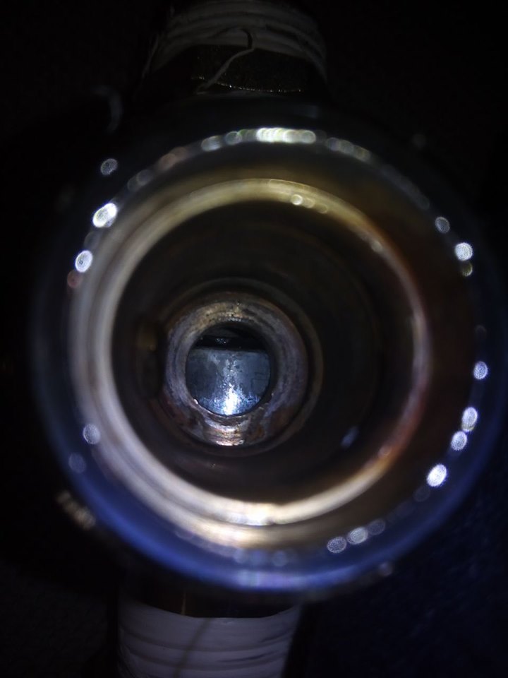

Sealing face
Sealing face
Piston
Piston
Sun May 12, 2019 4:51 am
Haniball1337 wrote:But when i am trying it , air flies out from pilot . Air is little escaping from port R (exhaust?)
When this happens, it's usually because the piston is not tight enough in the tube it is traveling in. Try wrapping it with tape until it is snug.

Sun May 12, 2019 7:46 am
I did that , piston is little snug it works but very poor , its not loud and air leaks from the exhaust port so i have 6 sec to shoot untill air escape
farcticox1
Posts: 1082
Has thanked: 69 times
Been thanked: 98 times
Sun May 12, 2019 10:02 am
Sounds like it is still not sealing on the rubber face

Sun May 12, 2019 10:16 am
The sealing face is polished and sharpened

Tue May 14, 2019 8:40 am
Try softer rubber on the seal face.They sell this white "kinda foamy" sealing. Then maybe a slightly more powerfull spring that pushes the piston. And to prevent leaks, you may use epoxy glue instead of teflon tape on some threadings (which need not be dismantled for servicing or testing).
