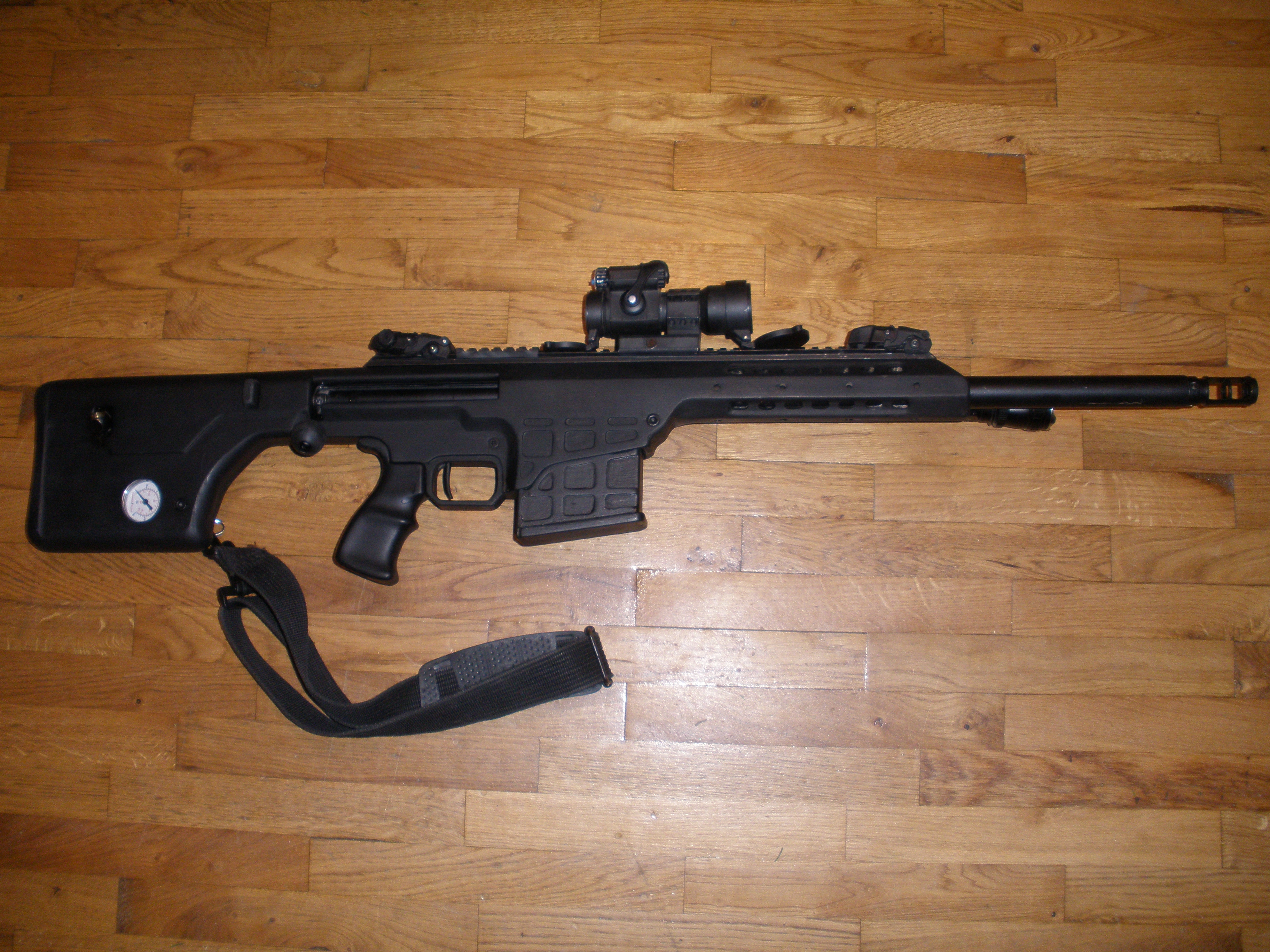

This will be used for my last build, the Barret M98b replica. Unfortunately I can't find the old showcase post, as if it's been deleted, so here are a few photos. Some of you might remember it

You could ask the same why I designed and made my last airgun, the M98b. It was a very complex project involving a QEV design using a piston with a built in check valve, full 3D model of the wooden stock, safety system separating the valve and barrel, hammer valve trigger system as the pilot valve, etc. I could have easily purchased a commercial airgun, but that was not the point. I enjoy solving problems like this and fabricating something I designed myself, using minimal machinery / tools. For me the point of this hobby is in that journey, from design to fabrication and not so much in the usage after the fact.
The regulator in particular is something I’ve been thinking about for a long time, but didn’t know anything about fluid mechanics until I had it in a university course. I’m still missing some understanding of seals/O rings like I mentioned and this is why I’m asking for help. I’d use it first to regulate the output pressure of a external tank, but this is not some immediate need. After I gain more understanding and some experience, I’ll consider having a integrated regulator inside the rifle air tank which would keep the pressure constant (increasing accuracy) and prevent overpressurization (because of gun laws).
As for the cost, it would definitely be more expensive buying a commercial regulator because I already have all the materials, tools that make fabrication possible, large variety of O rings, fittings, etc. Also because of my stockpile of stuff, I’m more in the mindset of "what can I make with what I have by being creative" instead of "what do I need to get to make this system function by throwing money at the problem". The engineering concern of balancing man hours vs cost or complexity is not at play here. This is just a hobby I enjoy and not a engineering project office environment.
