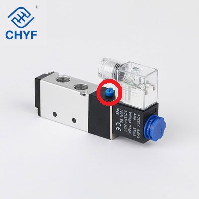

I wonder if the solenoid valve also needs pilot air to operate and as it starts to dump theres not enough pressure to open it. I have blocked and redrilled pilot ports before so the solenoid part always has full pressure. If the valve has a manual actuation button on it have you tried firing with that, might give different results.
