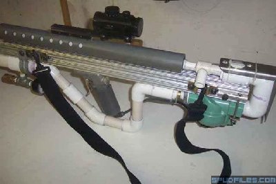

I am now to pneumatic guns and i am interested in making a airsoft gun with a close design, and i have questions! lol plz help. also plz dont get mad at me if i use your picture. *NOTE: NONE OF THESE ARE MY PICTURES!!!*
The picture is attached.
what is the green thing???? whats it for?? ive always wanted to know...
ty
WHAT IS THE GREEN THING PLZ!!!

that would be a sprinkler valve.
it is used to hold the air in the cahamber until you press a button or flip a switch or something and then it releases the air into the barrel, forcing the projectile out. you can even modify these valves for pneumatic actuation which creates a faster opening time, resulting in a much faster speed of the projectile.
