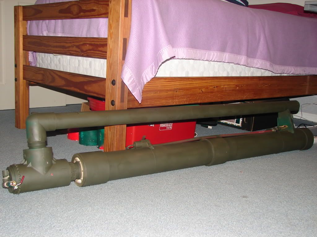

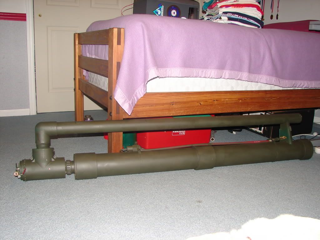

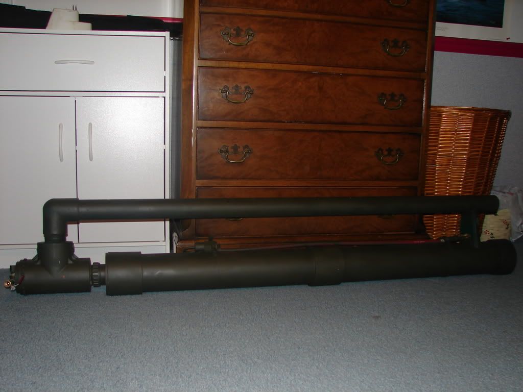

Well this is my cannon, I thought it was rather big until DR showed me up, oh well.
Its a single chamber of 4" pipe roughly about 72" long and has a 2" barrel that is also along that length. I have a supah valve and use a C02 reg to fill it. Thats all the nonsense that runs parallel to the chamber, my lack of proper fittings made me use this and that to connect everything so its kinda a bit big.

yea you would benifit from more barrel

Well I try to use it for paintball games so lugging around a 10 foot barrel may not be the best idea
. But if I were to double it, how much would that help performance ? I am assuming that it will cause a couple of people have already said to.

What psi do you take it up to?

Around a 100 psi, thats what the reg output is and I cant afford a another reg to get it down to around 50 psi. I know its prob not the most efficeint but its what I have to work with so I deal. During a paintball game I use a ball valve to try and get the pressure down to around ~50 psi.
Looking good... I saw that you considered building a Vogt Pattern barrel for it?
You will not need a much shorter barrel.. you already have a 4:1 ratio (which is above the 3:1 which was used on DR's vogt pattern tennis ball launcher)
What I would do is this: Get a separate barrel, 1.5" SCH 21 x 60". Sleeve it in 2" SCH 80. This is the main part of your barrel. Connect it to a 2" tee, and then add 12" of the sdr-21/SCH 80 barrel coming out the other side of the tee, ending in a 2" male adapter and 2" SCH 80 threaded cap.
