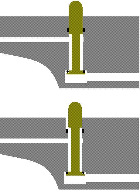

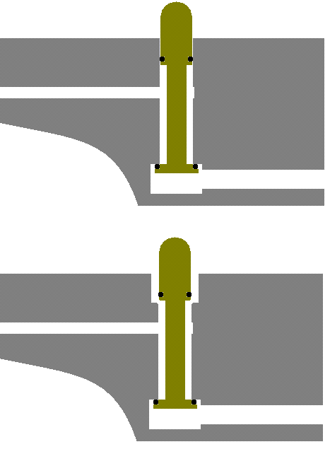

meanwhile before I get pics here's a diagram of a normal blowgun vs may modded semi blowgun
Heres what a normal blowgun looks like when in the natural position
heres what a mod semi blowgun looks like in the natural position
as you can see I extended the top of the piston by dilling a tiny hole and placing a small panel nail in it, second I gridded down the edges of the piston near the top so it could vent better it was pretty easy since this is made from soft metal, finally I cut the spring with pliers so it's shorter and works in this new position

My goal in modding the blowgun was to have a simple 3-way valve that anybody could make, so no fancy tools were used, just a drill and a dremel. The blowgun I first modded had the upper seal in the blowgun body and it sealed around the plunger, so I ground the plunger so that the small area extended just beyond the seal and ground out the body on one side to allow flow out.
On a blowgun like this one it would be even easier and give better flow, you could just drill out that top brass piece to right below where the o-ring seals in it's closed state.
Here are a few diagrams that hopefully help. It would be hooked up to the gun the same as yours, but operation would be the opposite, push to fill and release to fire. So your method provides a more intuitive trigger.

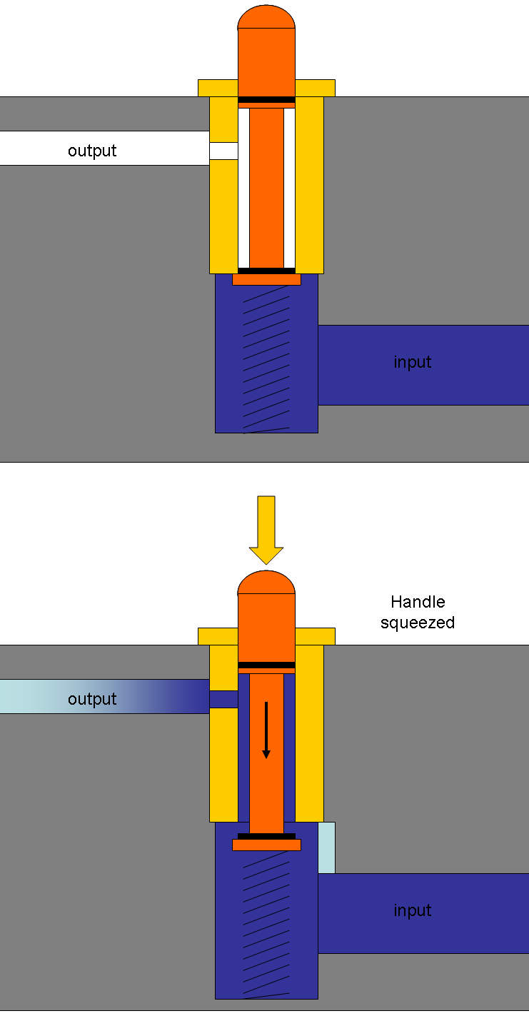

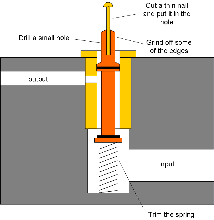

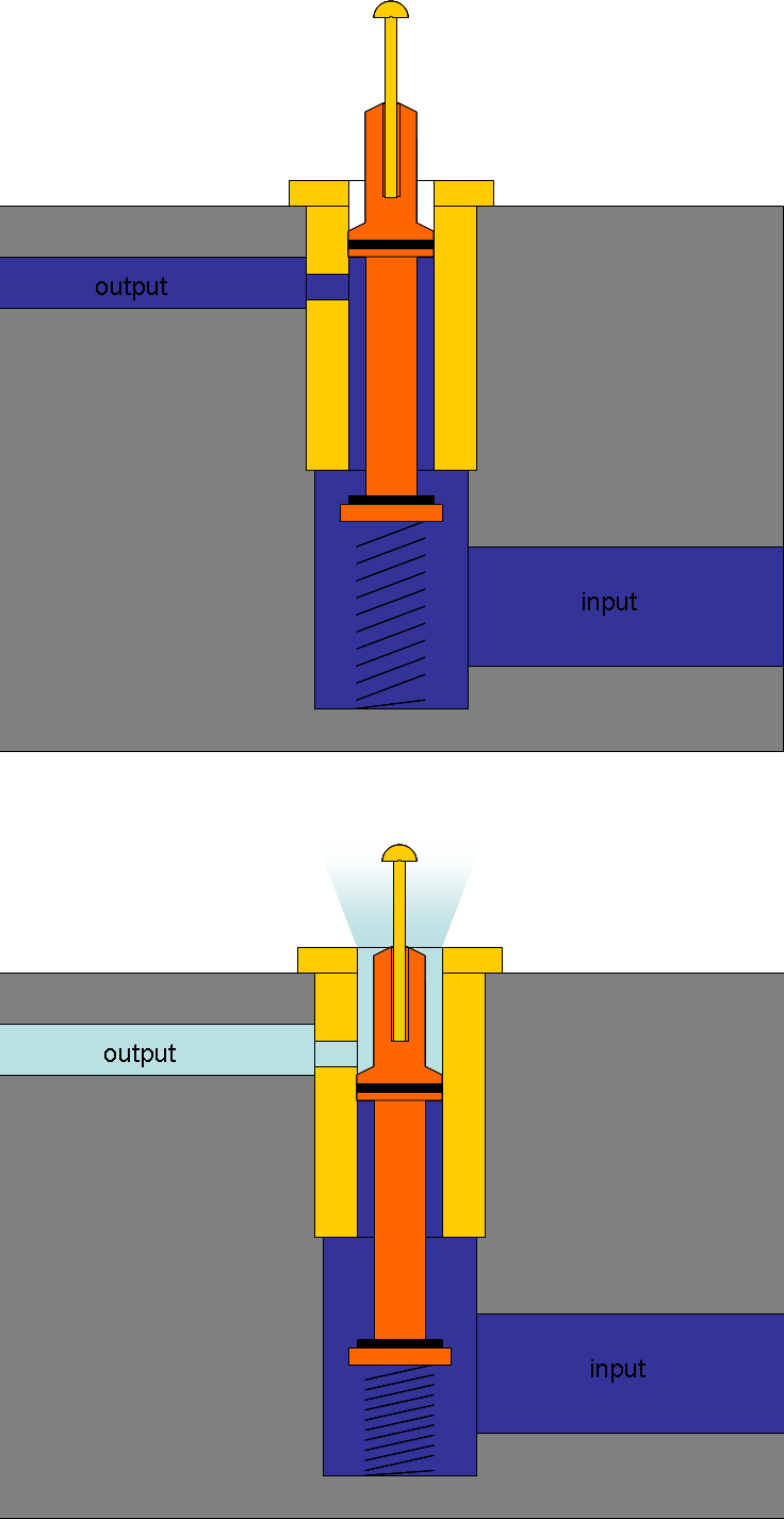

fair enough, here's some new cleaner diagrams, go by these diagrams
I want you guys to know that the the lesson in this mod is that any sliding rubber seal with a port mounted on the side of the shaft can be used as a unbalanced 3way pilot valve,
also does any one know how to get a link for a specific reply in a thread? in the future I want to link people to this specific post so they don't get confused by the other diagrams
and now for the diagrams pay attention to the comments
Modified Blowgun<br />this is a diagram showing how the modified 3way blowgun works.<br />Remember that this is a unbalanced valve so after you do this mod you must have a way to retain the button restricting it to these two positions
Modified Blowgun
3 way blowgun diagram.PNG (34.82 KiB) Viewed 10906 times
Modified Blowgun<br />This is a diagram of the modified 3way blow gun, the various changes you must make are labeled
Modified Blowgun
modifications to blowgun.PNG (21.75 KiB) Viewed 10906 times
Normal Blowgun<br />This is a diagram of how a regular unmodified blowgun operates. 2 position 2ways
Normal Blowgun
normal blowgun diagram.PNG (35.38 KiB) Viewed 10906 times

Thanks for that IKM3T, I've been thinking about this mod for a while. I might have to try this, as I just drew up a bolt action catridge reloading and ejecting mechanism. Just one thing though, why do you have to add the nail? Is it because you trim the spring and you have to make the button higher? Thanks.
