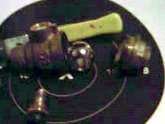

for a 2piece ball valve.
you'll need a torch and at least 2 pipe wrenches.
a bench or pipe vice and 1 pipe wrench makes it easier.
clamp it in your vice with the removable seat pointing up .
the stem/handle needs to be placed in the vice to keep the valve from spinning in the vice instead of clamping real hard on the valve.
heat the valve body area where the seat is blowing your flame up , not down toward the valve.
when it gets hot enough the seat breaks loose fairly easy.
after throwing it into a can of water turn your valve to off . the slot ontop of the ball should be lined up where the ball can be shaken out
take the handle nut , handle ,and packing nut off the stem and push the stem into the body and out of the valve.
there will be some kind of a seal for the stem and the 2nd ball seal left .
you should end up something that resembles this pic below

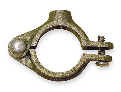

a couple of these split ring clamps might be a easer way to hook every thing together

cdheller, man i see your pic and cant help picture your face... only some require you to do that, some are as simple as 4 bolts and its apart, no heat, no mess, no need for a vice.

"cdheller, man i see your pic and cant help picture your face... only some require you to do that, some are as simple as 4 bolts and its apart, no heat, no mess, no need for a vice. "
I'm with you on both
except I'ld just strap or clamp the rig down and be done with it.
