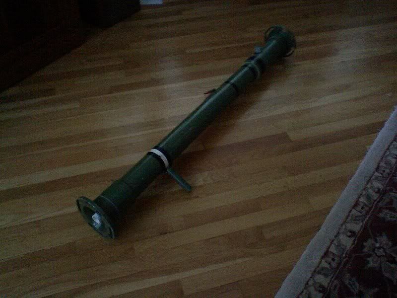

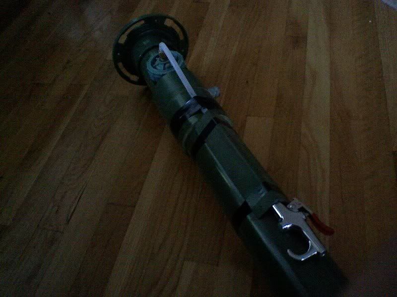

i happen to have just about finished a big Rocket launcher size coaxial cannon, im putting some finishing touches on it but its pretty much done (need to put on warning lables, and a few fire control boxes)
anyway its 3" in diameter with a 1" barrel, and a modified sprinkler valve as a pilot. its intended purpose its to launch pretty much airsoft shotgun blast for airsoft gamed but i have shot a few nail darts from it. ill put it in the pneumatic cannon showcase one i finishe every thing but ill give you a sneak peak... using a cell phone camera (cause i cant find the other one)

i would say it cost me about $70 to make its a rough estimate becuase i tend to buy a hell of a lot more stuff that i need, this cannon was made using some of the extra pieces, of course i already had all the pipe (currently i have all sizes of pipe up to 4" except 2.5") so i dont remember how much that cost so i just kinda guessed... and i would say mid level pneumatics cost more, but with a pneumatic you have a guarantee of it going off every time you pull the trigger, and theres not as much upkeep you have to worry about (change electrodes, clean the chamber, ect)
when you say "3/4 for paintball" do you mean 3/4 CPVC becuase thats definitely a bad idea, that stuff not meant to hold pressure. i say go with 1.5 with its current setup this thing has a c:b ratio of like 8:1 which is an insane amount of overkill 1.5 should balance it out a little more
