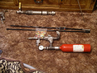

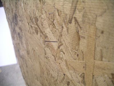

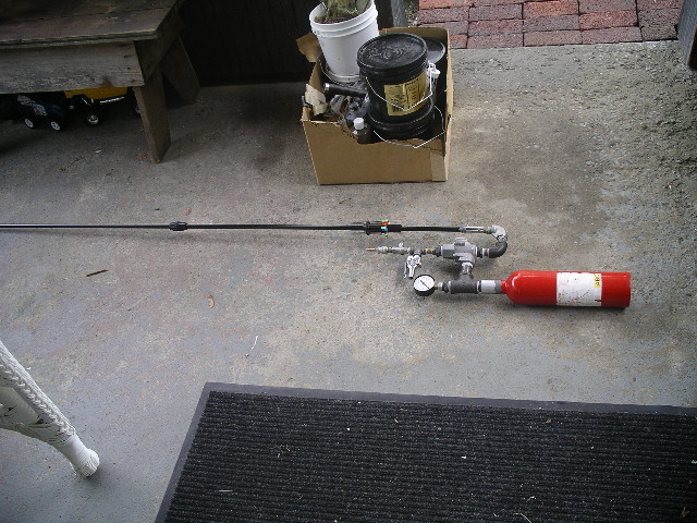

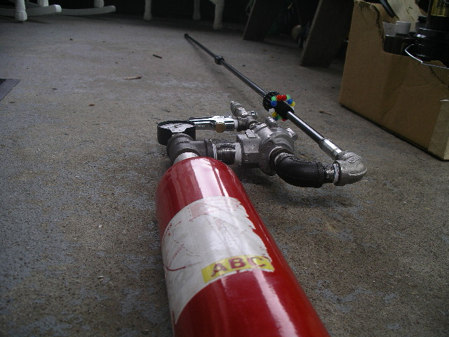

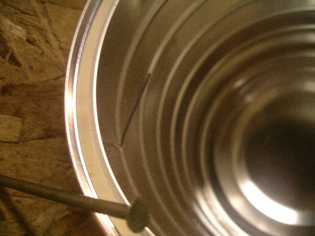

Hello everyone, i finally have finished my TDS-960 (terminator dart sniper-960). This is way more powerful than i expected it to be at 100 psi and only half of the barrel!! Right now i am limitted to basement shooting but this weekend i am going to my dads and i will make some pimp ass vids. I need some ideas on what to shoot. Ands yes i need stronger darts...after the go about halfway through a peice of wood it creates alot of kinetic energy and causes the darts to bend..
Specs-
1. 3/4 Detrol QEV (Valve)
2. 72" 2 peice terminator blowgun (barrel)
3. Modified high flow blowgun (pilot)
4. 3"x11" fire extinguisher (chamber)
i do not know the speed (fps) of the darts because i do not know how much they weigh...
as i said i am limmitted to my basement for now and i can only use half of my barrel...

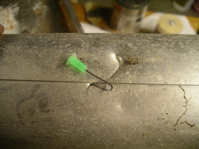

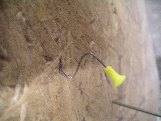

the yellow dart that went through
these darts act wierd...

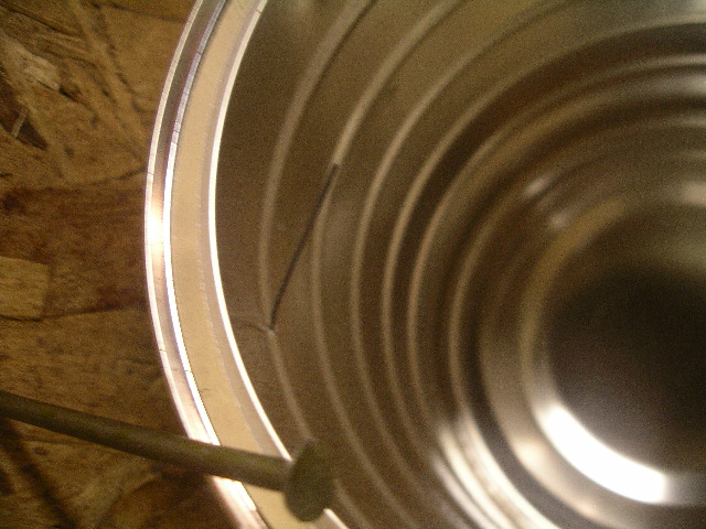

inside the coffee can

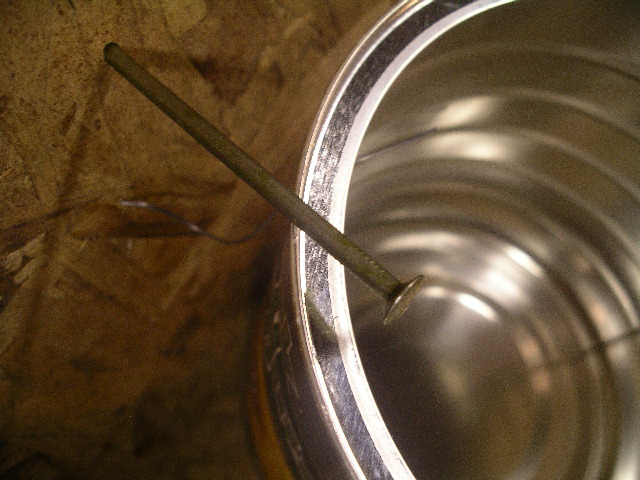

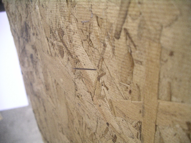

below the nail is part of a dart...it went through both sides of the coffee can and then into and peirced through particle board

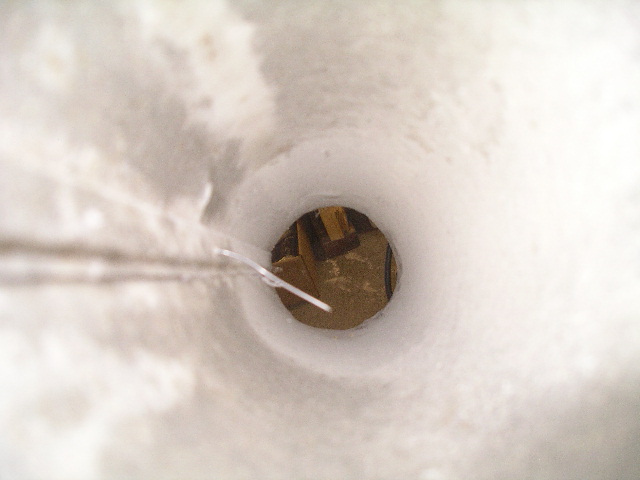

inside the aluminum the dart went through
dart into an aluminum thing..

gun with both barrels attached

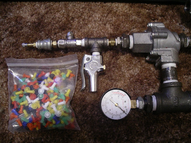

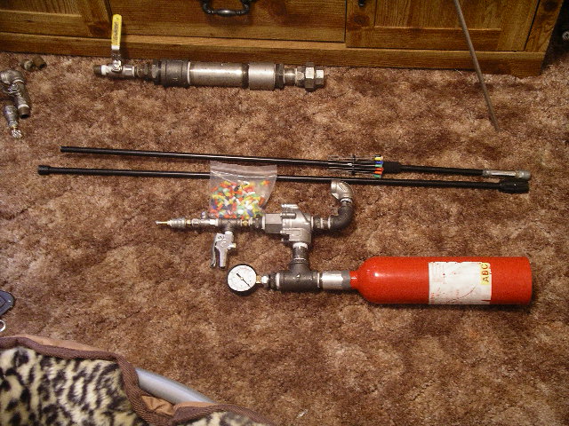

valve setup and a bag of dissasembled wire hunting darts
the gun without barrels attached

wow, very nice. you need some stronger darts.
Is that your hybrid chamber behind the gun?

yea before i put the tees on today

In that image 1063, is the dart what left that big dent there too? If so then that thing is crazy powerful. I wanna see you shoot a watermelon with it. Can you take the wire out of those darts and replace it with something else? if so you could use drywall nails or soemthing like that.

yes paaiyan it made that dent to.
yea i was thinking about that..or ill just make some home made darts from nails...

Oh yeah, got any theory as to why the darts to that bendy thing?
they are thin as hell

Well, the initial kinetic energy allows the dart to pierce through the material, whatever it may be, but after a certain point, there will no longer be enough kinetic energy for it to continue on its' path through the target. When it comes to that point, the kinetic enery of the back end tries to push the dart forward futilely, this causes the dart to bend.

If it's a .40 caliber blowgun (Mine is) then you can use thumbtacks. They don't provide a perfect seal, but you can probably modd them to better fit the barrel. I don't mod mine, and they still work in my blowgun with only a slightly shorter range.
